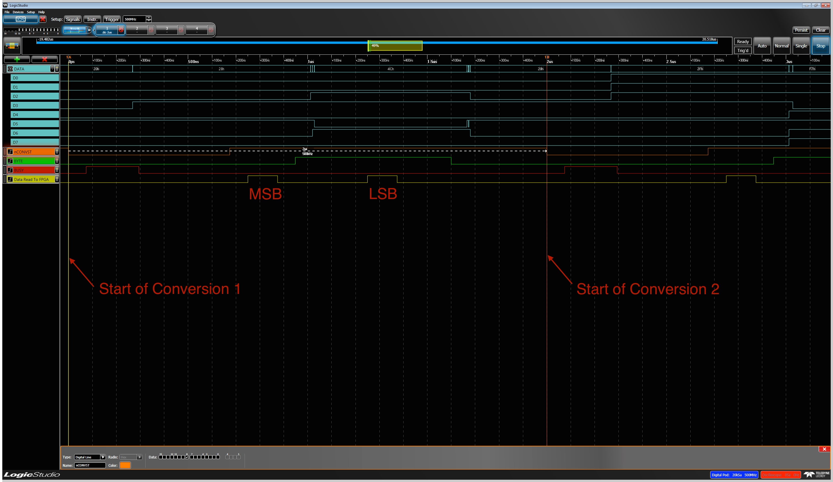

  • Ok, I figured out the reason for the longer than expected delay in the data ready from nRD and BYTE assertions.
    My ADC is connected to two ADUM1400CRWZ and a ADUM1401CRWZ digital isolator and those chips have a propagation delay of 32 ns. My logic analyser was hooked to the FPGA side of the isolator. Therefore when I assert nRD or BYTE, it takes 32 ns for the signal to reach the ADC, and another 32 ns for the data to come through. This adds a total of ~64 ns and when coupled with the 20 ns of the ADC, explains the ~70 ns observed. (This is the theory, although I haven't bothered to check the actual delay of the isolators vs the 32 ns stated in the data sheet)
    I have followed your advice and tied nRD to GND. I clock the nCONVST and follow the quiet zone guidelines when toggling BYTE. I have opted to ignore BUSY as my target conversion rate is <500kSps and I can afford to wait long enough and assume BUSY is low.
    This way, I only need 10 signals for the interface (8xData, nCONVST, BYTE). I have attached the latest screenshot of the logic analyser. I have added a signal called "Data Read To FPGA" just to see when I do the actual reads. Of course using this method, it's possible to run it faster than the 500kSps I have tried. (It will be limited by the propagation delay)
    Thanks for the advice!
