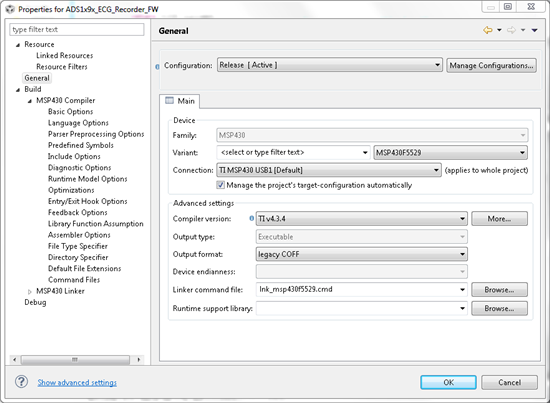

    2. Projects -> Import CCS Project -> Browse to ADS1x9x_ECG_Recorder_FW

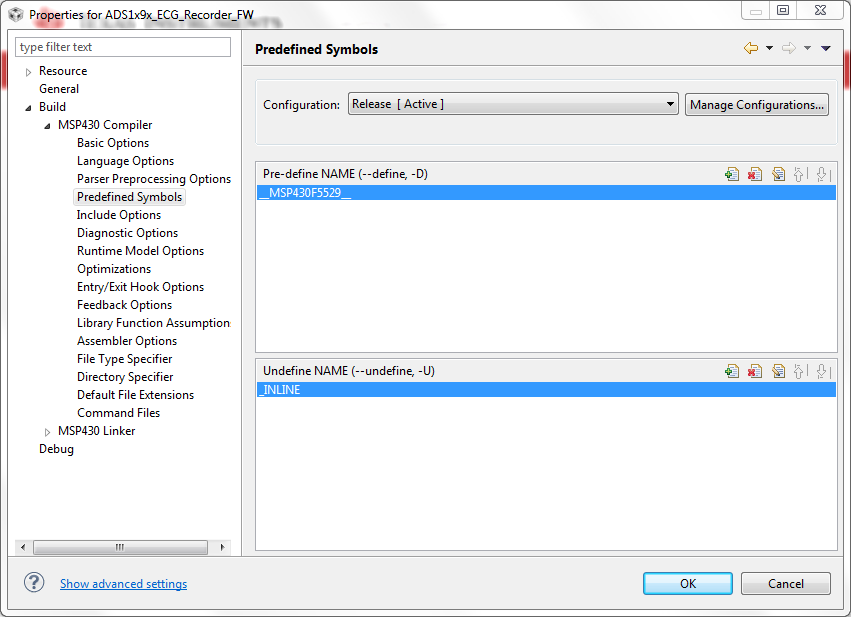

    3. Right Click on Project, open Properties. Go to Build -> MSP430 Compiler -> Predefined Symbols. Delete "_MSP430F5529" (only "_MSP430F5529_" should remain.)
     Rebuild Project. 1 Error should remain.
