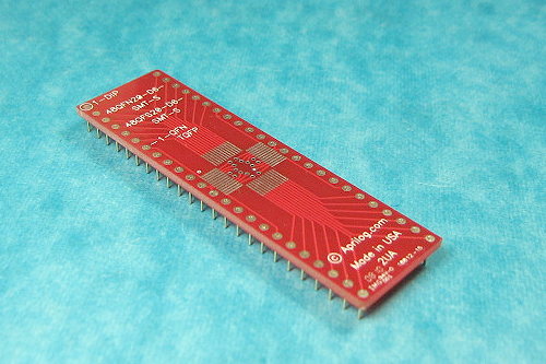

I am looking for QFN Socket adapter for prototyping ADS1258. Could you offer me a good one that can I use to connect jumper wires?
Thank you in advance and any suggestion welcome,
  • Hi Daniel,
    Are you looking for a protoboard? (Here is a link to a socket, but I don't think that is what you need).
    There is the ADS1258EVM that has headers to connect to most of the ADS1258 pins. Other than the EVM, I don't know of any other resources offered by TI.
    You could search for boards like this one: http://www.aprilog.com/images/48QFN20-D6-SMT-S.jpg
    The ADS1258 is a 48-pin QFN with 0.5mm pitch. Here is the mechanical data: http://www-s.ti.com/sc/psheets/mpqf140c/mpqf140c.pdf
    Chris
