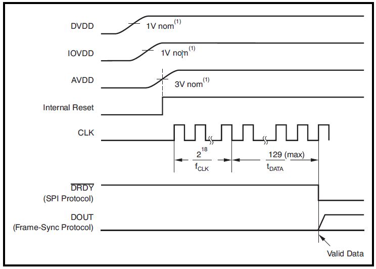

Greetings!  I am working on a project utilizing the ADS1178 and am testing the chip at a component level right now.  I am having a bit of an issue generating a response from the chip at all.  I have attached the chip to a 64 pin breakout board and am attempting to interface it with the following parameters
Clock divider =  0
Format = 001  (SPI TDM fixed)
Mode = 1 (Low Power)
Clock = 5.32 MHz
SClock = 665 KHz (1/8 ratio to meet timing standards as per datasheet)
My hardware configuration is based on the example schematic from the datasheet, save for the difference in format and timing. I have a single ended accelerometer (ADXL326) attached to the input of channel 1, but that is of no consequence because as of right now the chip does not generate a _DRDY pulse, nor does it respond to the SPI SCLK (I have mointored both with an O-scope and have seen no response regardless of duration of the SYNC pulse or SPI prompt). My initial thought is that maybe the core is not getting enough power (the DVDD pin). I am interfacing with an mbed uController (LPC1768) during the prototype stage if that is of any significance?

    What supply voltages are used for AVDD, DVDD, and IOVDD and are they brought up in the correct sequence? If so, /DRDY should drop from high to low after 218 master clock periods + 129 data rate periods.
    So in your case:
    CLK = 5.32 MHz CLK
    Low-Power Mode, CLKDIV = 0 -> Data Rate = 5.32 MHz / 256 = 20.78 kHz
    /DRDY will fall after (218 / 5.32 MHz) + (129 / 20.78 kHz)
    Ensure that that /SYNC is also held high in order for the modulator to begin converting. If /SYNC is held low, /DRDY will remain high.

    Good catch on the "fCLK / 256." That ratio is only valid for the ADS1278. In ADS1178 Low-Power Mode (CLKDIV = 0), fCLK / fDATA = 512.
    With that, (218 / 5.32 MHz) + (129 / 10.391 kHz) = 61.69 ms, which is the expected time it should take from /SYNC high to /DRDY falling low.
    Once the device is up and running, you can pulse the /SYNC pin low to stop conversions and reset the digital filter. When /SYNC is brought low, /DRDY will be held high. Upon bringing /SYNC high again, you will only have to wait 129 conversions (129 / 10.391 kHz = 12.4 ms) before data is valid again, indicated by /DRDY falling back low.
