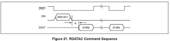

  • Hi
    Chris,
    Thank you for your help. I am using the adc with 30k sampling rate and now getting the correct reading for continuous mode .
    But the reading are coming after some garbage readings now the questions is how to sort the correct readings out of the combination of garbage and  correct readings.
    As the frequency of the correct reading is not fix and trying with different delays so that I can get correct readings with fix garbage readings . Also I tried to change the data rate and tried lower data rate but no success.
    I think my delay are not proper. I have created one delay function with the help of timer and it generates 1 micro-sec delay. τ CLKIN =1/(8MHZ)
    The sequence for continuous reading is as follows.
    while(DRDY);       // Wait for DRDY to be low
    WriteSpi(0x03);    // ADC Continuous read command
    Timer_Delay(300); // t6 delay from the data sheet (50 x 6 usec = 300 usec)
    while(DRDY);
    ch1=WriteSpi(0x00); // ADC Output MSB
    Timer_Delay(24);
    while(DRDY);
    ch2=WriteSpi(0x00); // ADC Output MID
    Timer_Delay(24);
    while(DRDY);
    ch3=WriteSpi(0x00); // ADC Output LSB
    Timer_Delay(24);
    Please help regarding the delay.
    Thank you in advance.
  • Hi Rohit,
    You shouldn't need the additional delay time between commands. I've commented them out below:
    while(DRDY);
    //Timer_Delay(24);
    while(DRDY);
    //Timer_Delay(24);
    while(DRDY);
    //Timer_Delay(24);
    Are you able to capture an oscilloscope or logic analyzer screenshot of the SPI communication?
