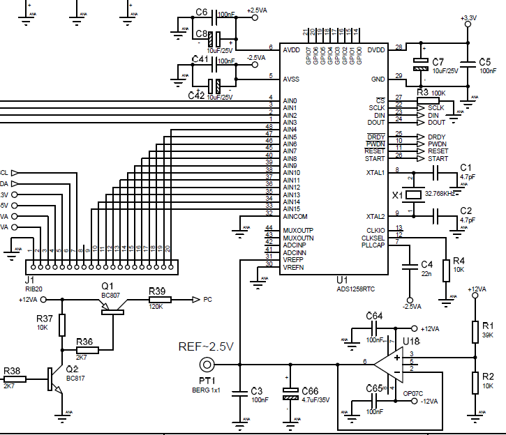

Hello!
I am using the ADS1258 single end channel. The channel 1 shows me the values bellow:
32700
32701
32700
32830
32700
32701
32303
Note: I put the channel 0 direct with ground signal.
Could you send me a code example?  I am using port I/O from a PIC32 microcontroller. I choose the scan option, but for test I am using just channel 0.
My code is:

  • Hi Mr. Galbas,
    Thanks for sharing the schematic!
    I have two observations I want to point out:
    1. The crystal oscillator is referenced to AGND, it should be referenced to AVSS. Presently, this doesn't seem to be causing a problem if you're able to communicate with the ADS1258.
    2. I see any input buffers; therefore, if your input signal has high output impedance you might see gain errors or other noise present on the input signal. What is the input source on AIN0?
    After configuring the ADS1258 registers, are you able to read the back to verify that they are configured properly? Please tell me the register settings you're using.
    Chris

  • Hi Mr. Gulbas,
    Here are the possible causes I'm currently concerned about:
    • You're original data is around code "32700" or ~10mV. This is rather high for a shorted input. Hence, I wasn't sure if you were actually measuring AIN0. If you are measuring 10mV with AIN0 shorted to ground, then your ground is very noisy! Do you know where this 10mV signal is coming from?
    • The reference voltage is implemented with a resistor divider. With this configuration, any supply ripple or noise will also be present on the reference voltage!! This could easily cause the 400 code spike or ~127uVpp. The bulk decoupling capacitors on the output will not provide much noise filtering, and could be making the reference buffer unstable. Have you probed your reference voltage to check that it is clean and stable?
      (With a 0V input you won't see much of the reference noise effect; however, when you apply a larger signal you may find larger spikes. A good reference voltage is critical for good performance with a 24-bit delta sigma ADC!)
    • I'd still question the SPI communication...If you are able to read back the values you're writing to the device registers, than that is a good sign. I would still want to probe the SPI signals to see if the communication is clean. One question regarding your code, what value are you writing to MUXSG1 when you send "(canal>>16)"?
    Chris
