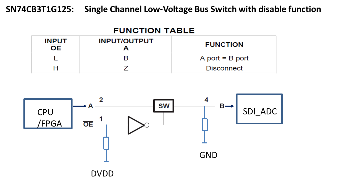

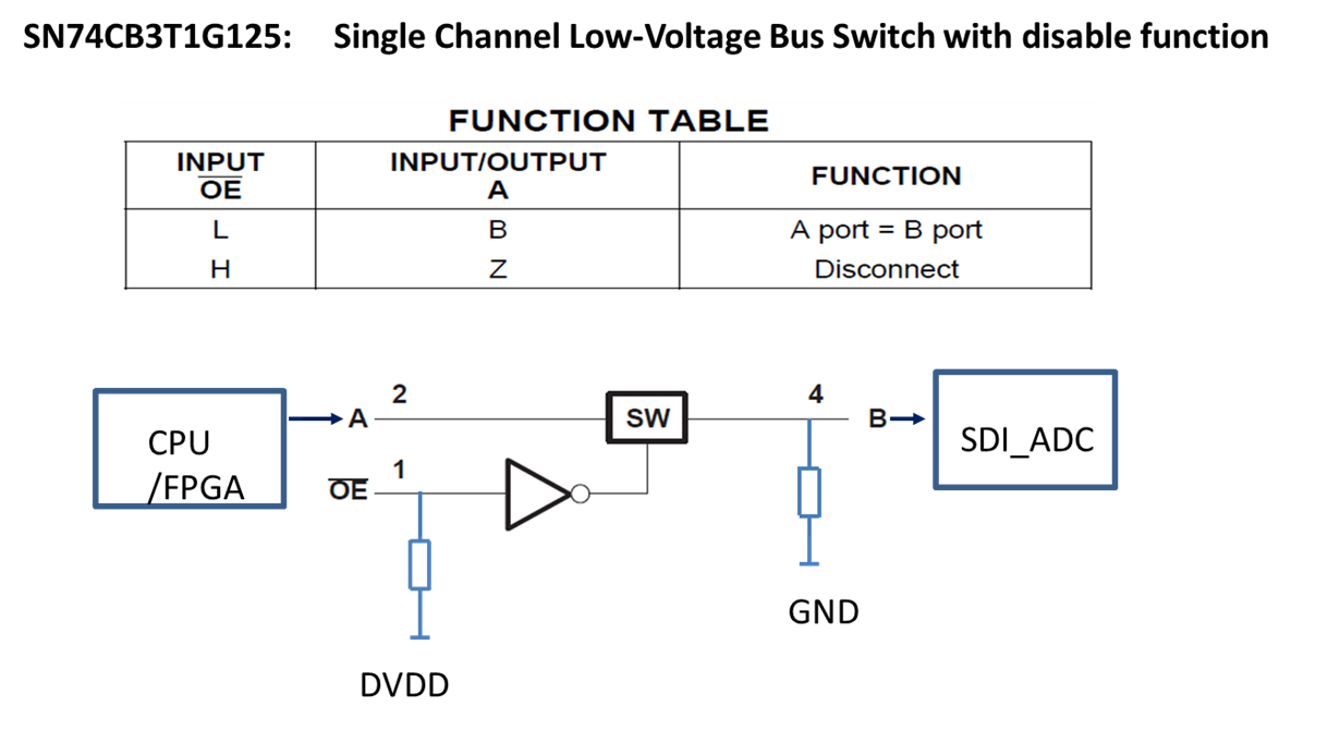

  • Hi Malik,
    ADS8688 doesn't have a command to disable the software reset command(8500h). There are two solutions which could be used:
    1.  Make your circuit and system robust by improving pcb layout or other ways on system level, No interference signal coupled into SDI.
    2.  Suggest to use Auto sequencing mode to select the channels you expect, after configuring ADC,  the SDI signal can be switched out and disabled, for example, SN74CB3T1G125 which is a Single Channel Low-Voltage Bus Switch with disable function can be used to achieve this function shown in the blockdiagram as below.
    When want to change ADC's configuration, the SDI can be enabled again by enabling SN74CB3T1G125. The pull-down resistor on SDI can make sure the command data is 0x0 gotten by ADC (Continue operation in previous mode) after disable SDI.
    By the way, ADS8688's reference voltage is 4.096V, not 2.5V. Thanks.
    Thanks.
    Dale
