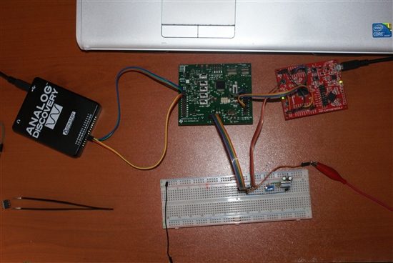

I connect the pins on ADS1278EVM and MSP430F5529LP by cables as in Figure (1)
I am using MSP430F5529 integrated USB module to send data to computer and read data using MATLAB.
                                                                                  Figure (1)

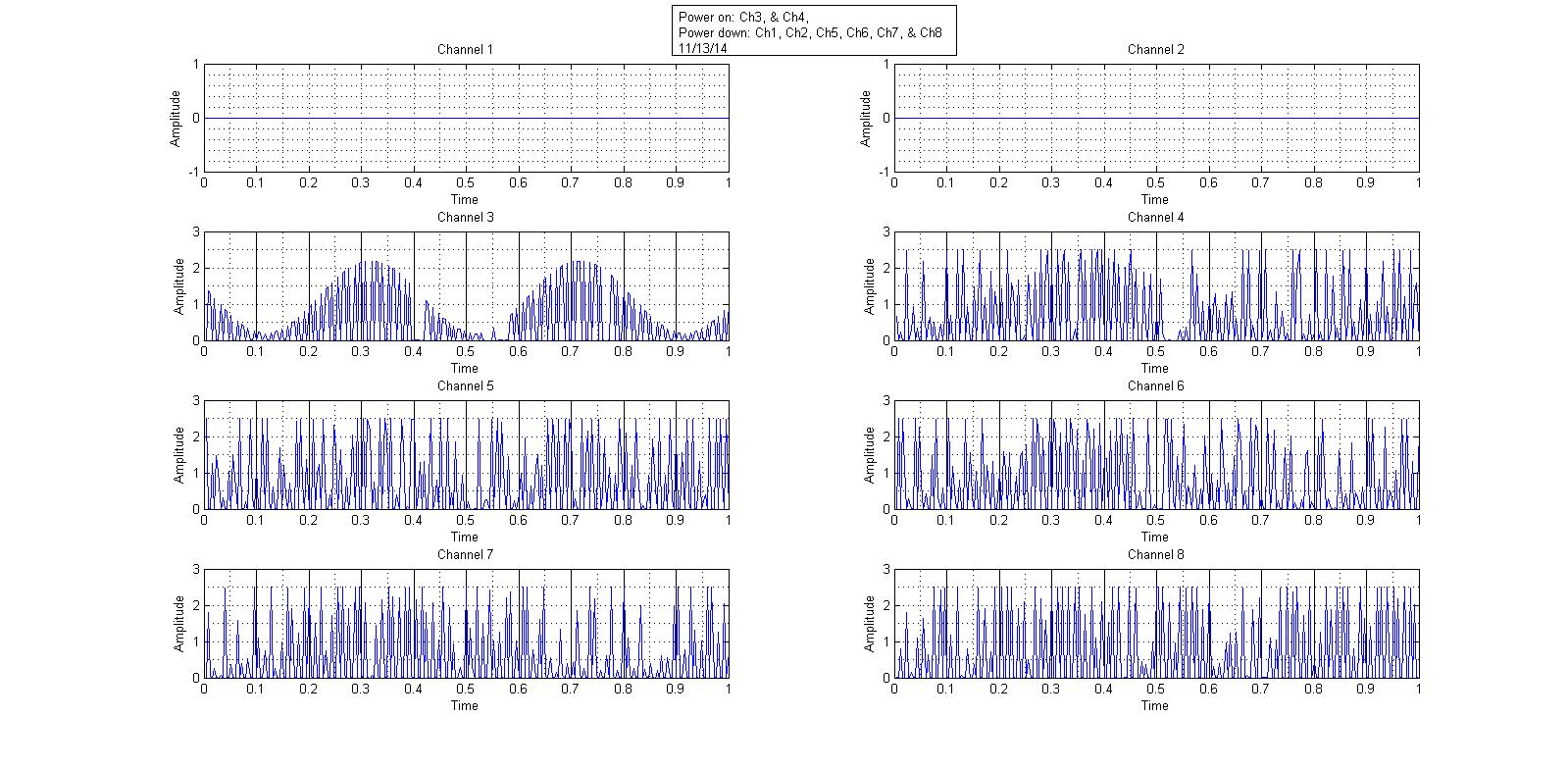

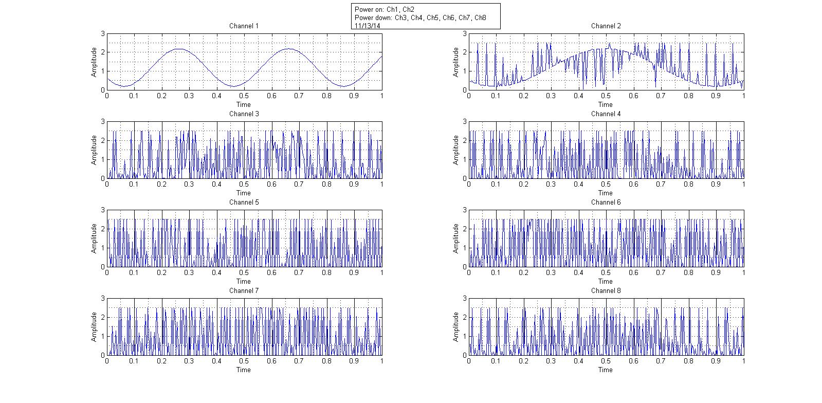

1.  I try to read data from multiple channels . I apply 1V sin waves  to channel 1 and channel 2 powering down all the other channels  by S1. I receive the wrong output as in Figure (2). I expect channels 3 to 8 to be zero but they are not. In addition channel 2 is very noisy that I cannot apply signals with smaller amplitude.
                                                                                                                   Figure (2)
Then I apply the same signals to channels 3 and 4 powering down the remaining by S1 (Figure 3). This time channels 1 and 2 are ok giving right output (zero) but channels 5 to 8 behave the same way. In addition data from channels 3 and 4 are very noisy that in channel 3 I can only see envelope of the input signal and in channel 4 it is barely recognizable.

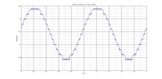

2. My second problem is with small amplitudes and lower frequencies. I need this device to detect signal about 1mVp-p and frequency of 1Hz. As I decrease amplitude and frequency I come up with the problem in Figure (4) and Figure (5). Inputs are 100mV, 1Hz and 10mV, 1Hz respectively.

    • Figure 1 shows that you are attaching the inputs from the signal generator to Channels 3 and 4, not 1 and 2.
    • Also, since the ADS1278 in an unbuffered ADC, you really should take advantage of the on-board THS4521 differential amplifiers. They will help drive the input cap and set the input common-mode to mid-supply.
    What settings are you using for Mode [1:0], CLKDIV, and FORMAT [2:0]? Can you send us a capture from a logic analyzer so that we can verify your SPI timings?

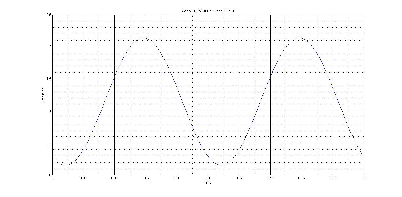

  • Hi Ryan,
    Thanks for your fast reply. I have tested several channels by applying inputs. On figure above, you are right I share the figure in which I tested channel 3, and 4. But I am using just channel 1 to get the correct response.  As you suggested, in the my new results I am using on-board THS4521 by S8 and removing JP3 (PD_Buffer). Unfortunately I didn't have access to logic analyzer now, and I use oscilloscope to track the signals. In the following are the figures shows 1mV, 10mV, and 1V, input signal with frequencies between 1Hz, and 10Hz. The point is that as the amplitude and frequency of signals grows I have less and less problem.
    ADS1278EVM configuration: MODE: 01 (High Resolution), CLKDIV =1, FORMAT: 001 (Fixed-TDM), adjusted by S2 on ADS1278EVM,
    Except channel 1 remaining channels are powered down by S1 on ADS1278EVM.
    I feed CLK=SCLK=4MHz from MSP430F5529LP and MSP430F5529 works with MCLK = 8MHZ.
    Figure 1: There is no problem
    1V, 10Hz, 1ksps,

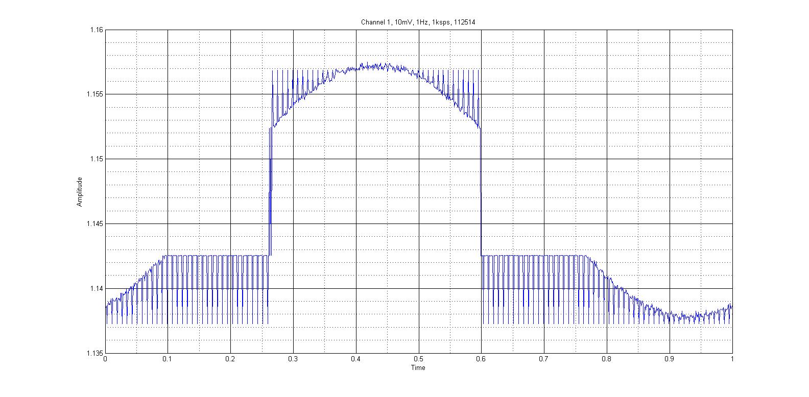

    Figure 2: There is a problem. The steps all have amplitude of 10mV, and are not random.
    100mV, 1Hz, 1ksps,
    Figure 3: Exactly 10mV spike, again not random.
    10mV, 1Hz, 1ksps
    Figure 4: The problem is disappeared.
    1mV, 1Hz, 1ksps

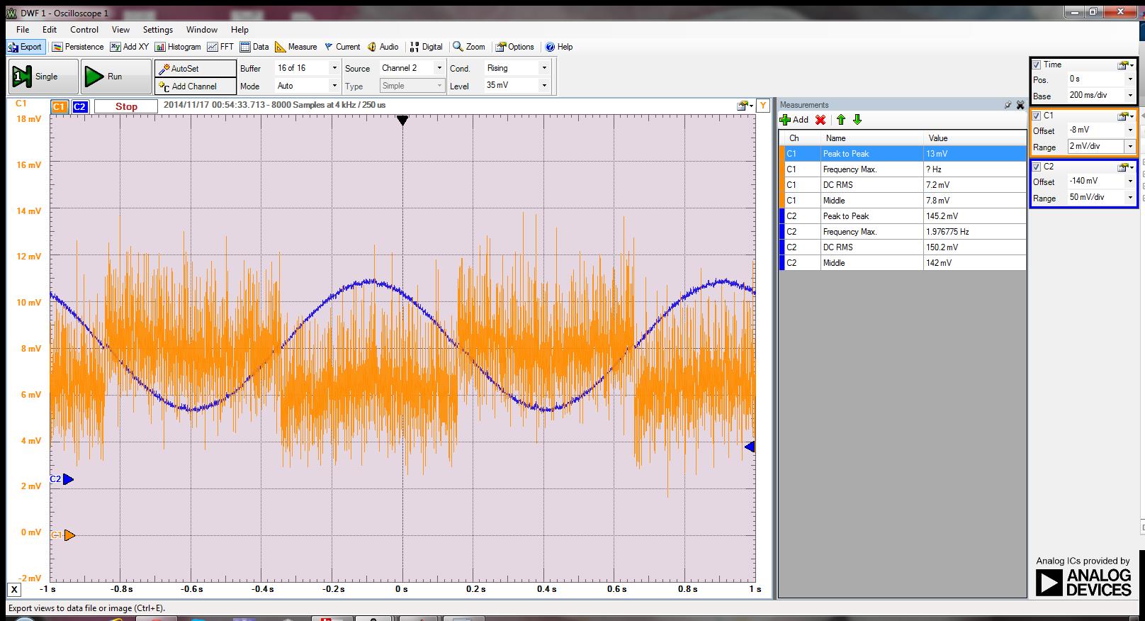

    I try to find logic analyzer and send you the SPI analysis. As you see the spikes are 10mV and not random. In the figure below I send you the capture of input to AINP1 (blue), and AINN1 (orange),  AINN1 is connected to ground. As you see I get the projection of the AINP1 on the AINN1. May it be a problem since AGND and DGND are connected together? By the way I measured AINN1 (is grounded) with respect to power supply ground.
    And one question? As I understand SCLK in ADS1278 is a clock data output rate, and CLK is for modulator. Is it right?
    And finally is it possible because of fail in ADS1278EVM? (I have just one)
    If you can give me an e-mail,  I can share my codes with you.
    Reza

    And I looked at my input signal to the ADS1278EVM in details in oscilloscope. The figure below shows that it has step like shape which may cause the problem I am facing but I am not sure.
    I should modify my code to read the data with respect to SCLK because certainly I am losing some bits.
