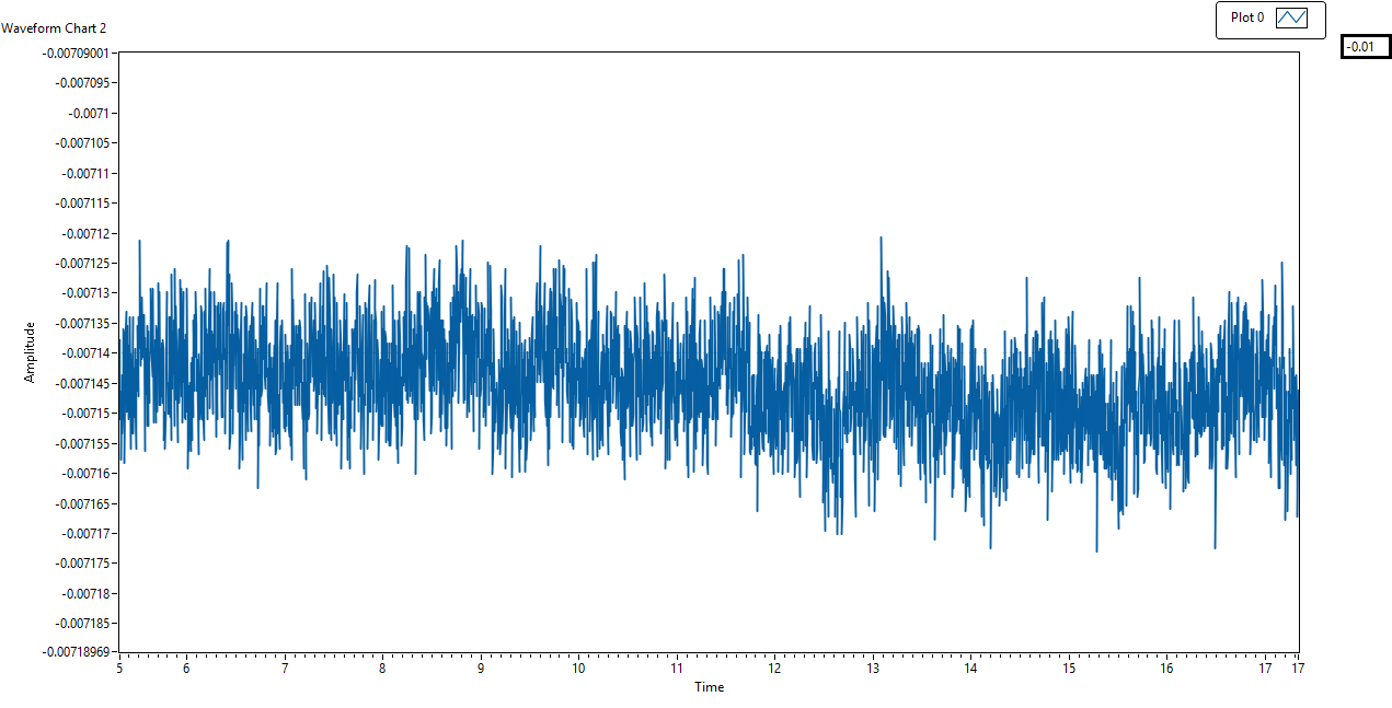

I design my board for ADS1294. wen I want to use first time , I want to check it;s input reffered noise and test signal and normal input. this are my Data that sent to ADS1294 :
CONFIG1 : 0x05     // Fmod : 500 SPS  ,   Low power mode
CONFIG2 : 0x10     //  Internal test signal enable  with default amplitude and frequency
CONFIG3 : 0xE0        // Enable internal reference voltage with : Vref = 4 volt (AVDD = 2.5 , AVSS = -2-5) ;
I configure Channel 1 with  0x61    // Gain = 12 ; Input shorted .
below is my signal in PC :
1. as you can see in the graph, RTI noise is approximately 30uV P-P , but in datasheet it is about 3.2 uV P-P. in your opinion this difference come from where ? if we raise the PGA gain RTI noise (or other noise that are same) must be decrease but in this case it doesn't work !!

    1. The first data plot does not appear to be input-referred. I estimated the peak-peak noise to be about 38uV from this graph. 38uV / 12 = 3.167uVpp. Make sure that you are dividing the result by the PGA gain in your calculation.
    2. For Gain = 1, the peak-peak noise should be closer to 17uVpp. I believe the data in the Noise Measurement tables is +/- 1-sigma of the noise distribution recorded for each setting. How are you measuring the peak-peak noise? Are you taking the global max/min? Excluding some of the obvious outliers, the peak-peak noise looks closer to ~20uVpp.

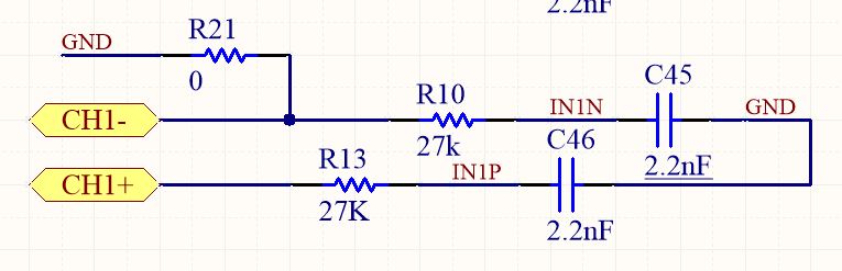

    4. Do you have lead-off enabled on Channel 1? The internal pull-up resistors or lead-off current sources may be charging/discharging your input RC filter when no inputs are connected. Also, the capacitors C45 and C46 must be placed following the resistors in the input signal path to get the RC filter response.

    3. I test it and say VREFP voltage to you. but I am sure that VREFN is connected to AVSS = -2.5 ; in below you can see schematic of that part with 10uF tantalum capacitor polarity.

    The noise that you measure with an internal input short is the noise contributed by the internal circuit components in the ADS1294 itself (PGA, ADC, etc.). Once the channels are operating in the Normal Input configuration, external noise from other on-board components and the environment will introduce additional noise in your results.
    To test the offset of each channel, you should take a measurement with the inputs shorted. The differential offset will be the average value of the output. For example, Figure 17 of the User's Guide shows the different offsets seen from all 8 channels with the inputs shorted. The results you observed on Channel 1 will change once you drive a signal into that channel and the inputs are no longer floating.

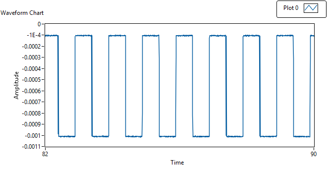

    and after that I programmed it to Test input (with default values) and G=1, here is the plot :
    1. in both plot DC offset on channel is very low and we can say it is approximately 0 , but this channel on the my first post DC offset for this channel is about -0.7 volt in normal mode. where come this issue ?
    2. why test signal amplitude still is wrong value with regard to data sheet ? some times amplitude of test signal (with default register value and G=1) is big as 0.25 v, and it is strange for me !
    Can you try to use the 2.4V reference and see if the Test Signal amplitude changes to the correct value?
