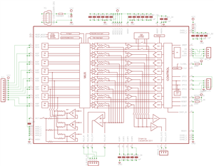

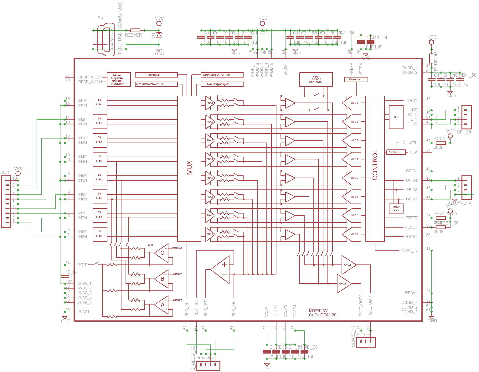

    Schematics:

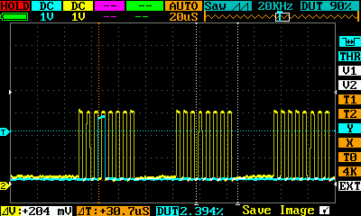

    Screenshot with SPI clk and dout at  RDATAC.
    Status Word: First 2 bits are ON, next bits are OFF.
