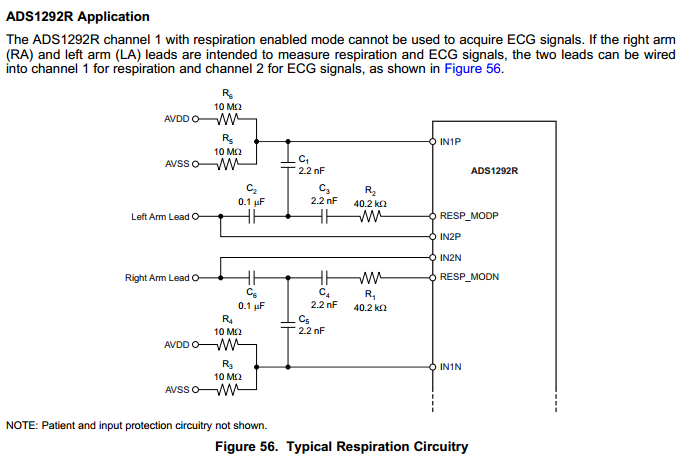

I have a setup according to the figure below. I have no problem deriving the voltage level from both channel i.e. ECG and respiration. But how can I derive the impedance from the voltage level from respiration?

/source to figure: www.ti.com/.../sbas502b.pdf
