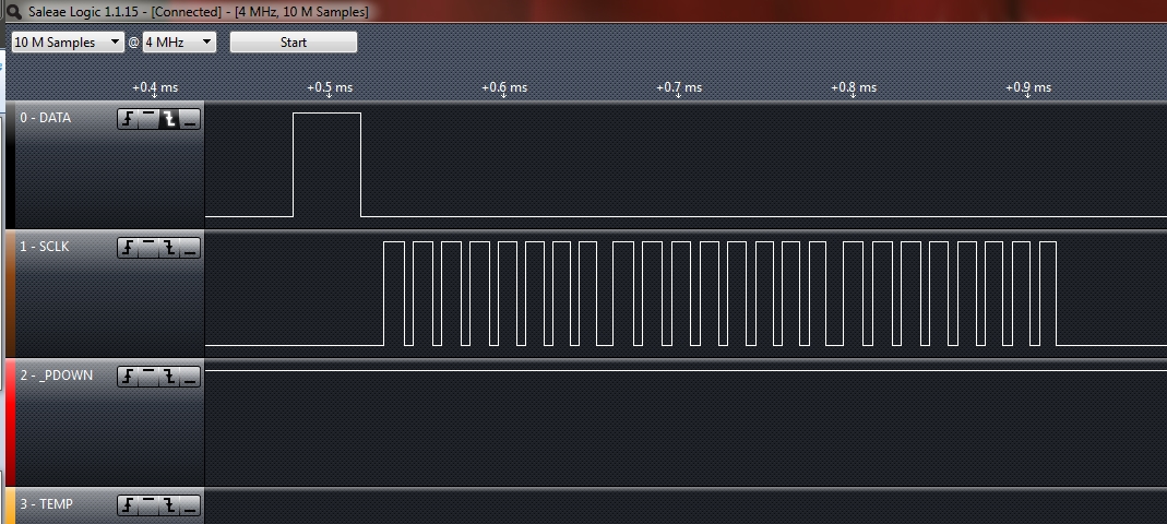

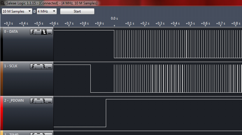

Here's a screenshots from my logic analyzer when the system is powered up
On every _DRDY/DOUT falling edge, I'm sending 24 SCLK pulses (tried 25 & 26...  didn't change anything).  No data is clocked out

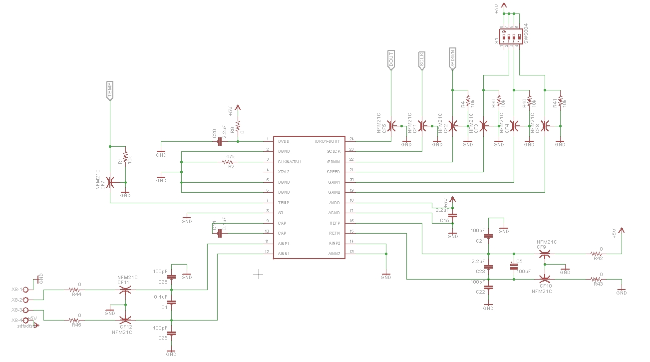

Here's the schematic

    Welcome to the forum! This seems very unusual.  Can you give me the voltages on the pins for each control pin of the ADS1232?  What exact value are you using for the EMI filters, especially on the SPI lines DOUT/DRDY and SCLK?
    It almost appears as if the ADS1232 is not seeing SCLK at all.  Are you probing near the micro?  If so, try probing at the ADS1232 SCLK pin to make sure that the device is seeing SCLK.  Make sure that you have good solder connections and that the EMI filter cap is not causing an issue.

    Voltages:
    A0: 0V
    TEMP: 0V (or 4.96V Software selectable)
    GAIN0, GAIN1: 0V (or 4.96V dip-sw selectable)
    SPEED 0V (or 4.96V dip-sw selectable)
    I'm using 100pF filters for all digital signals. (Schematic is mostly based on ref design)

    One other thing that would be good to check is you should see DOUT go high if you send 25 clocks.  This would show if the ADS1232 is responding to SCLKs.

    I tried 25 & 26 pulses on SCLK without any change...

    If you do not see DOUT/DRDY go high on the 25th clock, or an extended delay before the next DRDY after the 26th clock, then the ADS1232 is not seeing the SCLKs.  Can you get the scope probe directly on the SCLK pin of the ADS1232 and capture a shot of the scope so I can see what it looks like?  You will get an edge delay from the EMI filter.  The probe will add some additional capacitance, but is should be much less than the EMI filter cap.

    Thank you very much for your help

    So we are still left with the question as to why no data is output (or always stays low).  First let's start with what we do know.  We know that the device is getting power.  We also know that the device is functioning based on the DRDY pulses.  This means that the internal oscillator and digital is functioning.  What we don't see is any response due to SCLK.  It appears that the device does not see SCLK at all.
    A couple of possibilities exist.  One is the SCLK has a bad connection relative to the pin of the ADS1232.  This can happen from a cold solder joint, and sometimes by applying a little flux and reflowing the joint you will correct the problem.  Another possibility is the device was damaged either by an electrical overstress event (EOS) from handling or in soldering.
    If you have placed your probe on the pin of the package for the ADS1232 and you see the SCLKs, then I would try replacing the part.  Make sure that you adhere to the ESD information at the top of page 2 of the datasheet.
