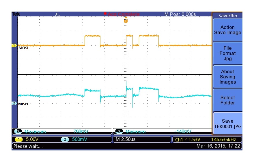

    In order to help you debug this issue, it would be best if you could provide a complete schematic of the design as well as oscilloscope captures of the write sequence on the SPI bus so I can check various timing parameters.
  • Hi Kevin,
    I'm so glad to get your reply, Here am attached my schematic ans oscilloscope captures and am sending fisrt 8-bits address 0x01(Write DAC Data register),then send my data that is 0xA5A5 . please help me kevin.

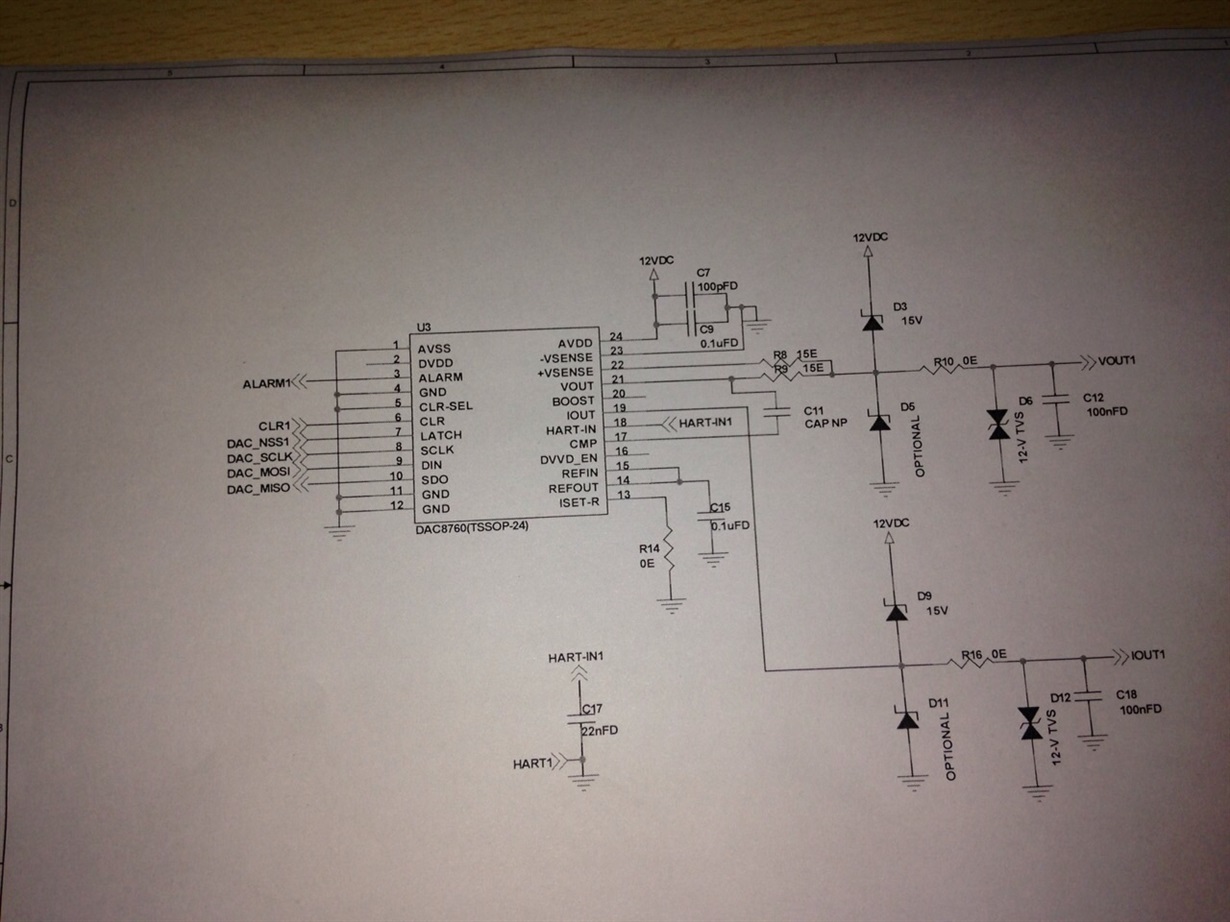

  • Poch,
    In your schematic DVDD-EN is connected to GND, which means the internal DVDD LDO is disabled. There is no external supply connected to the DVDD pin, so it looks like you are not providing a digital supply to the device. Without the digital core powered, you will not be able to communicate to the device.
  • kevin,
    after your provided information i added 5v power supply to DVDD then also am not getting proper output and one more thing while am sending data to MOSI line through SPIDAT register it not reading my data after 8 cycles it's getting 0xFF. so please help me how to do all thease things to get proper output signals. now am getting thease signals Hear am passing first 0x01 address,0xA5A5 as data. if possible provide sample program also.
  • Poch,
    Did you add this 5V supply to the same unit / board that you performed the previous tests on? With the 5V supply provided now, your schematic looks fine and there is no reason for the MISO data to look as erratic it does. To me, this suggests that the unit that you're testing was damaged from the digital signals being applied to the device without a digital supply in the previous tests.
    In your initial post, you indicated that a 7.02V potential is being developed across a 250 ohm load on your current output. This means 28.08mA is flowing through the current output - which also suggests that the unit under test has been damaged, since this is not a valid output for the DAC8760.
    If you haven't already, try the tests on a fresh unit/board with the 5V digital supply provided.

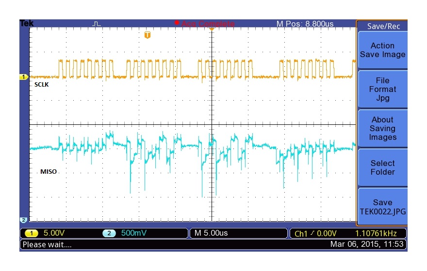

  • Kevin,
    Today i taken new board of DAC7760 that schematic is attached below and also attached Oscilloscope captures. for any input signal(MOSI) output current is not getting it is always showing 0v so please help me.
  • Poch,
    The MISO line still looks incorrect - it appears to me that the ground you have the oscilloscope is the ground of the MCU or SPI signal source but that ground is not connected to the DAC8760 ground so the waveform is floating. How are the SPI signals introduced to the board? Is there an adequate ground connection between the SPI host and DAC8760? Where is the ground clip of the scope applied?

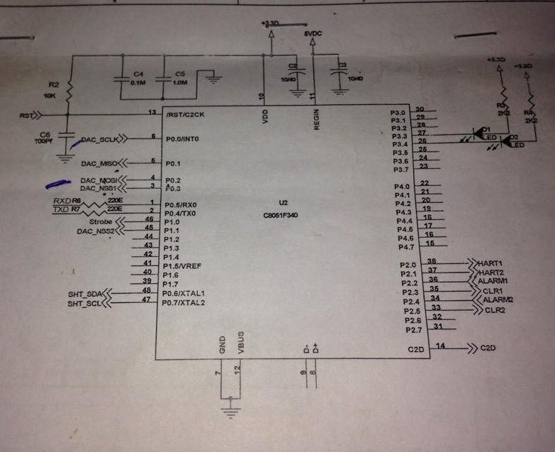

  • Kevin,
    in my above post DAC7760's pin no-11,12,4,5 ,23 ground is connected to the MCU's pin no 7,12 ground.and i used to connect ground clip of the scope when observing wave forms.
  • Poch,
    Could there be an issue with the layout? The MISO oscilloscope captures strongly suggest that something is floating.

  • Kevin,
    if am disconnecting MISO line Between MCU and DAC7760 am getting below wave forms Here MISO line varying from -120mv to 800mv
    After connecting MISO line Between MCU and DAC7760 i got thease wave forms,here MISO line varying 2.60v to 3.84v
    please provided me the solution in this case
  • Poch,
    This continues to add to my suspicion of the integrity of the GND connection. Using a DMM, can you measure the voltage difference between the GND measured local to the MCU versus the GND measured local to the DAC8760? Simply attach the GND lead to the GND near the DAC and the positive probe to the GND near the MCU.
