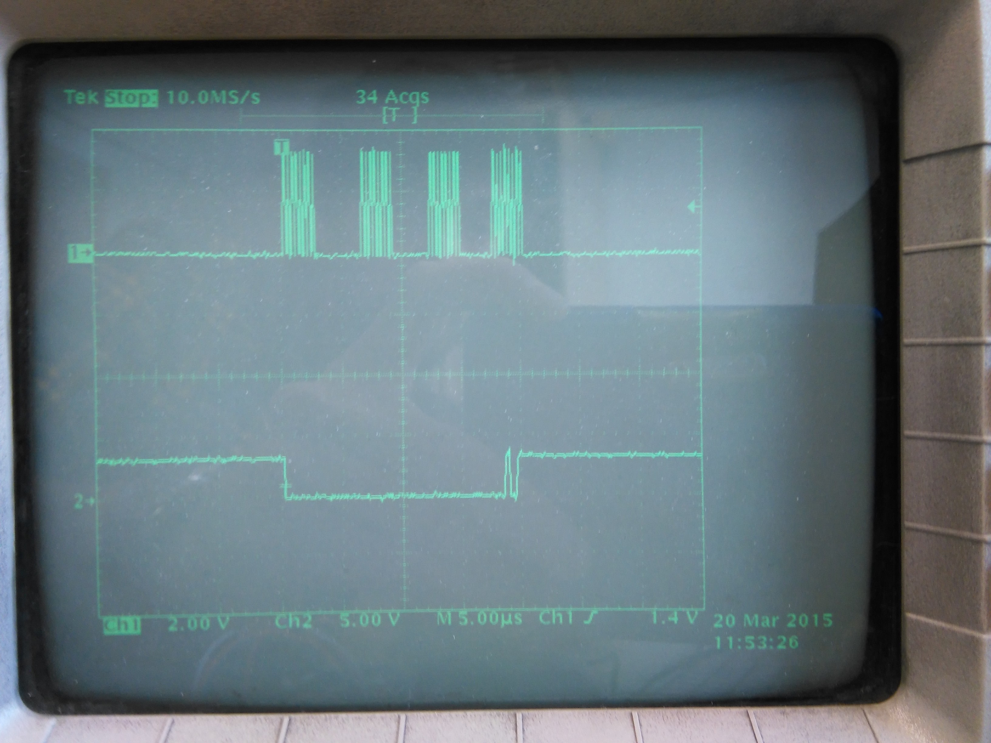

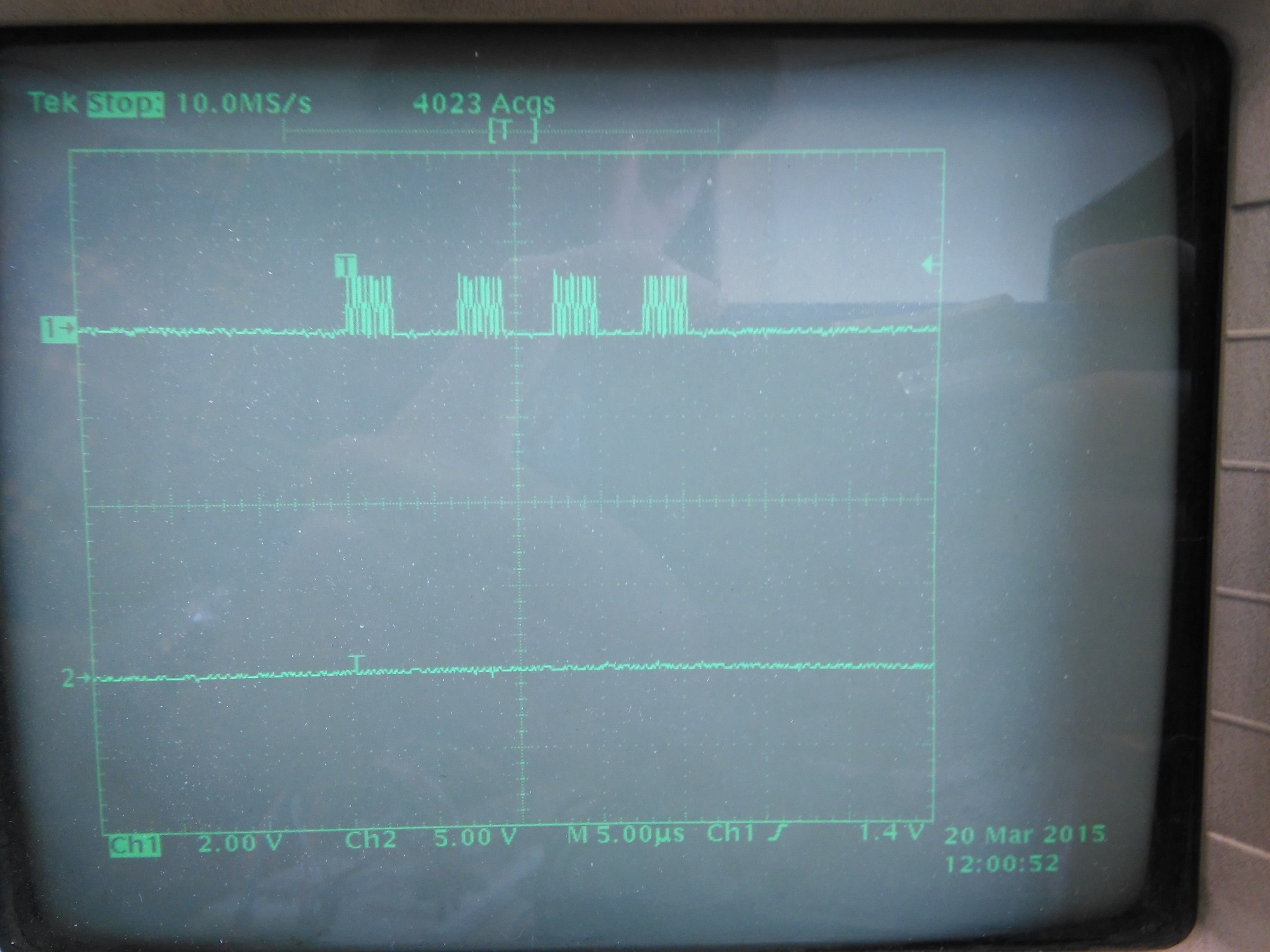

    I have been looking at SPI signals with the oscilloscope, and I have noticed that when I rewrite CONFIG1 register, SCLK signal´s amplitude decrease from 3.28V to 1.20 V.
    These  are the signals in SCLK and DOUT  (DIN in my microcontroller) when I send a RREG(address 0x05)  before and after rewrite the CONFIG1 register

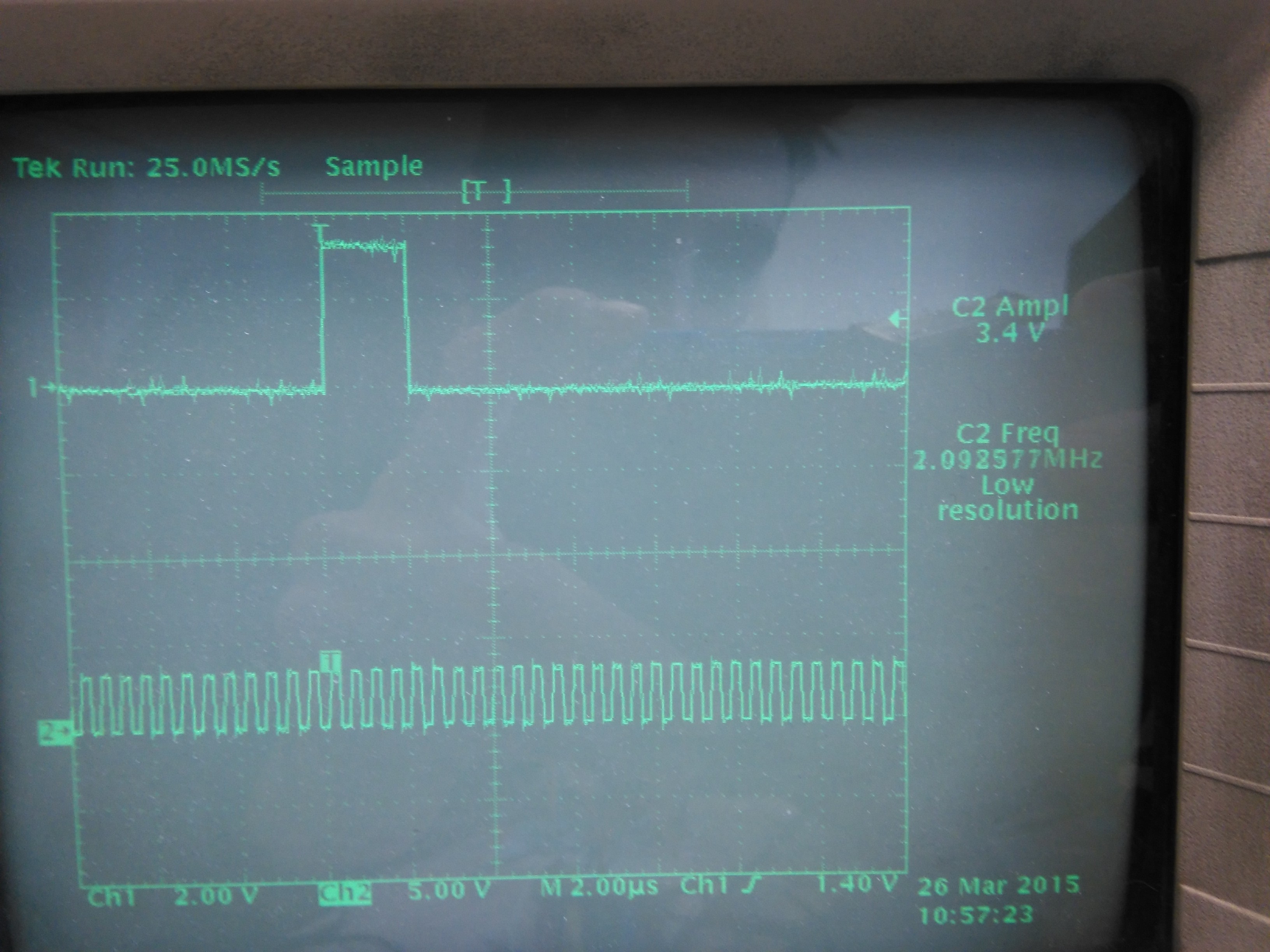

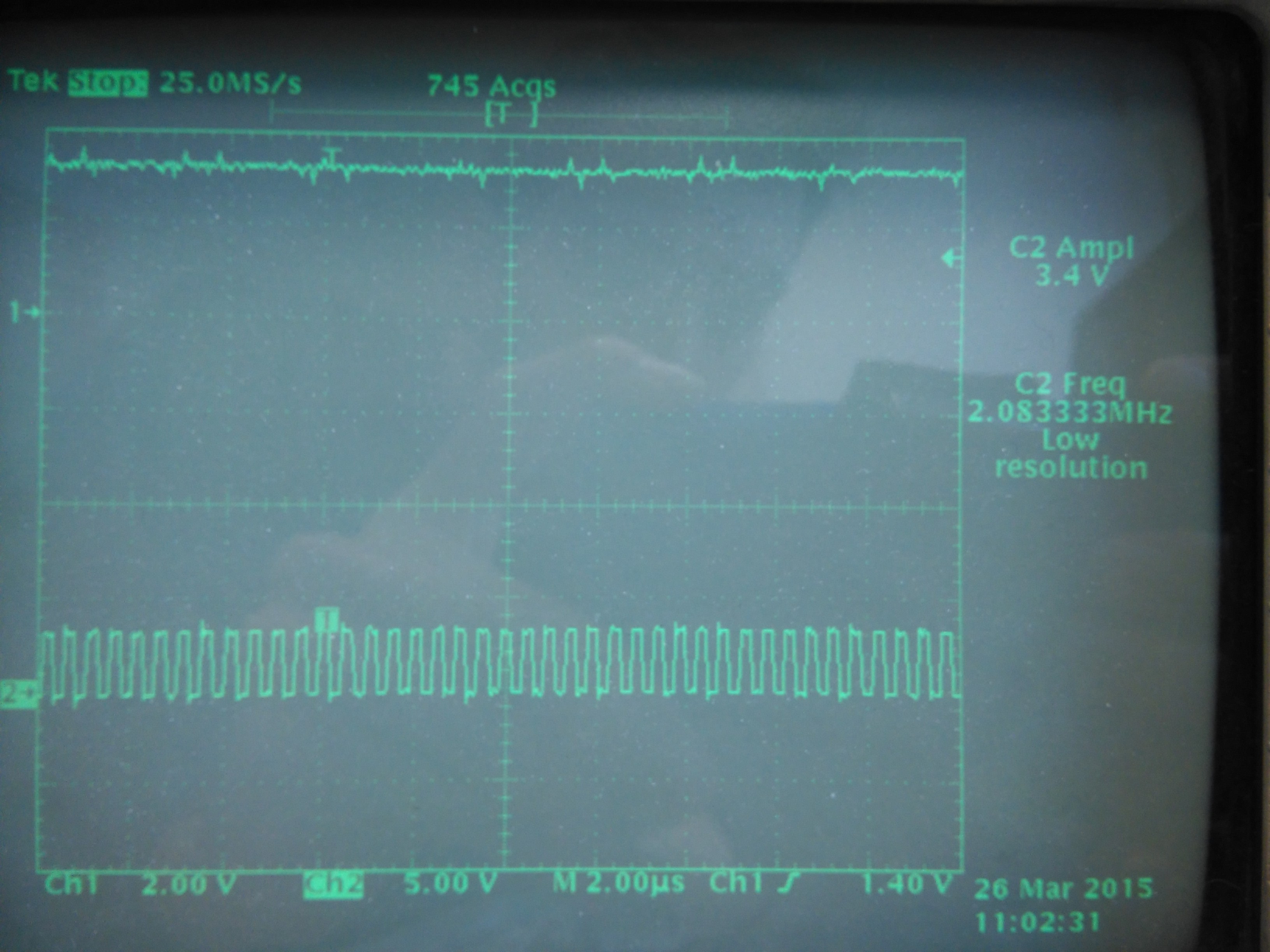

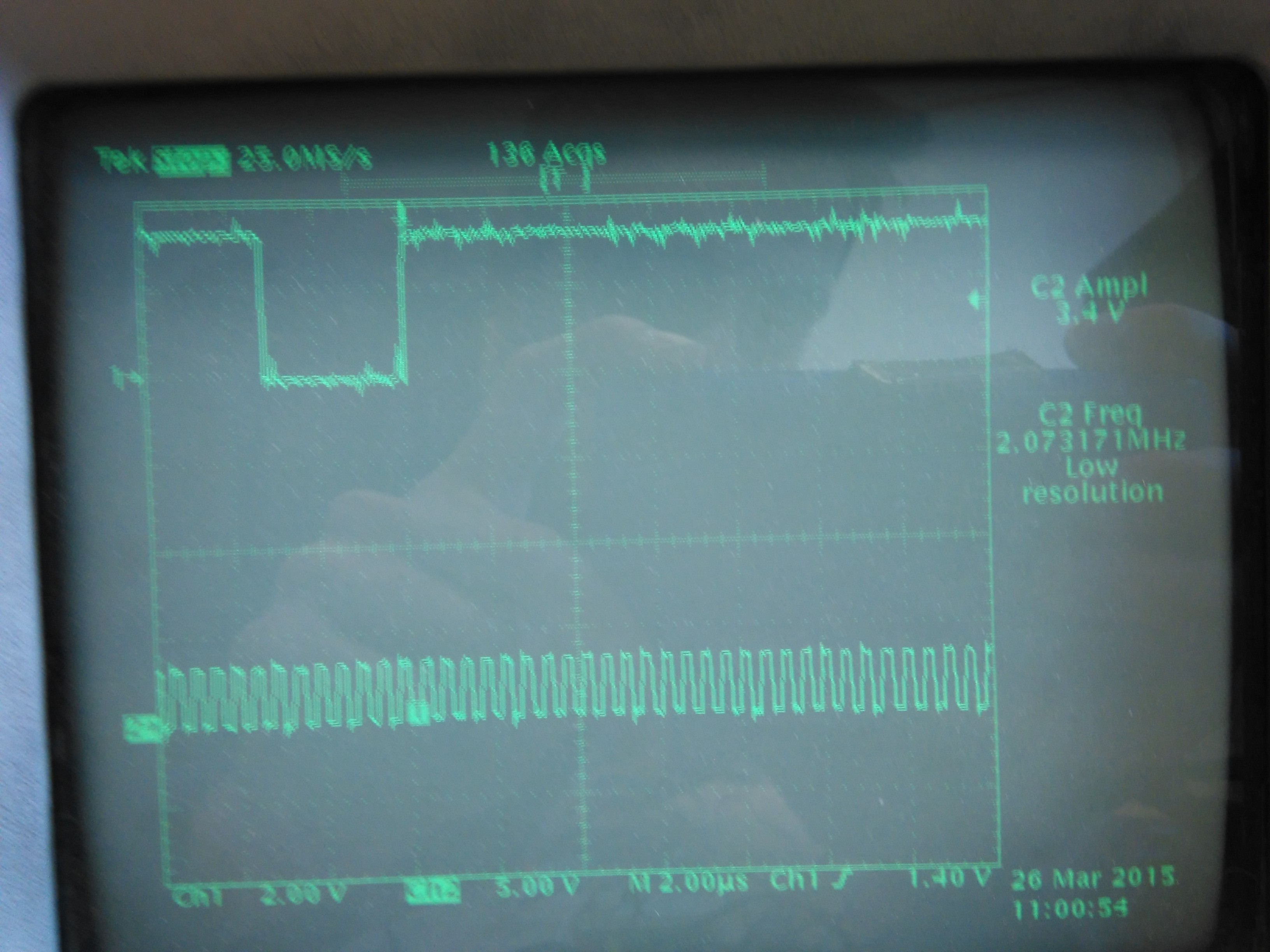

  • Hello Brian, Thanks for your help again .
    When I switch on my device  and I put START pin HIGH a pulse appears in DRDY line, when I put START pin low this pulse dissapear and DRDY goes LOW (I think that is strange). when I start a conversion (I send RDATAC, read and send SDATAC to stop the conversion) a pulse appears in DRDY and it keeps in this way always although I send a SDATAC command. Nevertheless when I write CONFIG1 register and I put START pin up DRDY goes high and it does not change.
        I dont have a pulldown resistor connected in this pin, but I have a pull-up resistor connected on DRDY line.
    THere is no variation in CLK signal, it is always maitaned at 2 MHz with 3.4 Volts.
    I am sending you some photos
    -At the beggining  DRDY and CLK
    -While it is reading from the ADS, DRDY and CLK
    when I have sent  WREG(CONFIG1)

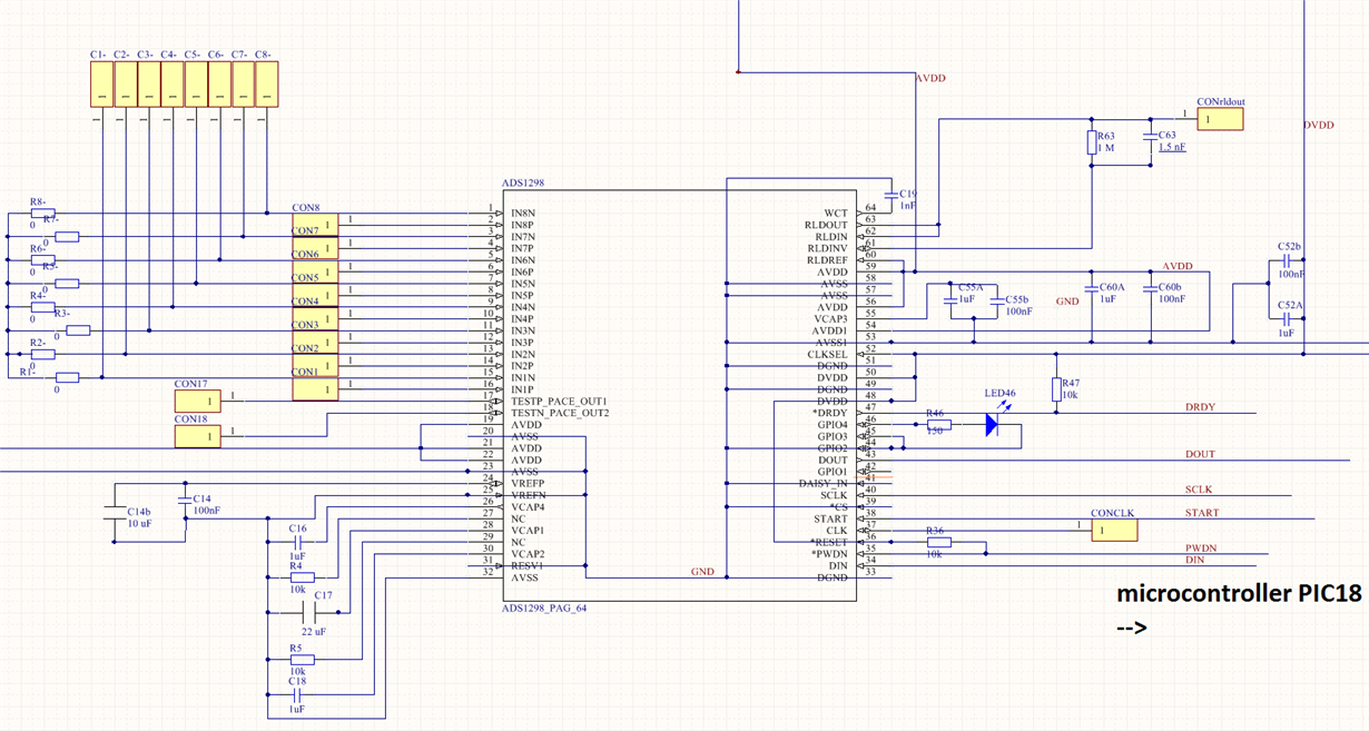

  • Hello Brian,
    I have checked AVDD and DVDD after and before I send the command, and there is no variation in the voltage ( AVDD =3V DVDD= 3.3V ). I can not monitor current in my circuit. I have not any resistor to probe the current.
    I have removed pullup resistor in DRDY line but there is no variation.
    I enclose the schematic.
    Thanks for your help Brian.
    Sixto
  • Hi Al,
    Are you attempting to activate that diode connected to GPIO4 at any point? If we assume the diode has a junction voltage of 2.5 V when activated, then we can expect it to demand a current of ~5mA across the 150 Ohm resistor. This current is much higher than the rated output current for a digital output on this device. I recommend configuring that GPIO as an input for now to disable the GPIO output buffer. In addition, what is the state of GPIO1? Unused GPIOs should be tied low and configured as inputs (GPIO pins are configured as inputs by default).
    Brian
  • Hi Brian,
    Initially I put this LED in th GPIO4 as a "debug LED", but I´m not using it .
    I will remove both of them in the next design.
