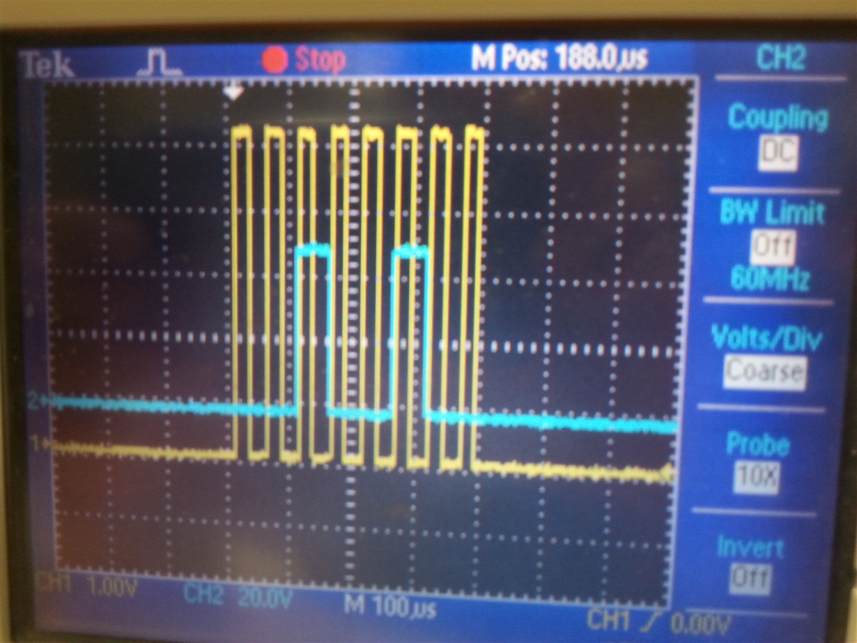

  • Thanks a million Brian, I have checked the SPI over oscilloscope its working perfectly fine shown below SPI Dout + CLK for 0x24.  My Software SPI is working at 20Khz and sends out LSB first, is it OK?
  • Hey Ghalib,
    What is the purpose of that command? Are you attempting to read the data stored in register 0x04? If that is the case you need another byte to specify the number of registers you wish to read and enough SCLKs following that to shift out the data you expect. For example, look at the following binary representations of the data lines during a valid read of the ID register (Xs indicate don't cares):
    MOSI: 0100 0000 0000 0000 XXXX XXXX
    MISO: XXXX XXXX XXXX XXXX DDDD DDDD
    The first MOSI byte is the REG opcode and the address of the ID register. The second byte is the (num registers - 1). The final MOSI byte is a byte of don't care data that will be sent while the register data is being sent out by the slave. The entire transaction will last 24 SCLK periods, during which time CS must remain low. If the SPI bus looks exactly like that during a register read then the correct data should be obtained. Let me know if the output on the SPI looks that way and you still cannot obtain the register data.
    Brian

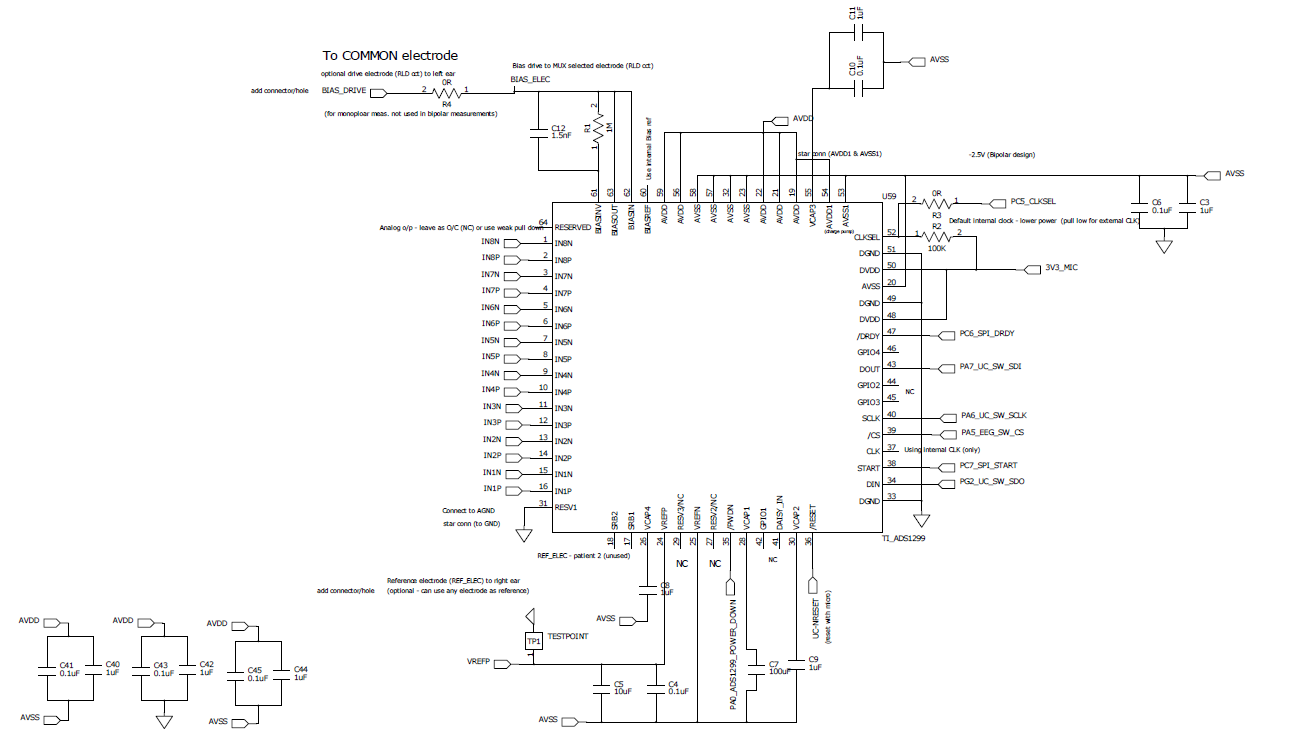

  • Hi Brian,
    Thanks for your help.
    The data on oscilloscope is not a  command but it is only picture I taken during checking the SPI. I am doing the exact same sequence of command you showed for MOSI & MISO but ID is not coming correctly . This is my schematic I am using if you can kindly have a look on this too, I might have made some mistake. I have made the reset pullup high with MCU
  • Hay Ghalib,
    Your schematic looks good. I know you said the RESET pin is pulled high, but what is the status of the PWDN pin? That must also be pulled high for the device to function correctly. Does the device seem like it is in a working state otherwise? Does DRDY pin pulse at the expected datarate when the START pin is held high?
    Brian
  • Hi Brian,
    Thanks a million. PWDN pin is set to high. I am using internal oscillator after setting START pin to high DYRY should occur at the rate of 2.048MHz/8192=250 Hz but when I see it on oscilloscope it not appearing at constant rate it occurs up 125Khz , with varying frequency.
    Can you guide me what can be possible problem or mistake I am making?
