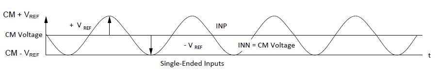

Can I drive the ADS1274 in a "quasi-differential" mode, where I drive the + input single ended, and drive the -input with a Reference voltage at mid-voltage of the input range? What down-side is there to this method of input drive?

  • Hi Ryan,
    Thanks for this suggestion. I'm using the AD1274 for recording Very low frequency signals (ECG - 1 mVp-p, down to 0.05 Hz. Low frequency noise is a primary concern. The Fully Differential amplifiers are typically not spec'd for frequencies below 10Hz, which is the high end of my range. (The THS4521 looks like its 0.1-100 Hz noise will be around 5uVp-p, a little high.) I must also simultaneously record accompanying signals of high amplitude (4Vp-p) at frequencies up to 30 KHz. Hence the need for a fast, wide dynamic range ADC.
    I was thinking of driving the ADS1274 from a low noise OpAmp (TLC2272) which is spec'd for low noise 0.1 - 10 Hz, ~~ 1 uVp-p. I was thinking of driving one input to the ADC from a fixed Reference voltage of +2.5VDC by a TLC2272. The active input would be driven by a TLC2272 at +2.5VDC nominal, with a +- 2.5VAC signal swing (total absolute swing from 0V to +5V). This should meet the operating specs. of the AD1274, and be accomplished at low noise levels.
    The down side to this is the lack of symmetrical voltage swings around a fixed common mode voltage level. (The common mode voltage would effectively have a large signal swing.
    Would my quasi-Differential drive signal be acceptable without compromising the performance of the ADC?
    Thanks for your help! Ron
  • Hi Ron,
    Thanks for the insight into your application!
    Essentially, what I believe you are describing is this picture below. The ADS1274 has a minimum of 90dB CMR (typical 108dB). I think that the swinging common-mode input should be ok.
    Does that help answer your question?
