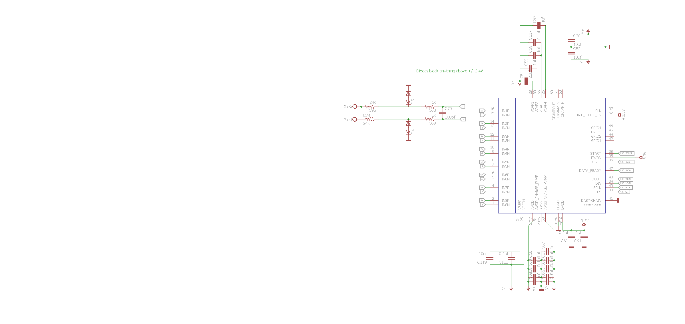

This was our setup when we experienced the ic failure.
Power Supply is 2.4V Bipolar
Chip failure occurred when a gain of 12 was used and 12V test supply was applied to both inputs terminals.. 12v through a 25K resistor should limit the current to 0.48ma, there was also diodes to protect in case of a surge as shown in the below schematic.
It is also worth noting that the entire chip failed and would no longer return it's ID via SPI
When testing the failure did not happen immediate although we did notice it was causing a drift in the other 7 channels consistently
Further testing has not been performed beyond verification of digital voltage supply (3.3V) and analog supply (+/- 2.4V)

  • Hello Jon -
    Have you verified what the actual ADC input voltage is? Protecting the inputs with the resistance to limit the current is a good idea, but there is a voltage restriction on the inputs also that could cause damage. We notice the input diodes for protection but they also require a finite amount of time to protect and there could be a small time when the input voltage exceeds the specifications. This voltage repeated over time could cause failure or damage that could show up at a later time.
    An additional question, if you are putting a full scale voltage applied to the inputs, why do you need a gain? Full-scale of the ADC is +/-Vref/gain, so the largest signal you can resolve is +/-Vref (gain =1). The gain is really used for small signal to increase the dynamic range performance.
  • Thanks for getting back to me Greg,
    I have not verified the actual pin voltage before the chip died but did test after it had burnt and it didn't seem out of line... I can test again but don't like the idea of burning more devices... As far as the repetition factor, I don't think it played a role in our test case as it failed in 15m and the voltage applied was constant.
    I hear you about the gain, the gain doesn't appear to make sense however we use these as the front-end for multifunction analogue inputs (CTs, VT's 0-5V Sensors, DC Voltage etc) and the gain is used to match the full scale range of a wide array of sensors
    I'll test the pin voltage again, do you think it's important to keep a scope on it until the device fails?  It shouldn't change with a constant supply right?
