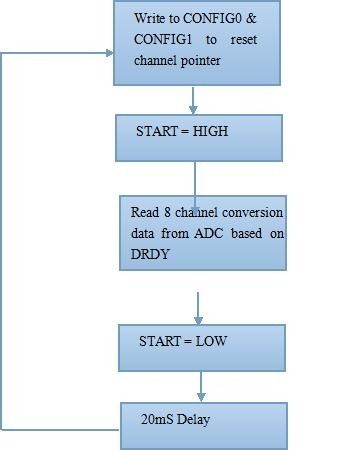

Below is the sequence of steps we are following for reading data from ADC:
1) Write to CONFG0 & CONFIG1 registers to reset the channel pointer
2) Make 'START' signal HIGH
3) Read 8 conversion data from ADC
4) Make 'START' signal LOW
5) Wait for 20mS

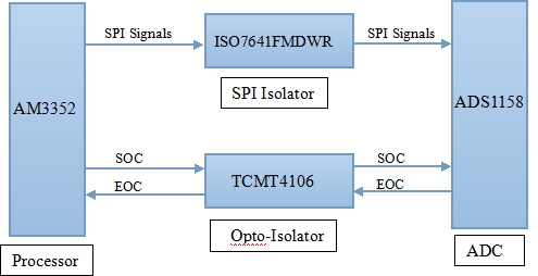

    Also, below is the brief block diagram for your reference, explaining the design architecture :-
    We have couple of queries with respect to the possible reasons for this behaviour.
    a) As mentioned in block diagram, we have used SPI Isolator for the SPI signals in between ADC and processor. Is there any possibility of SPI isolator causing this issue ?

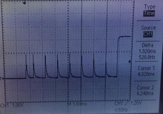

    (c) Below is the snapshot of the EOC signal for an entire conversion cycle of 8 channels. We have inverted the active level of EOC at output of opto isolator. This was done to accommodate the DMA triggering at rising edge.
    The snapshot details that as soon as EOC goes HIGH, processor is sending SPI clock pulses. Because of which EOC is going LOW immediately and the  observed HIGH voltage level is 2V (approx) instead of 3.3V.
    Is there any timing requirement for sending out SPI clock pulses after EOC transition ? Do we need to add some delay after EOC transition before sending out SPI clock pulses ?

    As for your other questions, I've never used an ISO7641FM, so I don't know where it would have a problem. My guess is that this is not where you are having the problems. It is possible, but since you generally get the correct result, SPI isolator is the problem.
    My concern would be the opto-isolator, it looks as if the trigger for EOC is slow. The tail-off seems to last 100s of microseconds. What sort of loads are you using for the TCMT4106? I would use what they recommend and would hope that the transition times would be near the single microseconds. It's possible that this transition time is extended because of the bandwidth of the scope and that the transition is really much faster (and the EOC high is much higher than the 2V), but I'm not sure what scope and scope probes you are using.
    How are you generating the EOC? It is supposed to be indicated as /DRDY drops low. I'm not sure that's what I'm seeing on the scope. Also, in the plot, the first two EOC pulses are closer together than the remaining pulses. Is there a reason for that? I would have thought they would be equally spaced for the same data rate.
    The big concern is that the EOC sends the signal to the AM3352 is getting a delayed signal. If it is so delayed, the readout could be interrupted by another DRDY signal, which would corrupt the data.
    I'm not aware of any timing requirements for sending SPI clock pulses after the /DRDY besides the one shown in Figure 2. With the EOC looking like it could be delayed, I don't think that this could ever be a problem.
