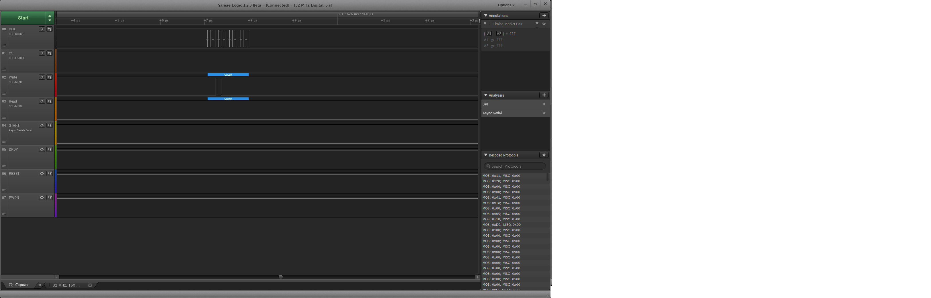

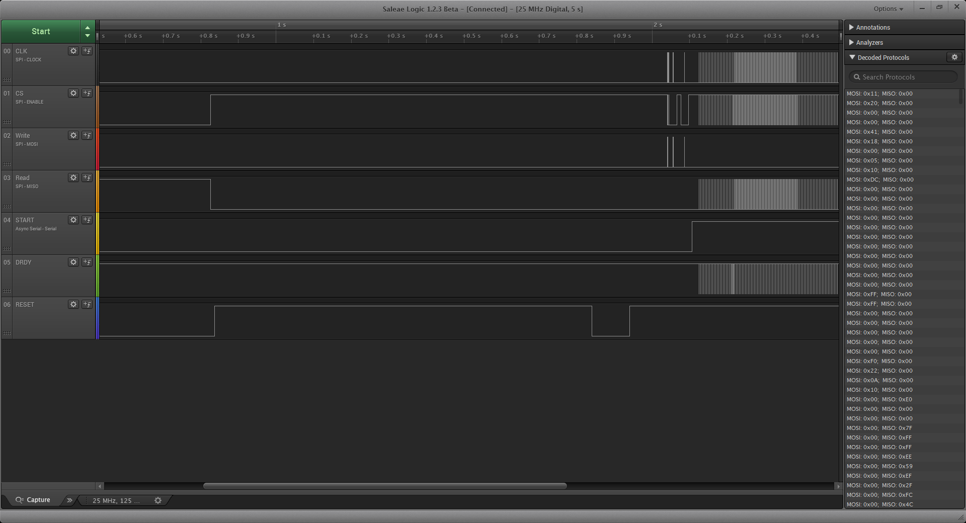

I'm operating ADS1298 with STM32F4xx, but I always fail to run command RREG and WREG.
so that I always get DRDY signal with rate of SPS 250, which is the default value after reset.
Following is my code, which I wrote according to the user manual with the reference of a lot of web pages.
I hope I can get some help from you, pointing where I'm wrong,
or you can give a copy of sample code that I can successfully read out the ID register or write into other configuration registers(because they said e2e forum has source code).
My dev environment is: ADS1298,STM32F407VGTx,Keil uVision5,STM32Cube_FW_F4_V1.7.0
Also, I attached one snapshot of timming diagram I got out.

  uint8_t datarx[26];
  SetCSValue(0);                                //Set CS PIN LOW
  SetPWDNValue(1);                       //Set PWDN PIN HIGH
  SetRESETValue(1);                         //Set RESET PIN HIGH
  HAL_Delay(1000);                          //Sleep 1 Second
  SetRESETValue(0);                         //Set RESET PIN LOW
  HAL_Delay(100);                            //Sleep 100 mini second
  //SDATAC
  SDATAC_Command();                 //Send SDATAC Command
  //RREG
  memset(datarx,0,sizeof(datarx));
  RREG_Command(0x20,0,datarx,1);        //RREG Command,  read only ID register, aways return 0x00,check the diagram for command sequence
void SDATAC_Command()
  uint8_t data = 0x11;
  SetCSValue(0);
  HAL_SPI_Transmit(&hspi2,&data,1,1);
  HAL_Delay(1);       //Sleep 1 mini second then set CS HIGH
  SetCSValue(1);
void RREG_Command(uint8_t opcode1, uint8_t opcode2, uint8_t* datarx, uint8_t len)
  uint8_t datatx[26];
  memset(datatx,0,sizeof(datatx));
  SetCSValue(0);
  HAL_SPI_Transmit(&hspi2,&opcode1,1,1);
  HAL_Delay(1);
  HAL_SPI_Transmit(&hspi2,&opcode2,1,1);
  HAL_Delay(1);
  for(int i=0;i<len;i++)
    HAL_SPI_TransmitReceive(&hspi2,&datatx[i],&datarx[i],1,1);
  HAL_Delay(1);
  SetCSValue(1);
With the following SPI configuration:
  hspi2.Instance = SPI2;
  hspi2.Init.Mode = SPI_MODE_MASTER;
  hspi2.Init.Direction = SPI_DIRECTION_2LINES;
  hspi2.Init.DataSize = SPI_DATASIZE_8BIT;
  hspi2.Init.CLKPolarity = SPI_POLARITY_LOW;
  hspi2.Init.CLKPhase = SPI_PHASE_1EDGE;
  hspi2.Init.NSS = SPI_NSS_SOFT;
  hspi2.Init.BaudRatePrescaler = SPI_BAUDRATEPRESCALER_2;
  hspi2.Init.FirstBit = SPI_FIRSTBIT_MSB;
  hspi2.Init.TIMode = SPI_TIMODE_DISABLED;
  hspi2.Init.CRCCalculation = SPI_CRCCALCULATION_DISABLED;
  hspi2.Init.CRCPolynomial = 10;
  HAL_SPI_Init(&hspi2);
