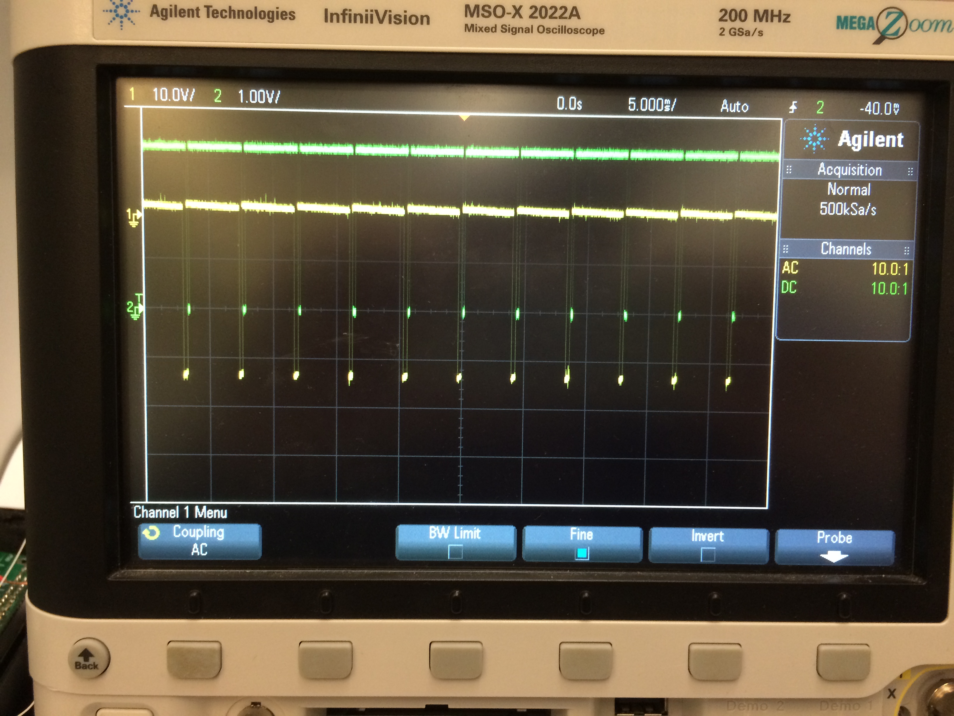

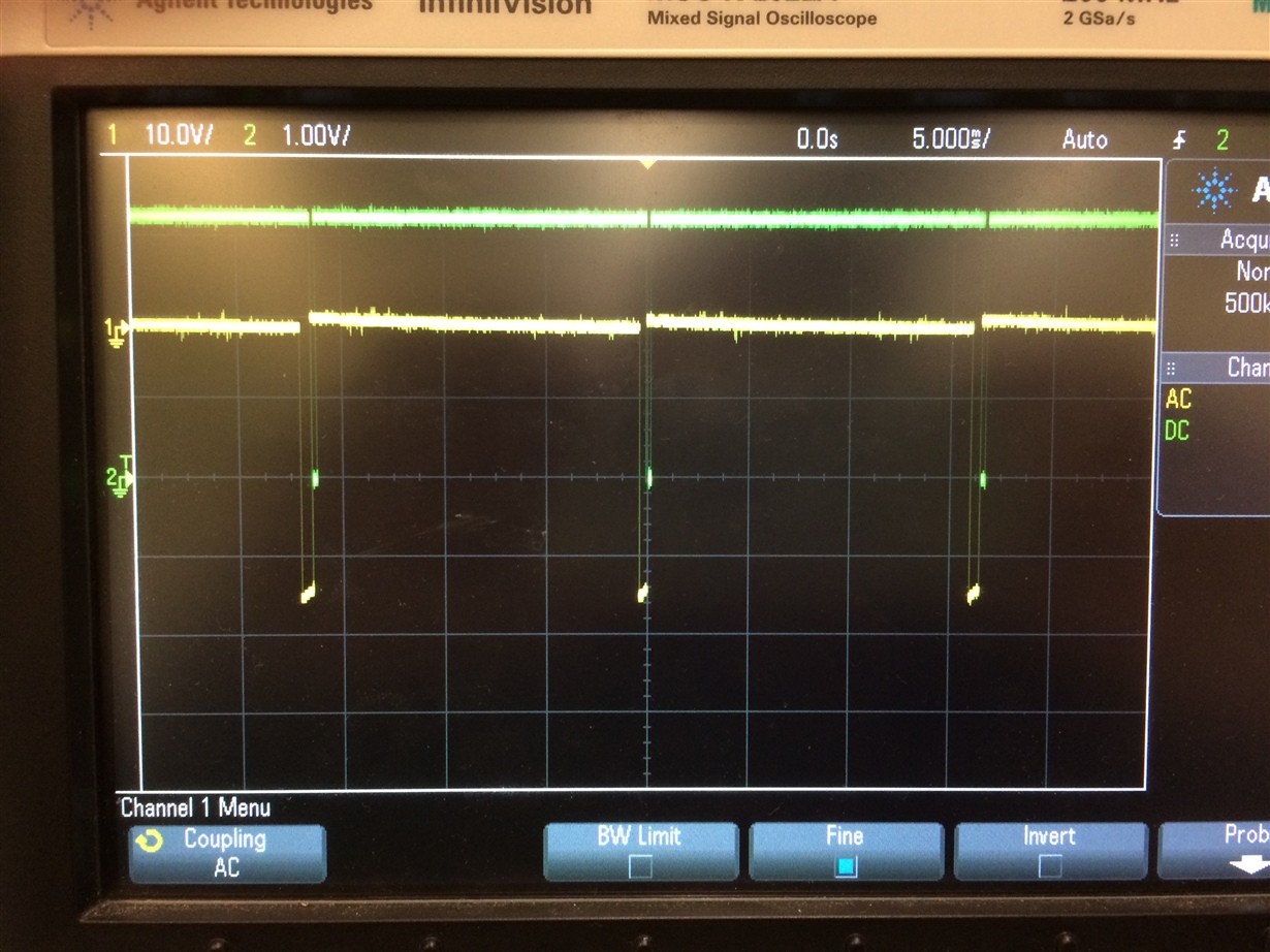

  • Hi Brian,
    I tried the different sampling rate. For example, by default the sampling rate should be 250Hz, which means we should have 4ms interval. But in fact I have about 16ms interval. When I configured the sampling rate as 1024Hz, which means we should have 1ms interval. At this time in fact I have about 4ms interval.
    Here is the pic based on 250Hz:
    Here is the pic based on 1024Hz:
    And the yellow should be DRDY signal while the green should be CS signal.
    Thank you for your great support.
  • Hey Mian,
    It seems like the DRDY is happening 4x slower than what you configure. Is SCLK doing anything in between the DRDY pulses? If not, have you tested this with another board?
