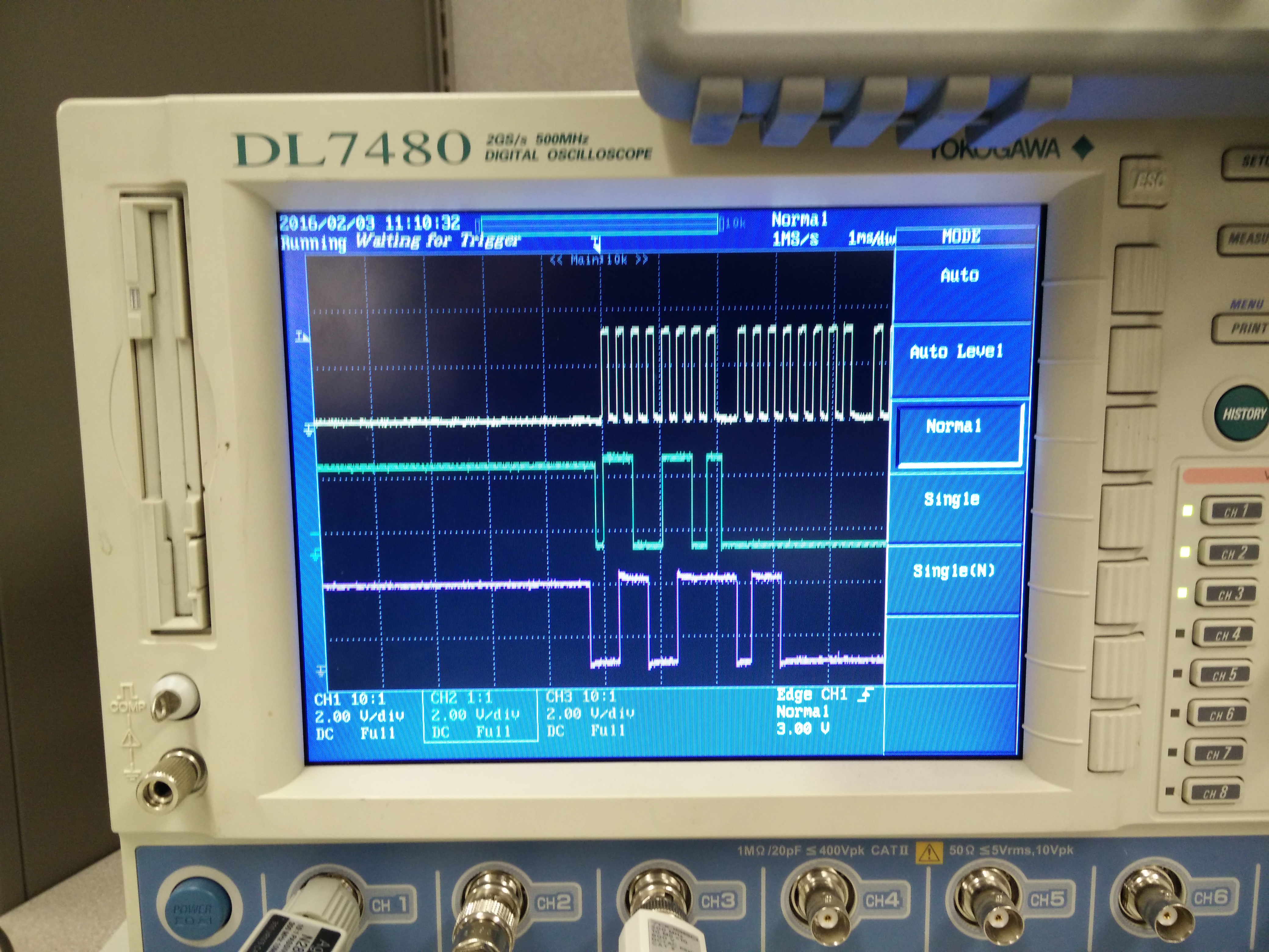

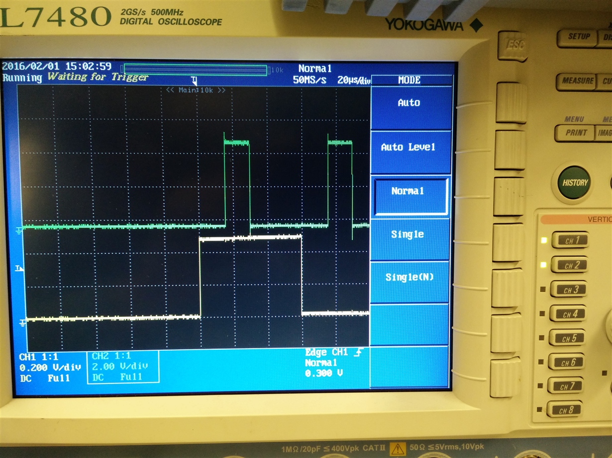

    Attached few more captures of oscilloscope. I had just 2 channel scope so could not capture everything together but tried to capture V/div and Time/div in all captures.
    Image1:
    1) Green: CS
    2) Yellow: SDI (0xaa,0xaa,0xaa)
    3) Time division: 1ms/S
    Image2:
    1) Green: Clk
    3) Time division: 500 us/S
    Image3(Magnified):
    1) Green: Clk
    3) Time division: 20 us/S

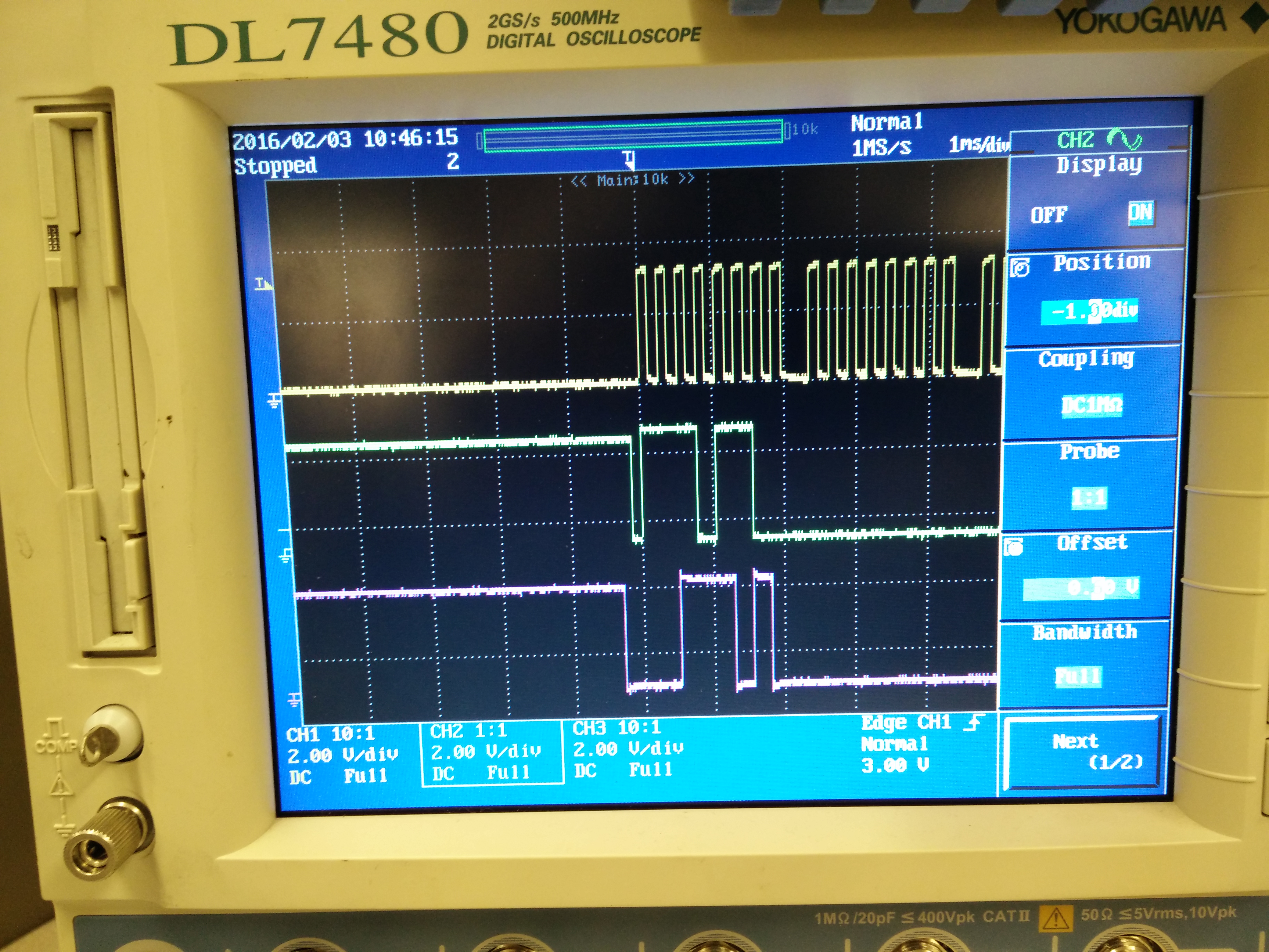

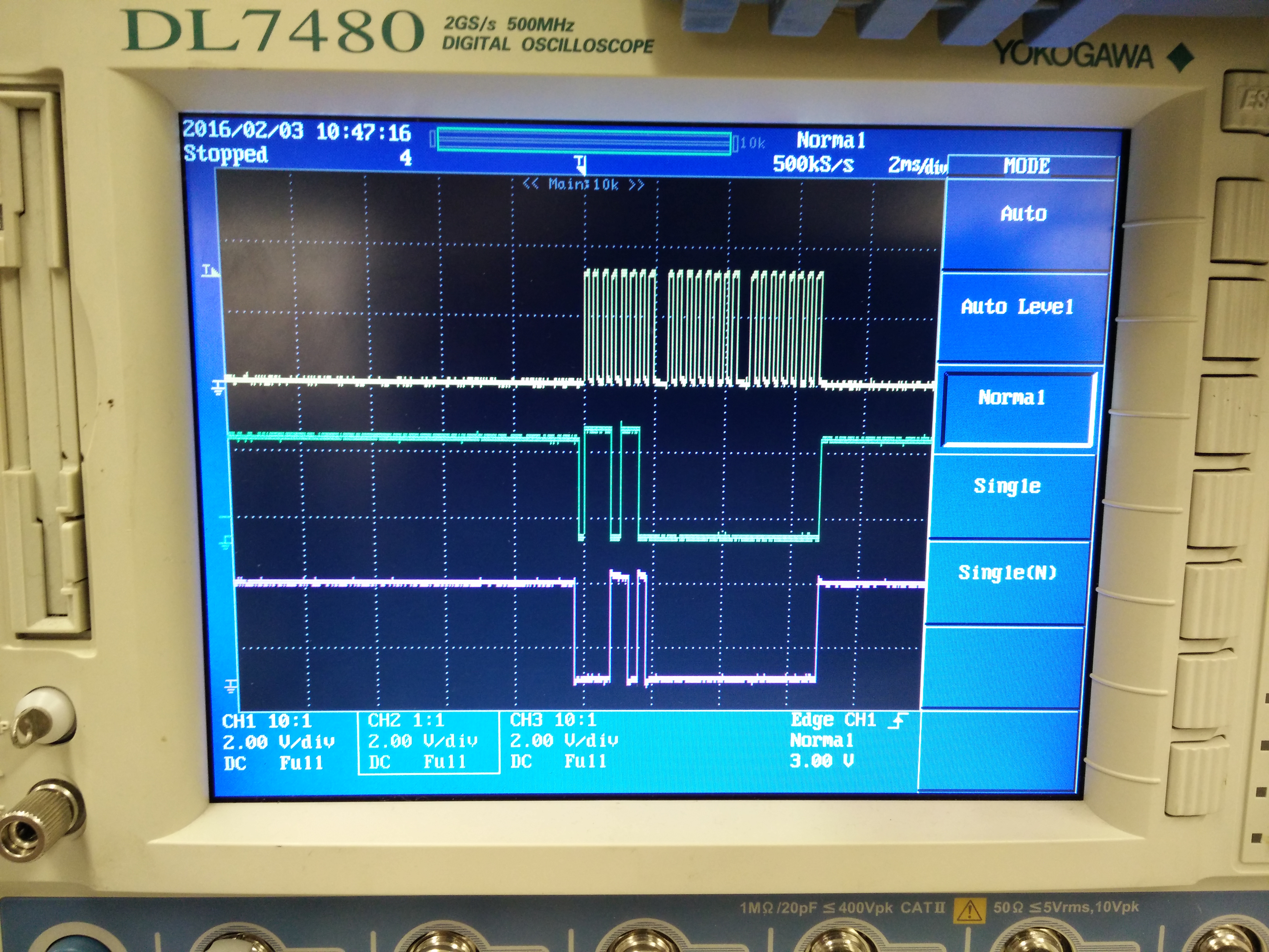

  • Matt,
    Now gap between 8 bit packets is 'one clock cycle only'. Yes, SPI/I2C pin is pulled high.
    Attached few more captures as you requested and managed to capture CLK, SDI and SDO together.
    First channel: Clk
    Second channel:SDI
    Third channel: SDO
    1) Sending 0xEC to read 0x6C register but SDO data is 0.
    2)  Sending 0xCD to read 0x4D register but SDO data is random.

    From what I gather from the images, the SCLK frequency seems to be around 4KHz -- I will email our designers to find out if this frequency is acceptable.  I'm not currently in office, but I plan to recreate your setup with communication speed so we can debug and find a solution.
