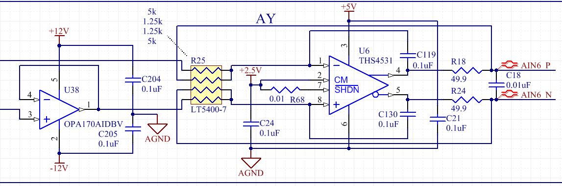

    So good to hear from you!  Here is the drive to the A/D:
    AIN6_P and AIN6_N feed the A/D with the addition of a 1.5nF differential capacitor on the input.

    Lastly, regarding my earlier comments about ADC input settling, the THS4531A is a rather "slow" FDA with only 36MHz unity-gain bandwidth. You may try rerunning your tests with a slower ADS1278 modulator clock frequency (fMOD) to ensure the inputs have enough time to settle after every sample.

  • Ok. I'm not sure what that tells me either. How are you setting the input common-mode voltage? Remember that the ADS1278 is using a unipolar supply, so the absolute voltage on each input pin cannot be negative. The THS45xx driver will take care of that for you by driving the VOCM pin (which defaults to mid-supply if floating). If you try bypassing the driver, I would fix one of the ADS1278 inputs to mid-supply, and then swing the other input above/below mid-supply to generate the positive/negative differential inputs.
  • Ryan,
    Ok, I will adjust in the manner you suggest. Also, I believe the attached picture of our drive amp is shown where the VOCM pin of the THS4531 is driven by a precision reference REF2025 at 2.5 V.
