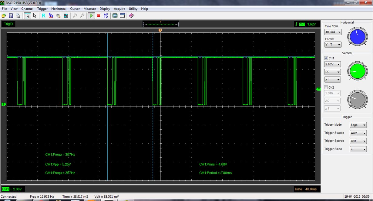

  • Dear Bob
    Thanks for replying, and i almost forgot the timezone :)
    Although please find the working configuration screen shots and my ADC schematic attached.
    Please notice that DRDY/DOUT time from low going edge to the next low going edge is 58ms.
    In my code i have a 931us delay between SCK pulses which you can see in the SCK image.
    I have shared my ADC schematic part as pdf.
    Please get back if you find something  schematic-power.pdf

  • Hi Abhijit,
    Let's start with the schematic.  Your DVDD for the ADS1231 is at 5V, but your microprocessor is running at 3.3V.  This means the micro must be capable of tolerating a 5V input (and most are not that I'm aware of) and the ADS1231 is only seeing at best 3.3V for a logic high.  With a 5V digital logic for the ADS1231, the logic level for VIH as specified in the electrical characteristics table on page 3 of the datasheet is 0.8DVDD (4V).  This is not reliable and the ADS1231 digital voltage should match the micro.  You do not need the same voltage for AVDD and DVDD for the ADS1231, so I would suggest that you connect DVDD to the 3.3V_MCU supply.
    However, the grounds for the ADS1231 should be at the same potential.  Any added inductance, including long trace lengths, between AGND and DGND of the ADS1231 has the potential for damaging the device.
    Now let's discuss the screen shots you sent.  You may think you are getting stable readings by adding the 900us delay, but what you are actually receiving is invalid readings by violating the timing specifications.  Notice on page 13 and Figure 19 of the ADS1231 datasheet that there is a tUPDATE period that takes place at the end of every conversion cycle.  At 80sps, the period is 1/80 or 12.5ms.  Also notice that in the table below the figure is a description for tUPDATE that states "Data updating: no readback allowed". If you roughly calculate that one SCLK cycle takes 1ms, and you issue 25 SCLKs, then the period for one complete read out of the data takes 25ms.  This means that you are attempting to read through the update period which is "not allowed".  So even though your reading may be stable, they are invalid.
    So now we move on to the unstable readings.  First review the noise performance table on page 6 of the datasheet.  You will see that at 80sps and 5V AVDD that the best noise performance is 15.9 bits noise free.  This performance is measured with shorted inputs at mid-AVDD supply (so that the inputs remain at the correct common-mode input range).  In other words, you will not see stable readings and in fact the last 8 bits will be fluctuating.  At 5V AVDD this amounts to typically 622.1nV peak to peak of noise for the ADS1231.
    One other thing I want to cover is your calculation.  The full-scale range for the ADS1231 is +/- 0.5VREF/128, or VREF/128.  The LSB value (one code) is FSR/(2^24-1). So the value of one code is the (VREF/128)/(2^24-1) and is approximately 2.33nV.  Based on the typical noise of 622.1nV, the code variation is about 267 codes or approximately 8.1 bits.
    I'm not quite sure how you are deriving your voltages, but they seem a little high.  I think in the end that you are seeing anywhere from 3 to 10 times the normal noise and perhaps more.  The noise can come from a variety of different noise sources including power line cycle noise.  The first thing to do is to make sure that you can achieve the shorted input noise performance.  If you cannot, then you need to investigate possible issues with your supplies and board layout.  You should have a very good ground plane area at least around the analog portions and the ADS1231.  You have very little analog input filtering, and it also appears that the common-mode caps are the same value as the differential cap.  The differential cap must be at least 10 times greater in value as compared to the common-mode caps to lower noise and drift issues.  You may also want to add some series resistance in series with the analog inputs and before the capacitors to help lower external noise.
    I also see that you have a relay in your schematic.  Relays can be a very troublesome noise issue as activation can cause considerable ground bounce and supply instability.
    So to recap what I have stated, you cannot use the 900us delay on SCLK as this violates the timing specification for 80sps.  You should make the ADS1231 DVDD supply match the micro supply so that the digital circuits are getting the proper voltage, and lastly noise is to be expected but excessive noise must be eliminated and the bulk of the noise is most likely coming from external sources.
    Bob B
