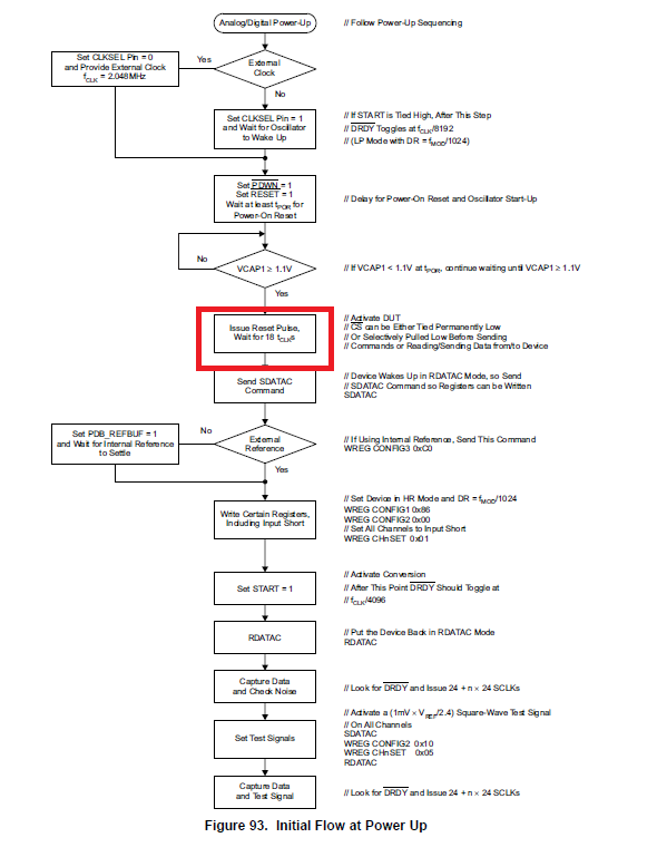

Can i  issue a soft reset in the place of Issue reset Pulse,wait for 18tclks.
