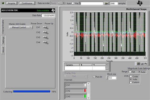

I recently purchased the ADS1274EVM-PDK from mouser.com and the product I received seems to be malfunction right out of the box.
The first thing I did was hook up the ADS1274EVM to a function generator.  I used channel 1 with the negative input connected to the internally generated 2.5V which is available at TP3.  This way I could see a signal between 0-5V.  The positive terminal was connected to the output of the function generator.  All jumper and switch settings were verified to be in their default positions.
Waveform was a sine wave with a Vpp of 2V with an offset of 1V, which is well within the range for the ADC.
What was seen on the multiscope of the ADCPro software was the voltage signal just jumping around from +2.5V to -2.5V and only output those two values.  I made sure that Vref in the ADCPro GUI was 2.5V and even verified that the signal from the function generator was correct with an oscilloscope, but I could not get the ADS1274EVM to output the function from the function generator.

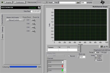

  • Thanks Ryan,
    Sorry for the delayed response I have been a pretty busy student this past couple of days.
    So here is a picture of the EVM setup.  I am using Version F and the FDAs are the THS4521.
    The green jumper cable is going the output of my function generator and the black jumper cable is the ground for the function generator.  I have the FDA buffer enabled for CH1 and i'm using the internally generated VREF.
    The function generator is outputting a sine wave with Vpp of 1V with a 0V offset.  Here is the image from the MultiScope of the ADCPro Software:
    This time around I am getting 0V continuously.  I have made sure that my function generator is actually outputting the signal so no problems there haha.

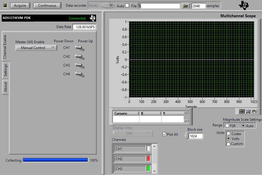

  • Okay, so I have removed the JP3 and I still have the buffer selected on CH1.  I connected the ground connection for the function generator to the GND pin at TP4.  I am still getting a 0V output on the MultiScope.  I used the oscilloscope to prove C25 as you suggested, and I can see my signal at half the differential amplitude.
    So I have been trying to figure out why my output is 0V and for some reason I had removed JP13B. So I added it back to the setup and now I am getting the pulses I have seen before.  Here is an image of the MultiScope output.  I still have the negative input to CH1 grounded to AGND from TP1.  I am still using a sine wave with Vpp = 1V and VDC = 0V.

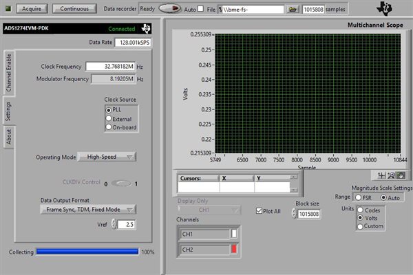

  • The frequency of the sine wave is 1kHz.  Here is a picture of the scope capture across C25 and the image of the settings tab for the EVM.
    Settings Tab:
    Scope Capture of Sine Wave across C25:
    So I have cut the trace as outlined in a previous discussion link/Errata sheet. I Verified that the trace was with a microscope view and continuity check with multimeter.
    I measured the reference voltage across C7 and it was indeed 2.5V.
    I also switched between CH1-4 with the same output from the function generator.  I made sure to switch on the buffers for each channel.  What was strange is that for channels 2-4 I just got a 0V signal, but for CH1 I got the signal that was imaged in my latest response.  To make sure I was inputting the proper signal to the channels I used the oscilloscope to measure the signal across C23 for CH2, C18 for CH3, and C16 for CH4.  I got the same scope capture as imaged above for all 3 capacitors.
