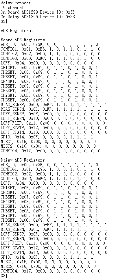

  • Hi,Brian
    I want to use two ADS1299 for capturing 16 channels of EEG  signal. So I'm chaining two ADS1299s together as the cascaded mode:  ADS1299 datasheet PDF33.
    The registers value  of Board_ADS and Daisy_ADS as follows.
    Now I want to print out the 16 channel value of ADS(I did not connect any signal to ADS input pin).What I got as follows.
    The data looks crazy. What is wrong with it? If there is nothing signal connect to ADS1299 input pin,what value should I get from the serial port? How
    do I judgment the correctness of the data?
    Thank you.

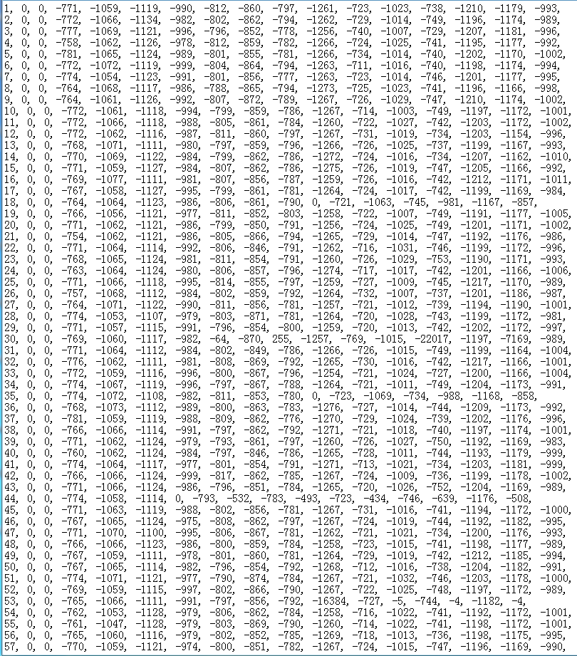

  • Hi,Brian
    I have changed the MUXn[2:0] bits in the CHnSET registers to b'001,and what I got as follows.
    (a)The value of registers.
    (b) The output data of 16 channels.The output data has changed.
    Questions.
    (a)Are the value of these registers reasonable?
    (b)Are the value of my channels data  reasonable? I am not clear about that.
    Thanks.
  • xyz,
    The registers look good.
    The non-zero values look reasonable. When the inputs are shorted, the results should correspond to the inherent voltage offset. For a gain of 24, the offset should be relative small.
    For your information, you can convert decimal to voltage by using this formula: voltage = code * Vref / [PGA gain * (2^23-1)]. The first two results of each conversion look fishy. I would look in your code to see why those results are always showing up as zero.
    Brian Pisani

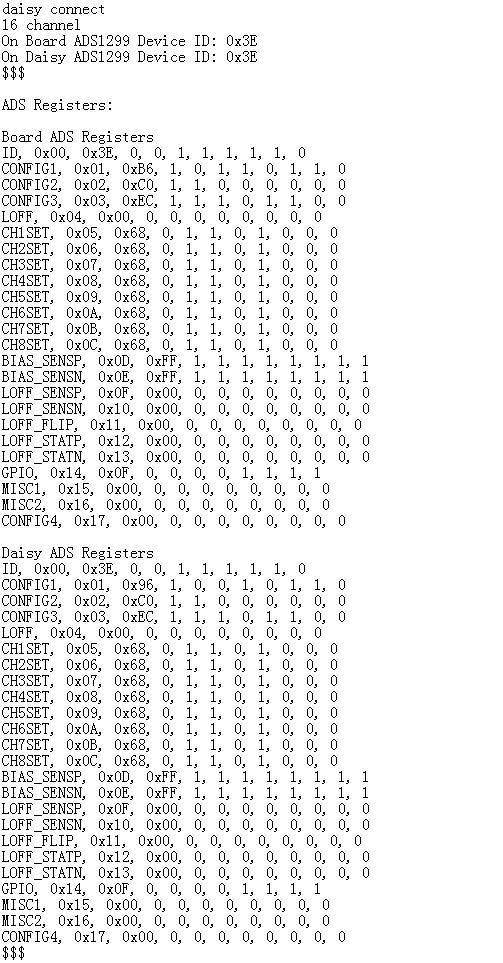

  • Hi,Brian
    Thank you so much for your reply.
    Yes.The first two results of each conversion look fishy.I have checked my code and I found a mistake.A very long delay() function in my updateChannelData()  function,it's the reason that the first two results of each conversion look fishy.
    Now I have solved the problem and the result of testing signal looks fine.

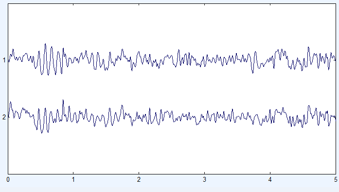

    Later,I changed the MUXn[2:0] bits in the CHnSET registers to b'000(Normal electrode input)  to get external signal.
    On my circuit board,I connect the SRB2 pin of  borad_AD and the SRB2 pin of  daisy_AD together.I use a signal generator to generate a square wave signal(Frequency:10HZ,Amplitude:100mVpp)This signal was  connected to both borad_AD and daisy_AD's first channel(CH1).
    I got the corresponding two-channel data and draw with MATLAB.The result as follows.
    The result looks fine.Right?
    Are there any mistakes or shortcomings with what I have described above?
    If not,I intend to capture the real EEG data.This is really exciting.
    Thank you for some advice.
  • Hey xyz,
    That waveform doesn't look quite clean. What were the SRB2 pins connected to? Just to one another or to ground? If they are not driven actively, they will just be floating.
    Brian
  • Hi,Brian
    I connected the SRB2 pin of the first ADS1299 to the SRB2 pin of the second ADS1299. And then connected them to ground(I mean,the ground of signal generator).In my program, I have set all of the CHnSET regsiter value as 0X68(0110 1000).Yes,I have tested it again and again,and the waveform doesn't look quite clean.I don't know why.
    xyz
  • xyz,
    The ground of the signal generator is also "floating". You should connect all three nets (both device's SRB pins and the signal generator ground) to (AVDD+AVSS)/2. If you are using dual supplies, that is just the board ground. If you are using a unipolar supply, you can configure the BIASOUT pin to have a regulated midsupply by powering it but clearing all of the BIAS_SENS bits.
    Brian

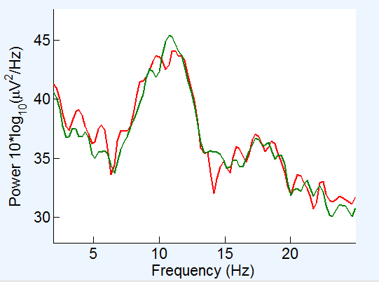

    I have done some experiment to record some EEG,such as eyes-closed alpha waves.I attached two electrode of the head(O1 and O2),the reference electrode to the left earlobe, and the bias electrode to the right earlobe.
    I got the time-domain plot and frequency-domain plot as follows.
    The results looks good.Right?
    You really do me a great favor.Thank you very much.
  • xyz,
    It certainly looks like there is a lot of signal content in the frequency typically associated wit EEG, but I am not a neurologist ;-)
    I'm glad you seem to be getting some reliable data, though.
    Brian

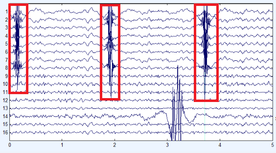

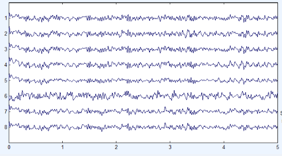

  • Hi,Brian
    I use my board to get 8 channels EEG and 16 channels EEG,and the waveform as follows.
    (1)8 channels.The waveform looks beautiful.And everything is fine.
    (2)16 channels.Maybe something wrong.The data of 1-8 come from the second ADS1299(daisy device),and 9-16 come from the first ADS1299(master device).As you can see,from channel 1 to channel 8,there will be a fluctuation from time to time(I marked it in the diagram).
    I do not know how it happens.This makes me very confused.Please help me.Thank you.
  • xyz,
    It could be the data is corrupted for those samples because the data is not being shifted out quickly enough. To determine this, take a look at the samples on channel 1 of the daisy chained device in that area and look to see if any of them have the sequence '1100' beginning in the middle of the samples. This is the beginning of the status word which appears at the beginning of every sample
    Brian

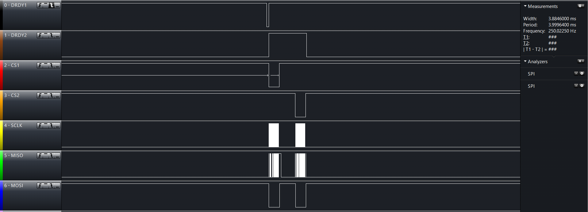

  • Hi Brian,
    I can get sequence'1100' on channel 1 of the daisy chained device(status word starts with 0xC0 as expected).
    I use a logic analyzer to get the signal.I am confused with the DRDY signal.
    Screenshots come from two different moments.You can see the difference with the following pictures.Is it a mistake?
    With the logic analyzer source file.
    16channel-EEG.zip
  • Hello xyz,
    It looks as if the DRDY signals are not synchronized. This could be because of one or two things. First, they must be using the same master clock. All clocks have slightly different frequencies even though they may be nominally rated for the same frequency. If the device are not using the same clock source, they will eventually drift apart in the time domain. Second, the devices must be synchronized using the "START" pin. The START pin will synchronize the conversion process such that DRDY will occur at the same exact time for both devices. Are you missing either of these steps?
    Brian
  • Hi,Brian
    It looks as if the DRDY signals are not synchronized.I mean,the state of DRDY are different from the Figure 39(ADS1299 DataSheet 32).
    You pointed out two possible problems.I have checked it.
    (1)master clock.
    In my circuit,I connect CLKSEL  pin to DVDD(3.3V) of both device and  tying the CLK pins of both devices together.  And initialize the register settings as follows.
    Board ADS Register,CONFIG1, 0x01, 0xB6, 1, 0, 1, 1, 0, 1, 1, 0
    Daisy ADS Register,CONFIG1, 0x01, 0x96, 1, 0, 0, 1, 0, 1, 1, 0
    You  said the CLKSEL pin on the second device should be low.So I made a mistake?
    (2)synchronize
    You said the devices must be synchronized using the "START" pin. In my circuit,the START pin are floating of both device(when floating,the START pin is low).I use the START command to synchronize devices.As your description,I made another mistake.I mean,in multiple device configurations, the only way to synchronize devices is using the "START" pin? START command is invalid?
    By the way, I designer my circuit refer to OpenBCI 8bit.sch. I really confused with the OpenBCI 8bit.sch and the reply of you.
  • Hey xyz,
    1. If CLKSEL of both devices is high, that means they are using their own individual internal oscillators which are not synchronized. Instead, you can tie the CLKSEL pin of the daisy device low. This way, the daisy device will use the 1st device's clock as its master clock.
    2. You will not be able to use the START command to synchronize the devices. Since you have your devices configured in a cascade, you must issue the commands sequentially. For the device to be synchronized, they must be started at exactly the same time. Instead, you must use the START pins of both, tied together, and connected to the host. When you are ready to synchronize, just pull the pin high and they will begin converting at exactly the same time.
    Brian
  • Hi,Brian
    I am very sorry for the late reply.Now the DRDY signals are synchronized.
    I really appreciate your great help. Thank you very much.

  • Hello Kindle,
    Make sure CONFIG2 = 0xD0, CONFIG3 bit 7 is 1, and CHnSET bits 2:0 to 101. If they are, then please describe how you are translating the binary output to voltage.
    Brian

  • Hello Kindle,
    First, not all the registers will be programmed. To write 11 registers, you need to set 0x0C as the "number" rather than 0x0A. Instead, the write should look like 0x42 0C D0 E0...
    Second, can you capture the SPI signals with an oscilloscope or logic analyzer during a data read? I want to see if the protocol is correct. Please probe DRDY, CS, SCLK and DOUT.
    Brian
  • Hi Brian,
    Thank for your previous help.
    I almost finish my chip setting. Now, I can receive the test signal from my ads1299 chip. This glad Is thanks to you!
    But I can’t receive the right EEG signal from the channel.
    I think the problem is on Register setting again.
    There are lots of setting mode but no one I can understand.
    Please teach me how to set every mode on registers for EEG signal in normal condition.
    I have try a lot but I still don’t have any idea in my mind.
    Please help me.
    I use reference from chip (so I only need to connect one elector end to one ear right?) .
    I also want to know the specific meaning about lead-off, bias setting… they really feel very frustrated.
    Thanks for your help again. You really are give me a hand.
    Kindle Hsieh
  • Hello Kindle,
    To simply measure a signal, start by investigating your bias amplifier settings. This app note contains information about the "RLD" amplifier on the ADS1298, but it's function is the same as the bias amplifier on the ADS1299. The bias amplifier output should connect to the bias electrode which is sometimes connected behind the ear. In the app note, they refer to ECG electrodes, but their function should be the same as EEG electrodes except they are placed on the head rather than across the chest.
    Brian

    But my result is so terrible, as the follow.
    I have get the test signal successfully. So I can make sure my chip can work normally.
    The Image 1. is under the situation which I only set channel 1 to 3 as normal, and the others are power-down.
    But I get lots of noise even I didn't touch it, and there is also no reactions when I touch the electrode from channel 1 to 3.
    The others channels I think they must be 0 voltage or just very small voltage but we can see the value still huge from the Image 1.

    Image 2. is about how I connect the device.
    Blue one is connect to my ear as bias reference.
    Orange and yellow is connect to my brain channel (I just user my hand to touch it , not really connect on my brain) .
    I really so stupid at this field.
    If there are any wrong, please help me.  Thank you.

    Thanks for your advice.
    1.
    Now, I think maybe I saw the very huge voltage which is resulted by wrong decode. (As the picture before.)
    I reference this article to decode the 24 bits data format from the device.    Can you tell me that is right to use this way or not?
    2.
    And could you give me some advances about how to make sure the output voltage from each channel is right or not ?
    3.
    My problem is I can't see any voltage change when I touch any channel., so I need a good way to fix it.
    Thank you.
    Kindle Hsieh
  • Hi,Kindle Hsieh
    I have received your email.
    You ask me three questions as follows
    (1)Are you use the ads1299 evm?
    (2)Can you teach me how to install the electrode on the board?
    (3)And why you can get so clear channel signals?
    what I do as follows.
    (1)NO,I also use ADS1299 chip .
    (2)I attached two electrode of the head(O1 and O2),the reference electrode(SRB pin on the board) to the left earlobe, and the bias electrode(Bias pin on the board) to the right earlobe.
    (3)The time-domain plot and frequency-domain plot as I post,the waveform obtained after filtering, not the original waveform.
    xyz
  • Kindle,
    1. That article is helpful. Also section 9.5.1 in the data sheet provides the formula to convert codes to volts.
    2. This will just have to be done by testing. You can use the integrated test signal to make sure your code is translating the ADC output to the correct voltage. Then you will know that the voltage you are seeing at the output of the ADC corresponds correctly to the input voltage.
    3. I am still convinced your problem is related to patient biasing. The integrated bias amplifier connected to the ground electrode should help to fix this issue.
    Brian
