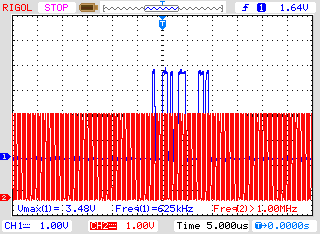

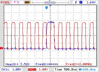

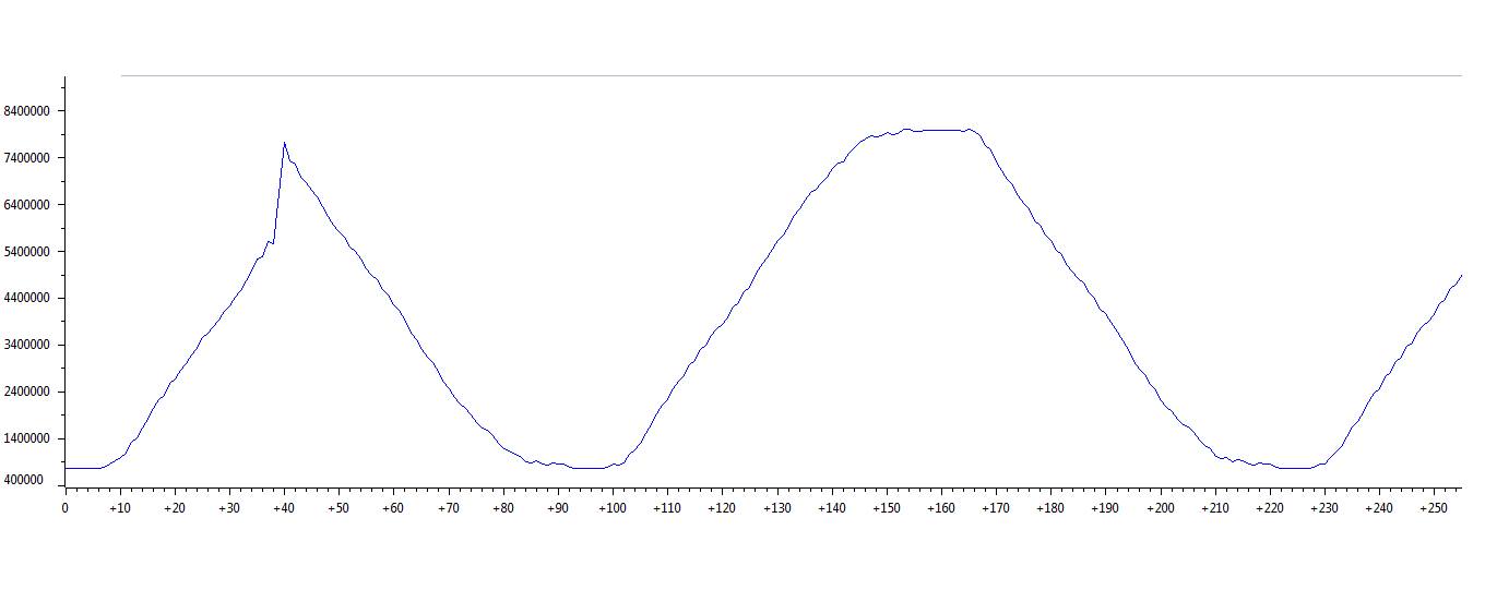

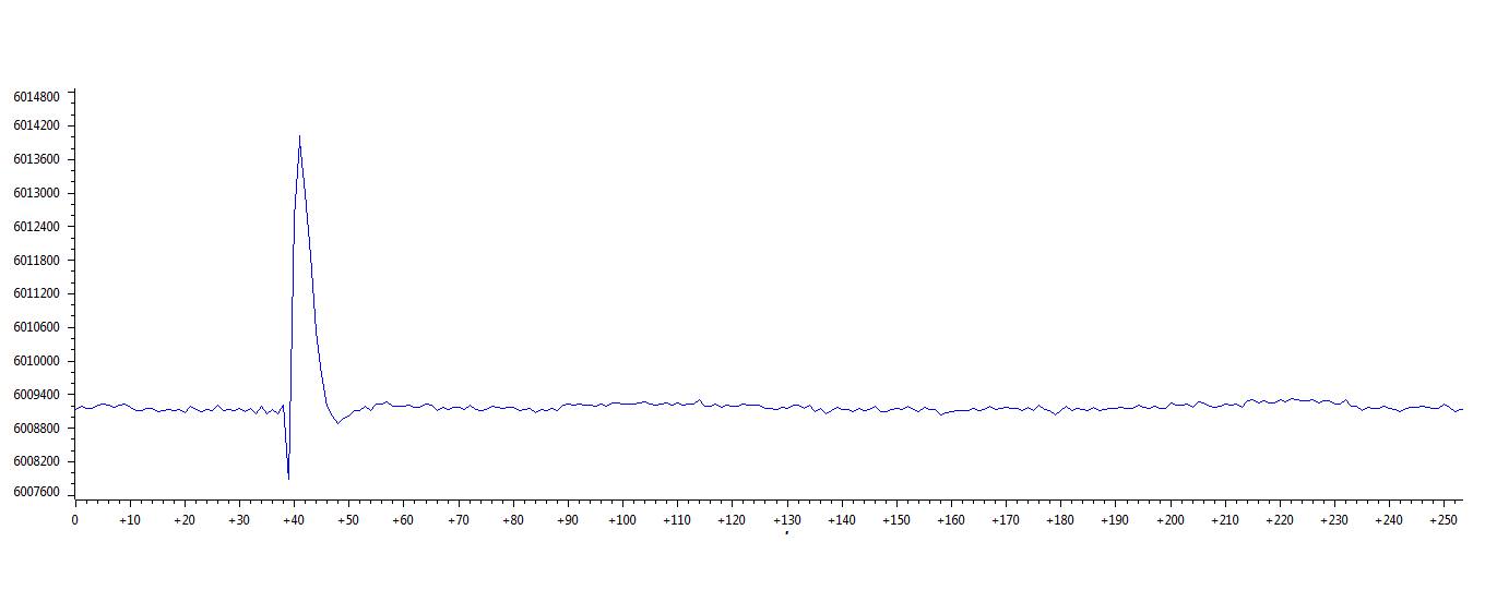

I am interfacing ADS1278 EVM-PDK  with Piccolo f28335 via MCBSP. F28335 provide CLK and FSYNC signals internally. CLK aprox 1.97MHz and FSYN=CLK/256 in low power mode. Apparently, communication occurs successfully but when I get samples and graph them in CCS strangely in aprox 40th sample a oscillation occurs. is  like the conversion restarts. Could anyone tell me why happen this and how do it solve it?.
These are some example of this.
1. Sine signal f=60Hz Fs=7709
2. DC Signal Fs=7709

    It seems like there is a timing violation that is causing you to miss data. Can you share a capture of the FYSNC interface signals? I can help you check it to ensure you are meeting all FSYNC timing requirements.

    The oscillation happens periodically each samples block when I do any processing between them i.e. FFT, but when I sample uninterruptedly in a infinite loop the oscillation happens only at the first sample block. At first, I think it had to do the invalid samples that the ADS1278 datasheet mentions, but sometimes only sometimes this phenomenon doesn´t happens. Could be any electromagnetic compatibility problem?
    The signals that you ask are here:
    Fig 1. CLK(red) Vs DOUT(blue)
    Fig 2. FSYNC (blue) Vs SCLK-CLCK(red)
    Fig3 y 4. FSYNC (blue) Vs DOUT (red)
