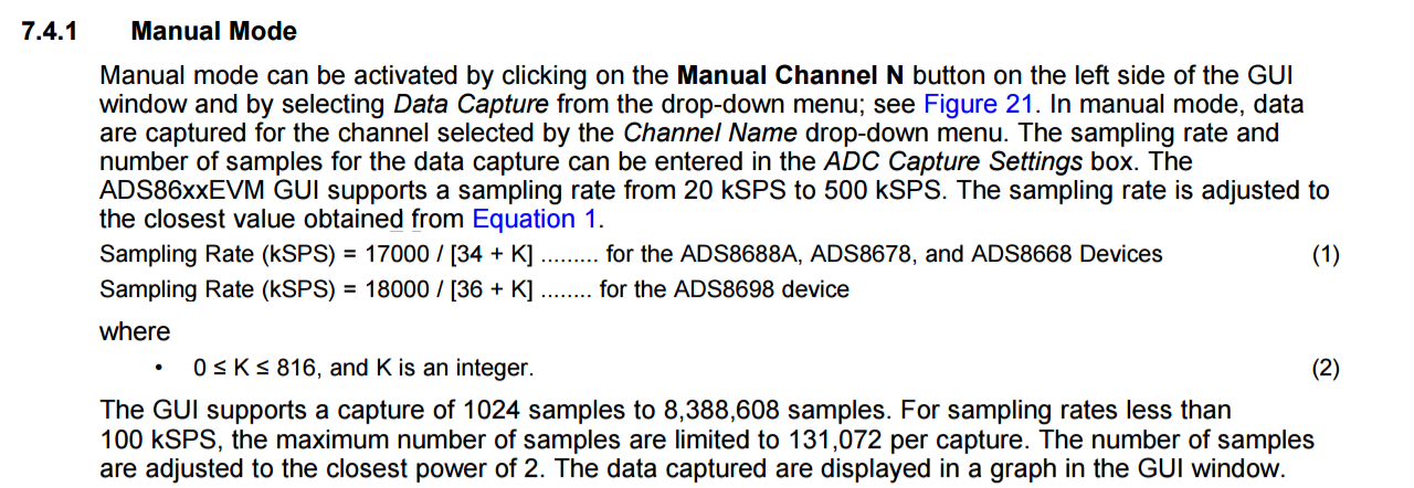

I am working on an ADC, it is the ADS8688EVM-PDK. I configured that with my pc, I installed the TI software, but I noticed that the software does not allow you to read more than 13k samples.  So I am wondering if it possible to go above this limit and keep reading data in real time until you want.
Thank you in advance.
  • Hi Michele,
    You could read 8 million samples from the GUI if you are operating at speeds greater than 100kSPS.
    This is explained on page 22 of the EVM user guide. I have attached a snap shot for quick reference.
    Rahul
  • Thank you for fast and clearly response. I didn' t think i could do that because, when i run the software and chose at a sampling rate of 500Ksps, I set the number from 131,072 to 131,073 samples, but, the software reset the value to 131,072.

  • Hi Michele,
    The number of samples is adjusted to the closest power of 2. If you entered 131073, it will be adjusted to 131072.

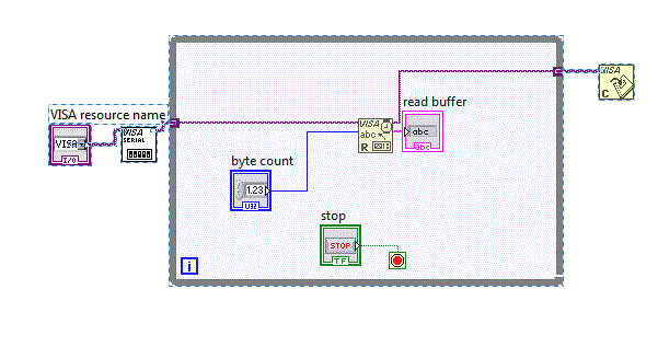

  • Thank you Rahul, sorry for the delay.
    I tried to use a serial communication using Labview, in particular I used the VISA resource name, but when i tried to select the Port from the VISA list box               I didn' t manage to select the PORT; when I went to Device Manager of Windows i noticed that the computer didn' t recognised the ADC as a flash drive.
    I will send you a screen of Device Manager as soon as possibile
    This is the diagram block. It works. I used it with an arduino.

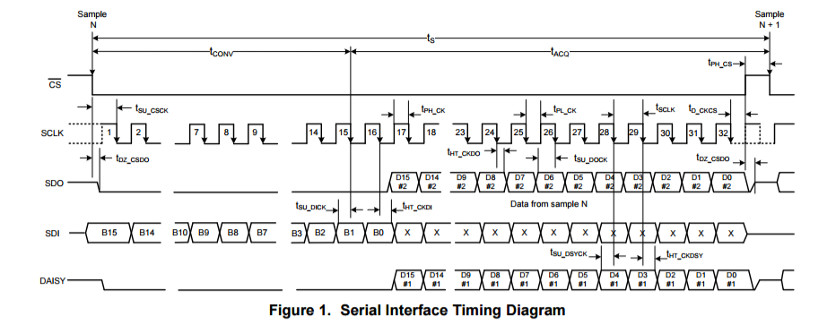

  • Hi Michele,
    The host controller needs to generate a timing pattern as shown in the figure below.
    The clock frequency in this pattern is maximum 17-MHz. Hence a controller capable of generating this SCLK rate will work for this application.
