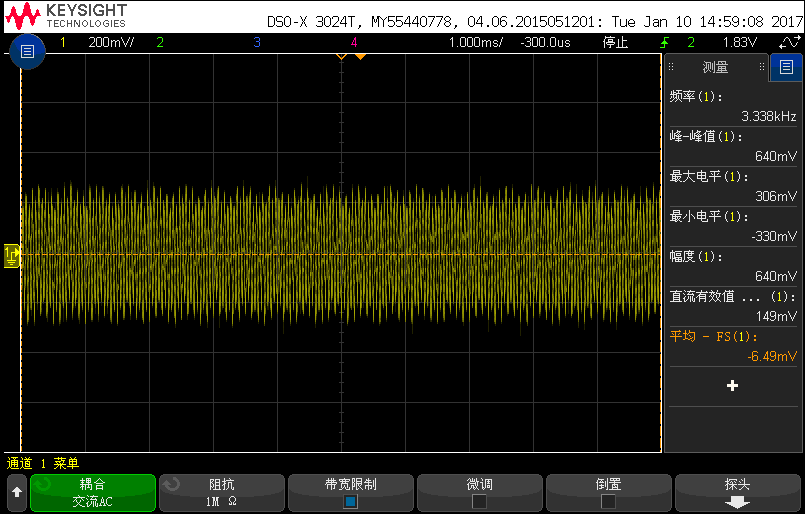

Issue 1: the ripple of the BOOST is too big.
We boost 6.5V to 12V to supply power to the VEXT. The ripple of input 6.5V is less than 100mV, while the output ripple is about 650mV .
Input ripple:
output ripple:

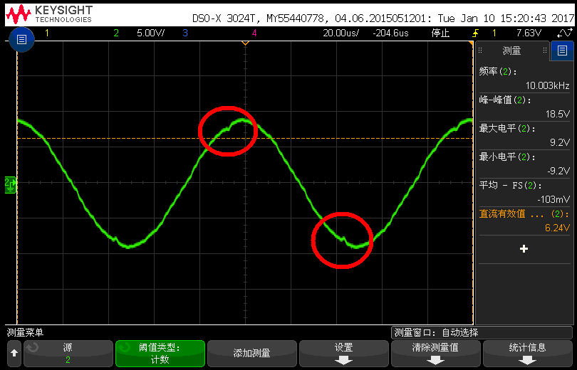

Issue 2: the output of the exciter-amplifier distorts.
As the graph below shows, there are two peaks in the red circle every cycle. And the sine degree of the wave is not good.
Wave of OE1:
Wave of OE(differential wave)

    Issue 1: I'll address this once I hear more details about the set-up.
    Issue 2: It looks like you don't have enough room between the power supply rail and the positive peak of the OE signal. Try increasing the boost voltage and some of the distortion should clear up. The distortion will also be worse for higher loads, so I am curious what load you are using. Also, I can see the ripple from the boost in your OE waveforms, so once we reduce the ripple, the waveform should look cleaner.

    1.We are using our own demo board for the tests, we design the board according to the TIDA-00796 reference design.
    The boost circuit has an inductor of 47uH/2.5A and two 4.7uF/25V/X7R ceramic capacitors and one 0.1uF/50V/X7R ceramic capacitor.

    - Is the distortion on the OEx signals still happening when you change to 4VRMS mode? In 7VRMS mode, the 12V boosted voltage may be too low, which would cause some distortion.
    - Like the TI Design, do you have the footprint for the diode between GND and the VSW pin? Adding this diode sometimes helps with this type of issue, so please try to add it if possible.
