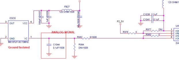

Customer uses DAC8531.
It is not working properly in a low temperature test.
Setting DAC at low temperature is output 0V.
It is an abnormal operation.
The low temperature test temperature is -30 degrees.
SPI operates normally at low temperature(-30 degrees).
We are testing the chamber.
Raising the temperature will normally work.
What is the solution?
I would like a guide.
It is a circuit diagram of a customer.
Thank you

    It occurs when setting the value of DAC 8531 at low temperature.
    Output problems occur only at low temperatures.
    When the temperature at low temperature goes up, it is normal operation.
    When set to spi at low temperature, the output will be 0V.
    In this state, when the temperature is raised, the voltage of VC is gradually high (up to about 200 to 300 mV)
    It is the output is instantaneously normal.
    The reference voltage is 2.5V.
    It was confirmed that Reference Voltage 2.5V was maintained at low temperature.
    In normal operation, if reference_voltage is set to 2.5 V, the output level is 1.42 V.

    At 95% humidity, there is a very high chance of condensation on the board that can lead to shorting of small-footprint device pins. I have seen this many times myself. In fact it is very difficult to measure humidity accurately beyond 90%. When they say 95%, at some locations inside the chamber, it may actually be 100%, especially near metal parts like device pins etc.
    One solution is to reduce the humidity during your testing, in case it is not part of your test specification itself.
    Another way is to cover the fine pitch pins by some kind of a sealant like conformal coating or silicone or epoxy glue. If you can do this coating on the DAC and the output oscillator, we can rule out the possibility of the condensation induced failure case.
    I am suspecting two points where shorts can happen: between pin 1 and 2 of the oscillator or pin 4 and thermal pad of the DAC. Both these conditions can lead to a failure condition we are observing.

  • DEAR.Uttam
    when CAP(C1044) is deleted at low temperature, confirm the normal operation.
    I do not know the exact cause of CAP(C1044).
    I want to know how CAP(C1044) affects DAC8531.
    Please explain.
  • Dear Henry,
    I couldn't understand your point. Let me reiterate and please help me understand:
    1. When you remove the capacitor C1044 and test it under low temperature condition the system works fine
    2. You want to understand the impact of this capacitor on the DAC output.
    As per the datasheet, you should not use a capacitor of this large value in order to get a stable output. There is no mention about how it may behave under extreme temperature conditions. It will be difficult for me a get exact characterization data as this is a very old part. Let me check with the design team and get back on this.
    However, even at normal temperature capacitor of this value is not recommended to be used directly with the VOUT pin. You must use some compensation circuit in order to use it. A simple compensation circuit can be implemented by using a proper non-zero value for R982. However, you can use a better compensation circuit as the VFB pin of the output amplifier is available.
