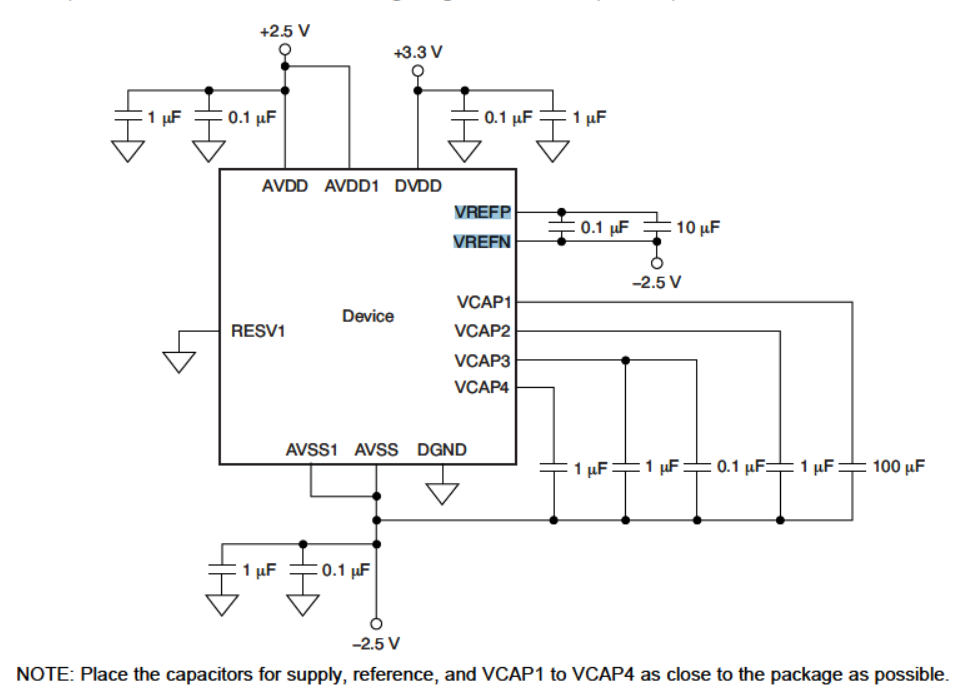

  • Hello Ming,
    Can you send me your schematic? Also, what is the voltage between VCAP1 and AVSS?
    Brian
  • Thank you for replying me. Now the problem of Vrefp is resolved and the Vcap1 is above 1.1v. But the output data of ADS1299 is still 0x00h is continuous mode, while the registers can be read correctly. But in single shot mode, the output is not stable and the data is unreliable. I use the STM32F7 series ARM and the code is below. Would you please help me?

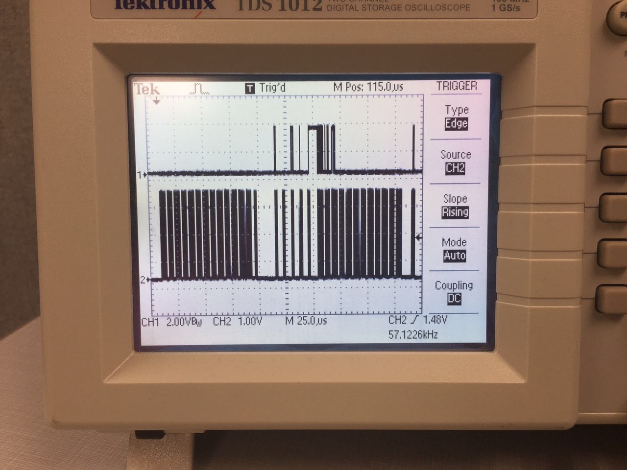

  • Hello Ming,
    Could you capture the SPI signals during data capture with an oscilloscope or logic analyzer and post them here?
    Brian

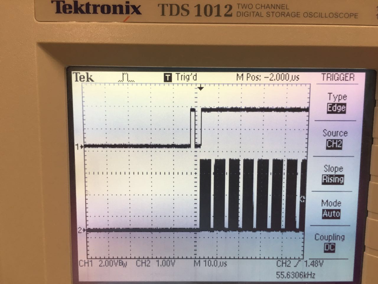

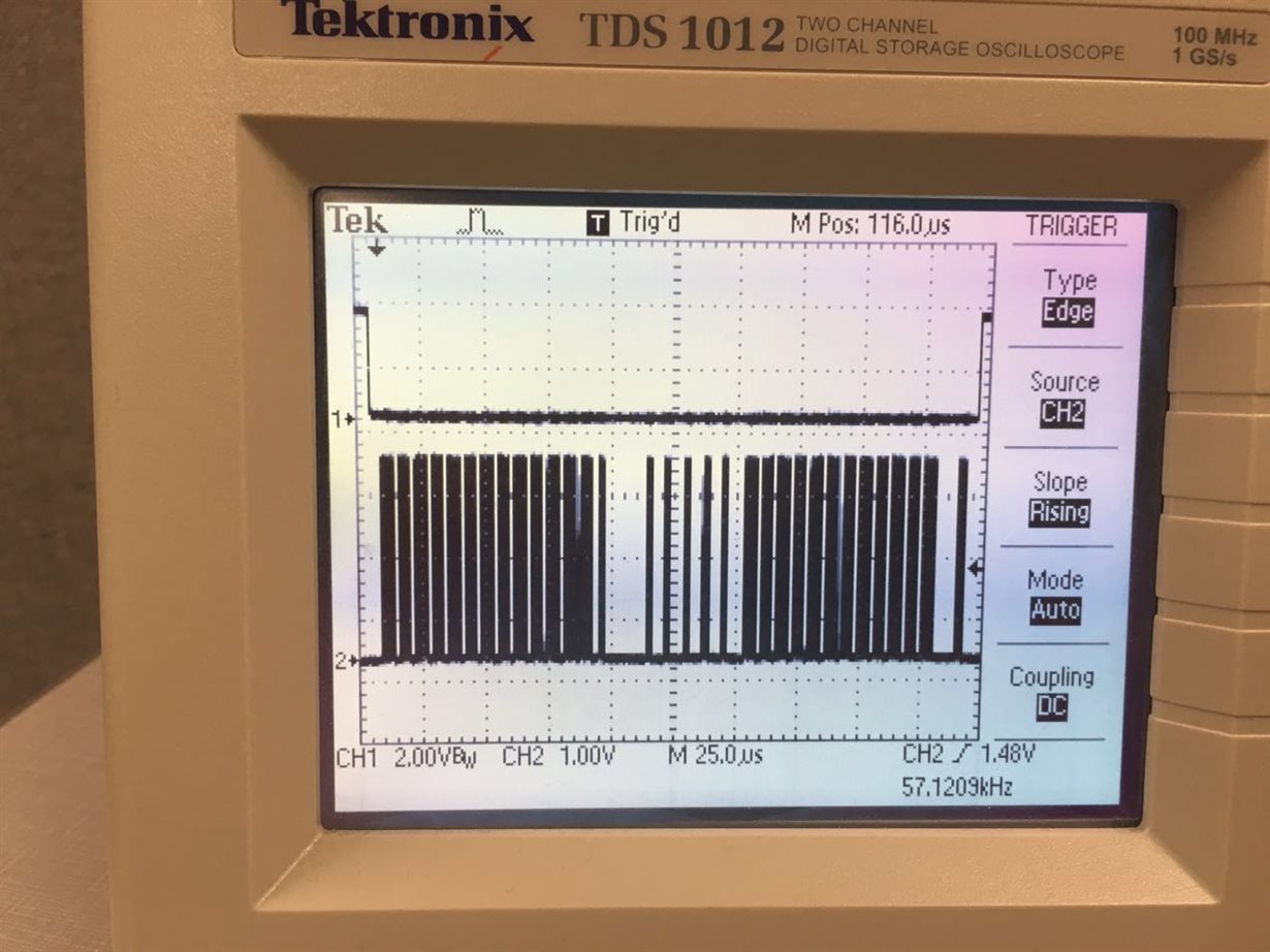

  • Sure. the photo of oscilloscope is below:  The first picture is SCLK and CS signal,the upper is CS wave and the lower is SCLK signal. The second is SCLK and MISO signal,the upper is MISO and the lower is SCLK. The third and fourth picture are SCLK and DRDY signal,the upper wave is DRDY and the lower wave is SCLK. Thank you.
  • Please look at the third picture, the first 27 data is reading the voltage and there are all 0x00, and the next data is reading the register of ADS1299 and it is correct.

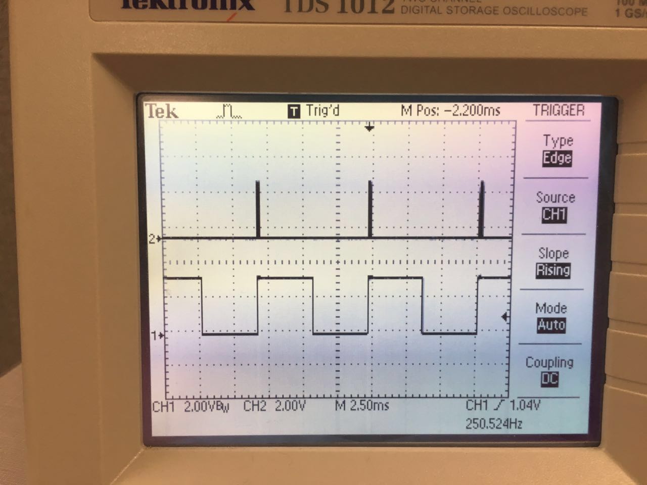

  • This picture is SCLK and DRDY in a longer time. the data conversion rate is 250hz which shows in the oscillator. It is stranger that the DRDY signal is pulled down in the middle of the period.
  • Hello Ming,
    The data transfer sequence looks to be correct. Would you mind posting a list of the register settings you read back? I want to make sure everything is enabled properly.
    That DRDY and SCLK relationship you show seems correct. DRDY will transition from high to low at the data rate. This will happen independent from any communication from the master, but will follow the data rate settings in the registers. DRDY will come back high on the first falling edge of SCLK.

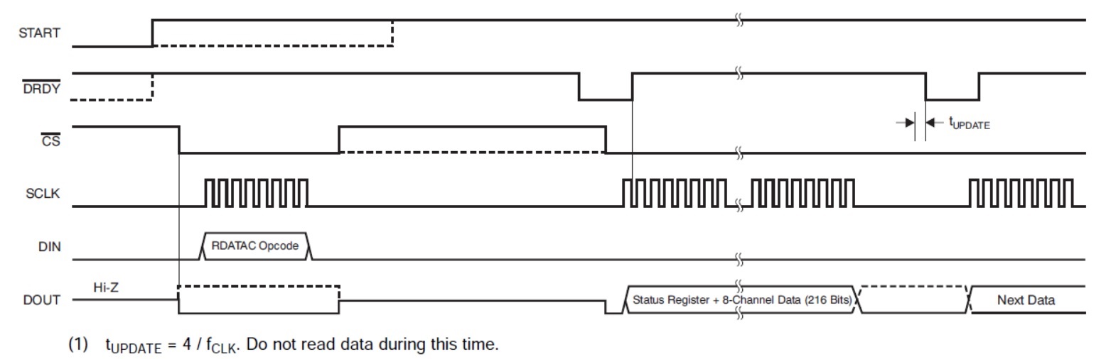

  • Hello Ming,
    Have you sent the RDATAC command before you try to retrieve the data without the RDATA command? The RDATAC command will enable the conversion to be loaded into the output shift register automatically. This could explain why you are able to read data with the RDATA command, but not otherwise.
    When you say the data is not "stable", what do you mean? Can you share some of the data you've collected?
    Brian

  • Hello Ming,
    In the picture you sent a few days ago, there was one where you read the register data immediately after attempting to collect data. Did you also send the SDATAC command before you read that register? You will not be able to read the registers without having previously sent the SDATAC command. If you did not send the SDATAC command, but were still able to read the register, it may indicate that you were never in RDATAC mode at all.
    Brian
  • Hello Pisani,
    I really read the register data immediately after attempting retrieve data from AD,but I never sent SDATAC command to the AD. The only operation that I sent SDATAC command to the AD is just after power up and before the initialization of the AD. You mean that the register can be read only in SDATAC mode? I do sent the RDATAC command to the AD and the /DRDY pin is pull down at the right sample rate. How could it happened? And how can I enter RDATAC mode? I sent the RDATAC command to AD after pulling up the START pin or sending the START command, isn't it correct?
  •   Hi Pisani,
    I do a test after reading your reply and you are right. When I send the RDATAC to the ADS, I can't read the registers. The register can read after I sent the SDATAC command. So what is the matter. I sent the RDATAC command and the /DRDY pin toggle but can't read the voltage data, while I can read the registers.
    I am almost crazy for that.
  • Hello Ming,
    Thank you for your patience as we work to try and determine the source of the issue.
    So we've determined that the RDATAC command does prevent reading registers. So in your image that you posted previously where you collected data and then immediately read the register, this means that the device was in SDATAC mode. We can conclude this because if the device was in RDATAC mode, you would not have been able to read the register.
    In that case, we can agree that for that particular test, the reason you could not read data was due to the fact the device was in SDATAC mode. This is because when the device is configured in SDATAC mode, the data does not load automatically into the output shift register. Have you tried to send RDATAC and then collect data?
