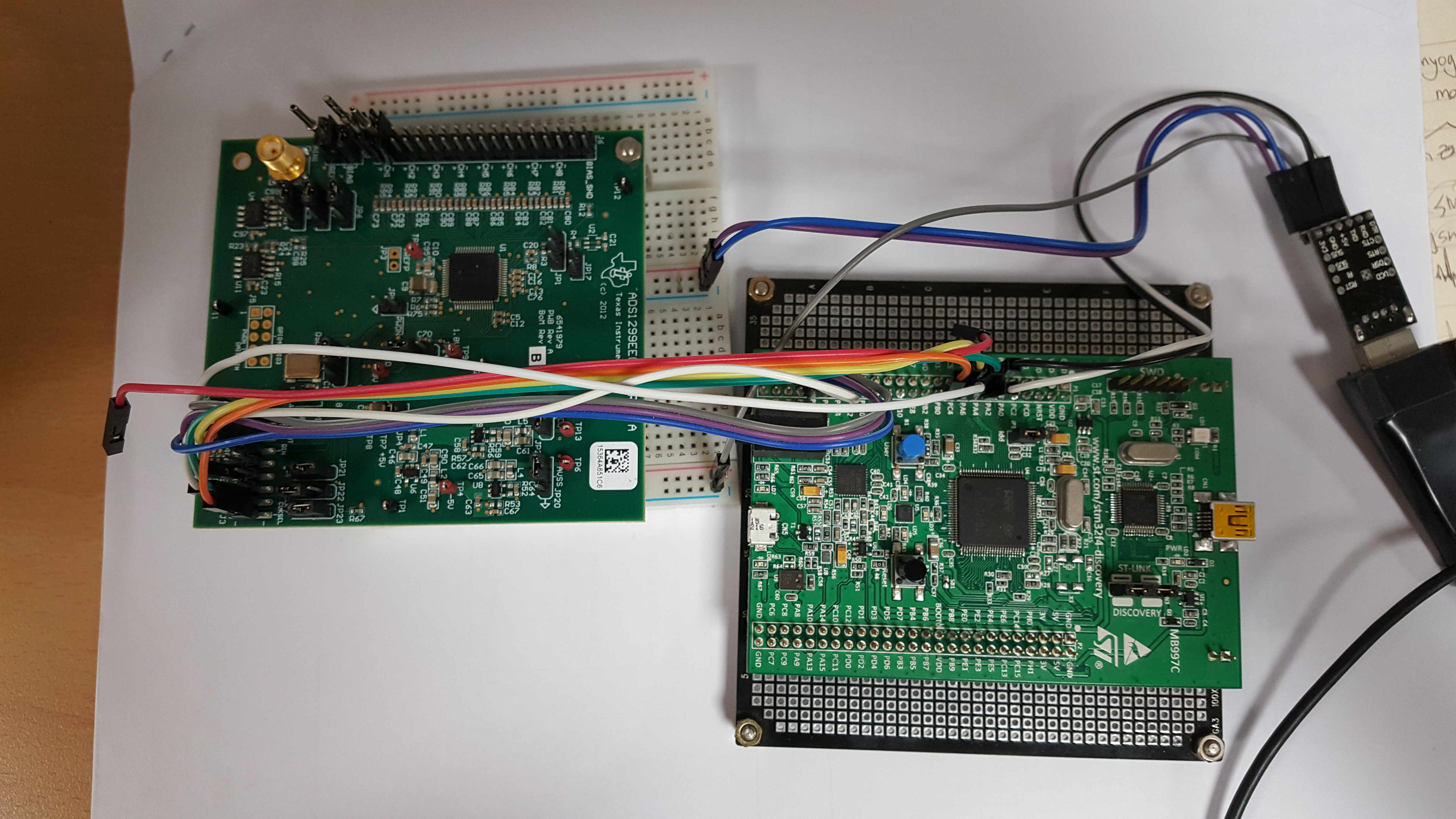

hi, I'm developing a simple prototype to read EEG signals using the ADS1299 develop KIT.
however, there is a problem with the development process and i have questions regarding this problem.
If only the signal is given to CH 3 as shown below, noise signals are generated in CH4 without a signal.
i want to know why this happens.
thanks.

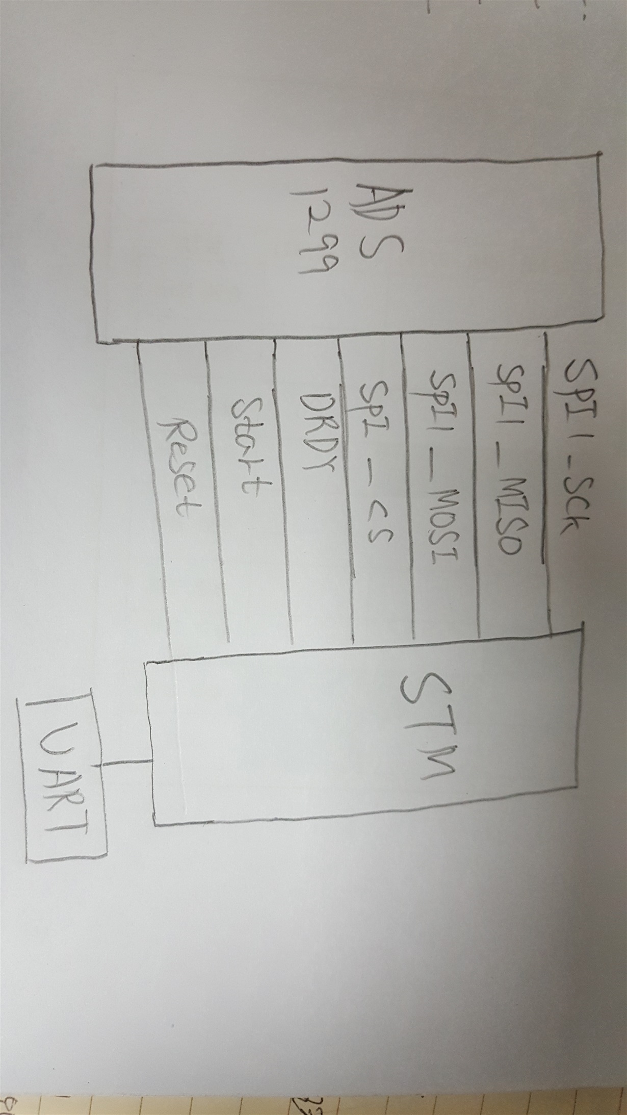

  • Hello Rechard,
    Thanks for your post.
    Can please share some additional information? Please include the complete register settings for the ADS1299 and a diagram of the input signal connections.

    2. diagram of the input signal connections.
    I will attach a picture.
    I'm sorry. Modify the question.
    Noise does not occur on only 4channels.
    Noise occurs on the channels below of the measured channel.
    For example, if I measure a signal to channel 1 causes noise on channel 2, and if I measure the signal with Channel 2 causes noise on channel 3.
    therefor when measure a signal to channel n causes noise on channel n+1.
    The picture that you put on the first question is the signal that came out of the filter. I will attach the measured data values without using the filter.
    thanks.  ads1299_output_error.txt
    from Richard Oh
  • Hello Richard,
    What channel was used to produce the data in the attached file? And what was the input signal and register setting for that channel?
    The only values I see are 0 and 65,536. Are you handling the data correctly? Remember that the output of digital filter is in binary two's complement.
    According to your picture, the input pins of every channel appear to be floating. When you evaluate any of our devices, it is important to apply an input signal to the pins so they are not floating. Otherwise, please configure the unused or powered-down channels as an input-short (i.e. MUXn[2:0] = 001).
