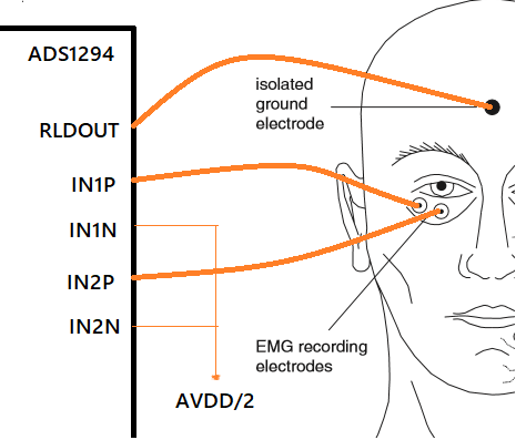

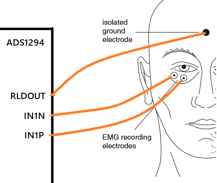

I would like to use ADS1294 to make a project which constist on sensing eye blinking but I have some questions:
1) As regard to connection, I have two options:
a-
b-
I am considering to use an unipolar supply (0V - 5V), so I dont know if the two options are correct and which one is the best with this supply method. Could you help me?
2) In two pictures, I connect RLD electrode to RLDOUT but I read that it can connect to RLDIN and then this signal can be rerouting to any of channel input. What are the differences? Any advantage?
3) As regard to isolate the device from the human body, an optoisolator is recommend. Are they necessary in all inputs or only at RLDOUT? Do you have any CI to recommend in TI?
4) Before channel input, I am thinking to use a band pass filter (Low pass filter: 500Hz and High pass filter:28Hz). Is first order filter enough?
Thank you.
  • Hello Juan,
    Thanks for your interest in the ADS1294!
    While we're not the application experts, I can try to guide you with the following recommendations below:
    1. The answer to your first question really depends on whether you need the unique information that is sensed by each electrode input. If you only care about the differential voltage, then you could reduce the number of required channels and potentially design a cheaper solution. The single-ended approach (technically "pseudo-differential") with INxN tied to mid-supply will also work. Ideally, RLDOUT will be centered around the same mid-supply, so the differential voltage will be centered around 0V while allowing you to still use the ADC's full-scale range. You could always measure each electrode independently with two channels, then subtract the results in post-processing if you also care about the differential voltage.
    2. RLDIN can be used to route the RLDOUT signal into the input MUX and out to one of the channel input pins. At that time, the input pin becomes disconnected from the internal PGA. This is useful when the RLD electrode is disconnected. A simple register change can reroute the biasing signal to the body temporarily until the RLD electrode connection is restored. Also, RLDIN can be used to directly measure RLDOUT against mid-supply to check the common-mode signal that is driven to the body. This would disconnect the PGA from the INxx pins once again and use the MUX to route RLDOUT to the selected channel.
    3. I'm not sure about this one. We really don't have much experience when it comes to isolation techniques used in medical systems. I don't believe this technique is absolutely necessary, however, as long as you have sufficient protection circuitry in place. This would include current-limiting resistors and clamping diodes to protect the patient and the measurement circuitry from over-voltage and momentary increases in DC current.
    4. The filter is really up to your application requirements. I think many customers can remove the DC content in the digital domain with a higher-order high-pass filter, which is easier to implement than in the analog domain. The analog low-pass filter could be increased to a second order - many times multiple R-C pairs are used to increase protection while providing extra filtering at the same time. The signal bandwidth, again, is up to you, but the important detail for your filter design is that it should provide sufficient antialiasing by the ADC modulator frequency (fMOD). This is where the digital filter respond returns to unity-gain (0 dB) and noise can alias back into your signal bandwidth. See Figures 52-56, where fMOD is either fCLK / 4 or fCLK / 8, depending on the mode. A second-order low-pass filter at 500Hz would give you -120dB attenuation at 500kHz, which I think is more than enough. You could extend the cutoff further to 5kHz so as not to interfere with your signal bandwidth, or use a simple single-order filter.
    I hope that helps!

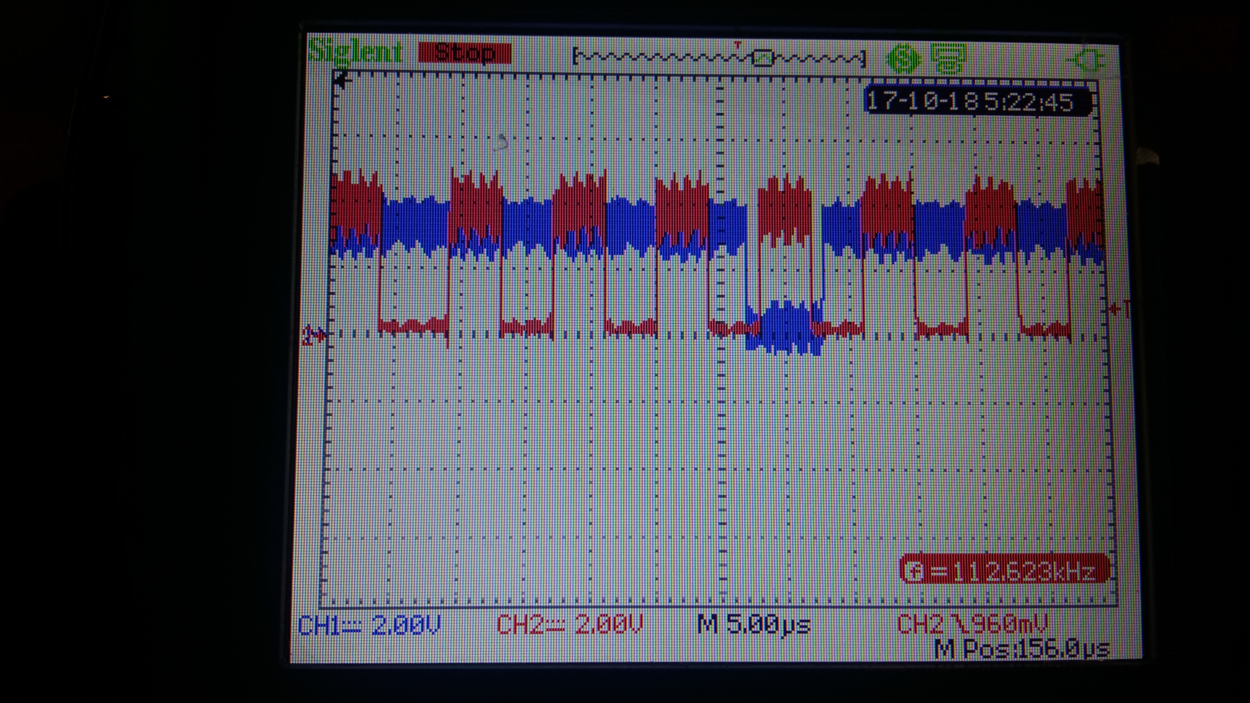

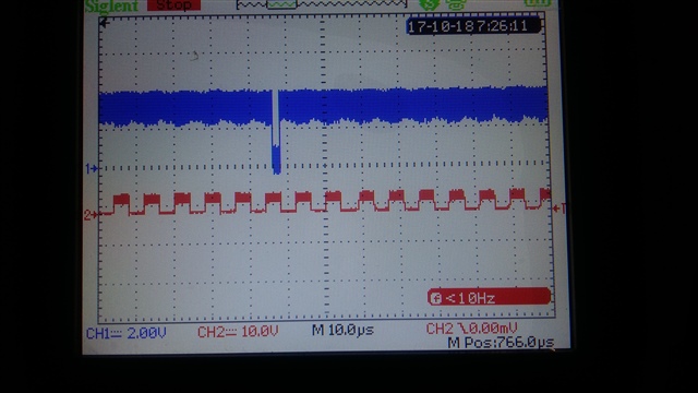

  • Hello Ryan,
    As regard to my last answer, I can solve some problems and I read back registers with RREG. However, the device isnt working well.
    1) I measured clk pin (I am using internal clock oscillator) and I could see a frecuency signal of 2Mhz but isnt rectangular,  it had a lot of distortion. It depend on osciloscope bandwidth?
    2) If I make a new code in which I only do start up secuency and tie start pin to HIGH, what should be frecuency signal in DRDY pin?
    Thanks you again.
    Juan
  • Hello Juan,
    If START is tied high to DVDD during start-up, then /DRDY will begin pulsing at the default data rate (500SPS).
    One trick to probing clock signals is to use the shorted ground wire possible for your probe. Also, try probing the clock as close as possible to the CLK pin and connect the ground wire to the nearest point.

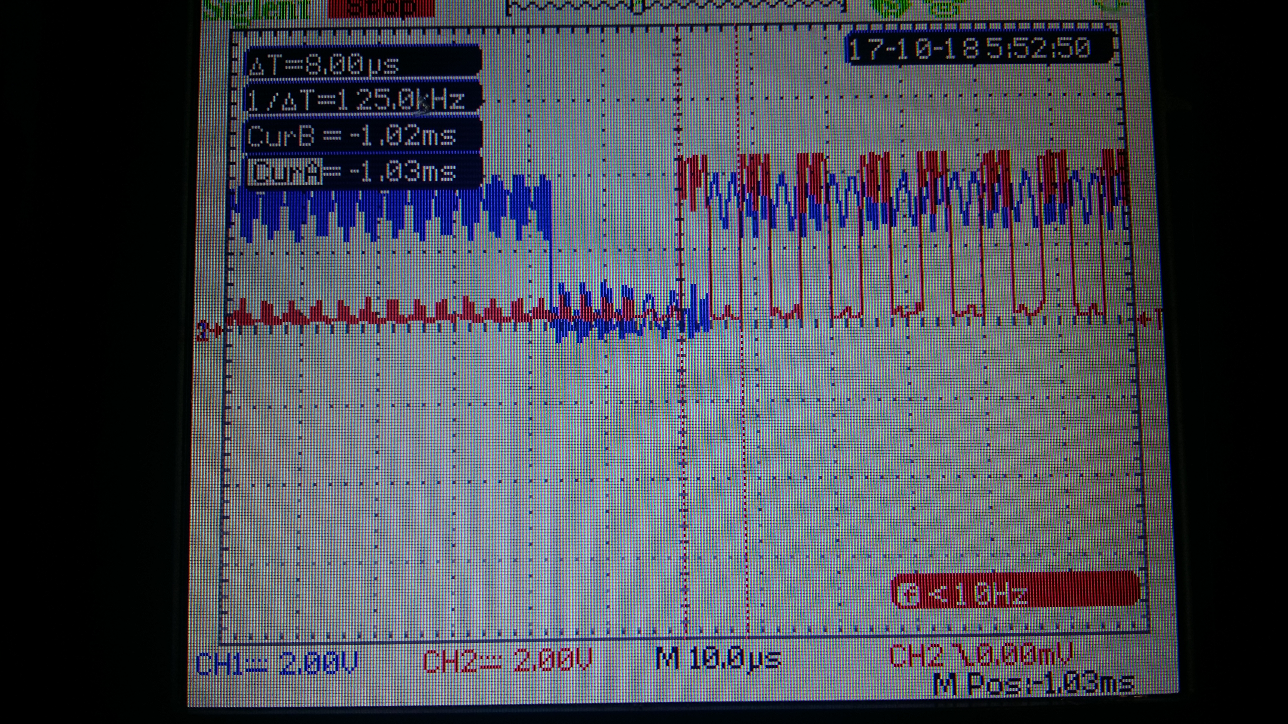

  • Hello Ryan,
    Thanks for your last answer.

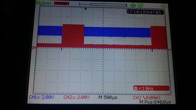

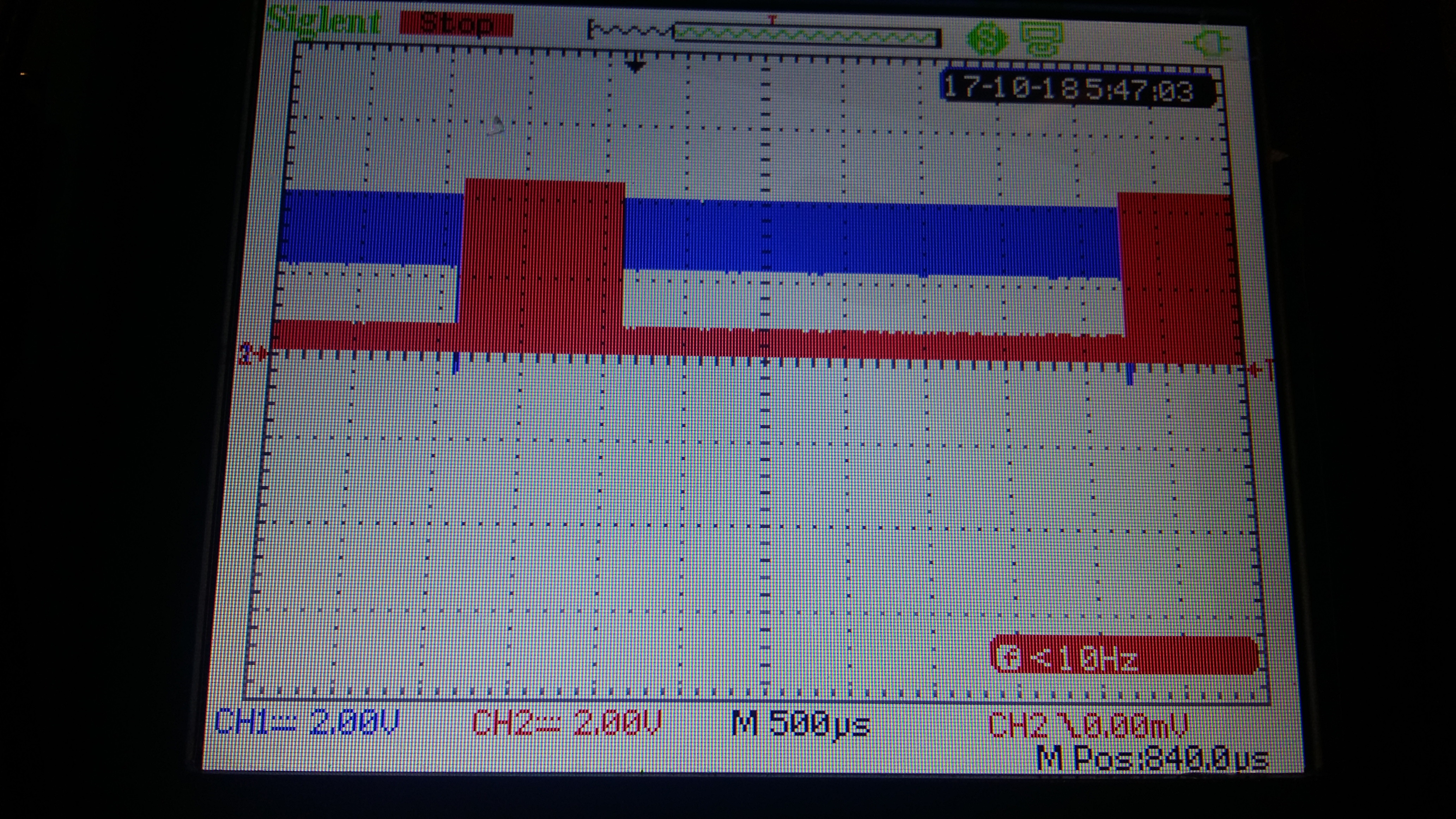

    I am seeing a little progress in my project. In this occasion, I have a punctual doubt.
    First, I started the device with default settings and I could see:
    CH1 - BLUE - DRDY
    CH2 - ORANGE - SCLK
    I measured time between two DRDY pulse and this agree with 250sps. In addition, I could count 120 SCLK pulses (24 status bits and 4x24 channel bits). Have signals a lot of noise?
    Then, I tried changing the mode to HP and the result doesnt match with datasheet. DRDY signal changed according to the new data rate (500sps) but SCLK have the problem showed in the following images, it isnt synchronized with DRDY falling edge and there are more than 120 pulses. So, I came back to the beginning with default settings but  the problem with SCLK still there, (The images below are with default settings)
    I hope you can help me. Thank you again.
