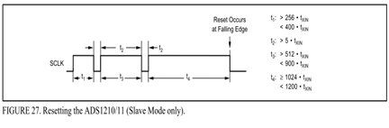

I have found that the reset timing that is defined at "old data sheet" is different from the latest one as below.
The old one needs "3 pulse" to reset. But the latest one need "2 pulse" to reset.
< old >
< latest>
Let me ask you 2 questions,
Q1) Why was the reset timing changed?
Q2) In case of using the old timing, what will happen?
       Is it OK to use old timing?
