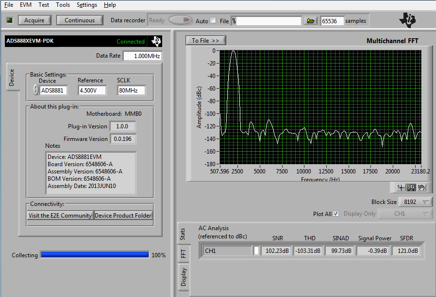

Hi,I meet some problems while test the ADS8881 EVM in lab
I used two test board:
  • PSI(Precision signal injector) + ADS8881 EVM + ADC pro
  • PSI(Precision signal injector) + ADS8881 EVM2 + EVM GUI
The problems are as follows:

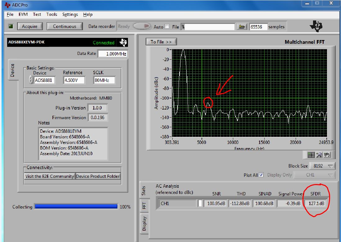

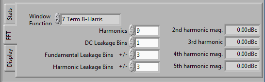

    • How to set the FFT? I find Fundamental Leakage Bins, harmonic leakage bins influence SNR and THD a lot
    • The SFDR in the attachment “1-ADC pro > SFDR” seems not correct
    • Does the PSI just use for output 2kHz? While output 1kHz or 3kHz, the SNR result is very bad(52.9dB@1kHz,  72.9dB@3kHz)
Now I have AP525, but I didn’t have differential BNC to SMA cable. So do I can just use PSI@2kHz to do the test? How if I want to adjust the input signal frequency?

How to set the following parameters?
Harmonic leakage bin=0, THD=-112.8dB
Harmonic leakage bin = 3, THD=-103.31 dB

  • Hi Marc,
    The ADS8881EVv2-PDK is the new evaluation kit developed on the compact PHI board controller. It replaces the legacy ADS8881EVM-PDK based on the MMB0 platform and ADCPro.
    In the case of the new ADS8881EVMv2-PDK, the FFT spectrum analysis tool uses by default the 7-Term Blackman-Harris window and the software automatically applies the appropriate leakage bins; providing also an accurate measurement of SFDR.
    As you have mentioned, when using the legacy ADS8881EVM-PDK ADCPro, the leakage bins must be set manually. On ADCPro please select the 7 term B-Harris window and the window leakage pins should be set as 7 DC leakage bins and ±7 fundamental bins and ±7 harmonic leakage bins.  More details about FFT windows can be found at:
    http://electronicdesign.com/analog/choose-right-fft-window-function-when-evaluating-precision-adcs
    In order to obtain the expected FFT performance of the ADS8881, a very pure sinusoidal signal must be applied. The PSI (Precision Signal Source) provides a very pure, low distortion, low noise signal at 2KHz. It accomplishes this signal purity by using an audio DAC cascaded with an 8th-order Bandpass filter tuned at 2KHz.
    On the PSI (Precision Signal Injector), it is possible to override the 2-KHz Bandpass filter, and test other frequencies; however, since the 2kHz Bandpass filter is not present, the quality of the signal is degraded; and as a result the ADS8881 will not reflect the expected FFT performance. If you require test AC performance at other frequencies; I recommend using a fully-differential, high performance signal generator. In the case of the Audio Precision, the best performance is obtained by connecting the balanced output of the AP to the SMA inputs of the EVM with properly shielded cables.
    If you wish to override the Bandpass filter in the PSI board, JP1 and JP3 jumpers need to be moved from the FLT position to the BP position. The image below was taken from the ADS8900 user guide showing the PSI jumpers. Please note, performance will be degraded in comparison to the 2khz filtered signal.

  • Hi Luis,
    Thanks so much for your detailed reply.
    I select the 7 term B-Harris with 7 DC leakage bins and ±7 fundamental bins and ±7 harmonic leakage bins.
    The result under PSI@2kHz is as follows, SNR is 110dB, even higher than the datasheet, may not accuracy enough.
    It seems ADS8881 EMV2 + EVM GUI is better than ADS8881 EMV + ADC pro.  So I'd like use the former one to do the following test.
    How about your opinion?
    Thanks again.
    Marc

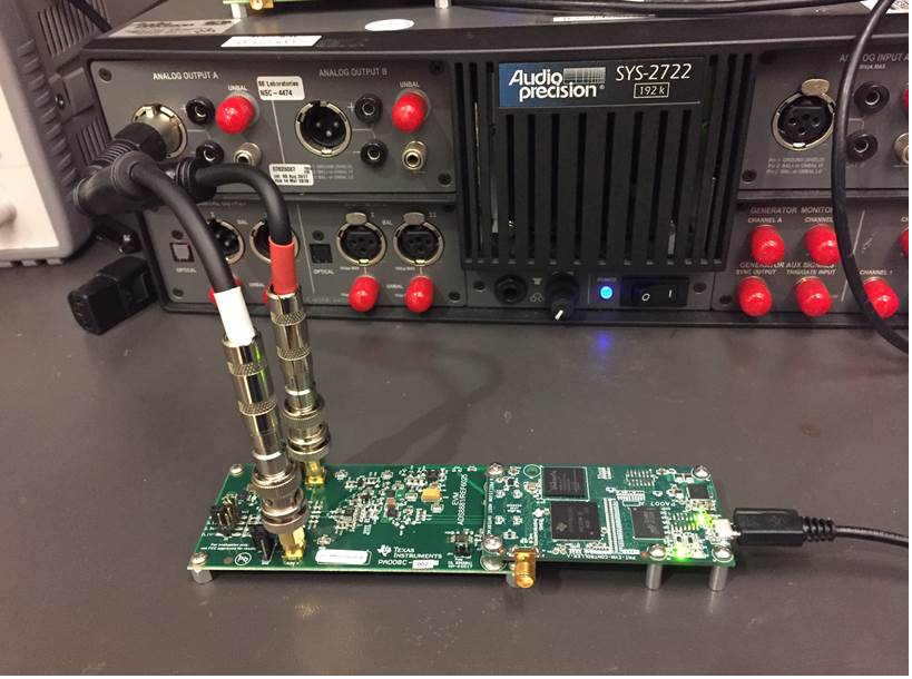

  • Hi Marc,
    Please see below, I have previously tested a new ADS8881EVMV2 using the AP SYS-2722, connected with the XLR balanced output to the SMA inputs on the ADS8881EVMv2 through the shielded cables.  Please see pictures of the set up and FFT results below meeting SNR=99.1dB and THD=-121.5dB.
    I used Fin=1kHz to make a distinction from the PSI board (2kHz).
    Thank you and Best Regards,
    Luis Chioye
