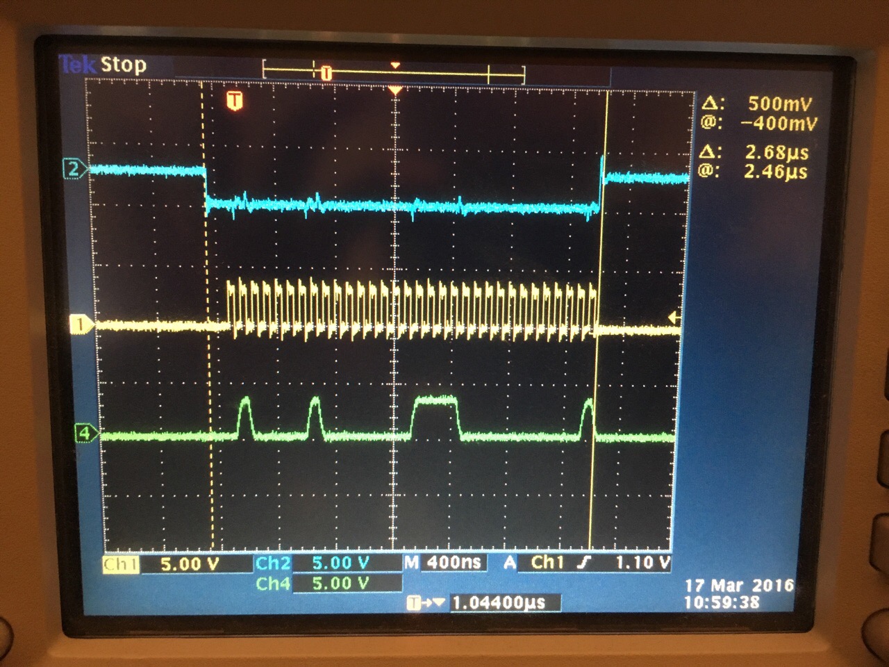

  • Hi Clancy,
    I have checked the NRESET pin, it is logic high.I tried toggling the NRESET and able to observe the transition from low to high.
    My C2000 Launchpad is at 3.3v. So I let the j3 to stay at 3.3V.(3,4) . I tried changing  j3 to 5v(5,6) but no response yet.  You can find the screenshot of the SCLK, NCS, and SDI waveforms below and the board connections. I am sending the SPI message to read DEV_STAT5 register as 0x4100F001.

  • Bala,
    It is interesting that in the GUI SPI read is working but not SPI write. It is not surprising that you are seeing faults since you do not have a resolver connected, but that should not impact SPI read/writes.
    From your waveform, it looks as if SDI might have too much of a load. Is there any capacitance on SDI on the Launchpad?
    Perhaps the level translator is impacting this. You might need to remove level translator U4. Of course, that would make it impossible to use the GUI anymore.
    I will find a Launchpad and run a couple of tests to recreate your set-up, but this will take me another few days. My apologies that this is taking some time to resolve.
    -Clancy

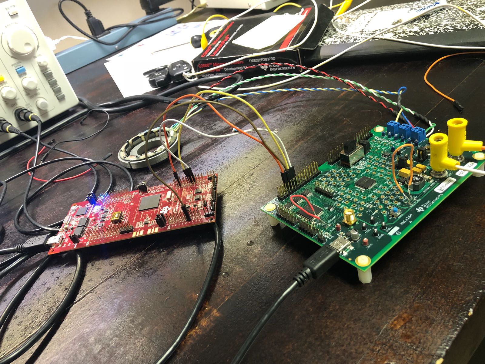

  • Hi Clancy,
    Thanks for the response.  Now I have made some modification to the EVM by shorting the switches S2and S4. Now I am receiving a constant response from resolver as 0x23 all the time irrespective of the transmitted message. I am attaching an image of my EVM here for your reference.
    Bala.
  • Hi Clancy,
    After shorting the above switches s2 and s4 , Now I am able to communicate with EVM correctly.
    Thank you so much for your help. Now I will be working with implementing application and let you know if I have any questions.
    Bala.
