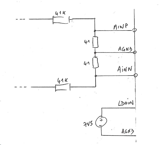

I'm using AMC1304L25 to measure DC+AC voltage, up to approx. 250V. Thus using large voltage resistor divider.
I designed a fully symetrical input stage to cope with issue described in section 9.2.2 of the datasheet.
I mean the sensing resistor is splitted in two and the middle point connected to AGND. This is slightly different from figure 56 of the datasheet.
But we are getting approximately -2.2% of error (measured at different voltage levels). Apparently a gain error.
Is it the right thing to do ?

  • Hi Tom,
    Thanks for answering.
    Yes, I had a look at this note.
    I'm using a rather low shunt value (2*41.2ohms) to keep gain error under control (about 0.3% as far as I understand).
    I was then surprised of getting a final error of about 2.2%.
    See below schematic. Am I wrong ?
  • Hi Alain,
    The sketch seems OK, what are you using for the digital filter on the AMC1304L25 output?

    I'm not proud to say that, after investigations, we found that the bridge resistor values (high voltage side) were not correct/expected values.
    After correction, the final error is less than 1%.
    I think we can close this topic.
