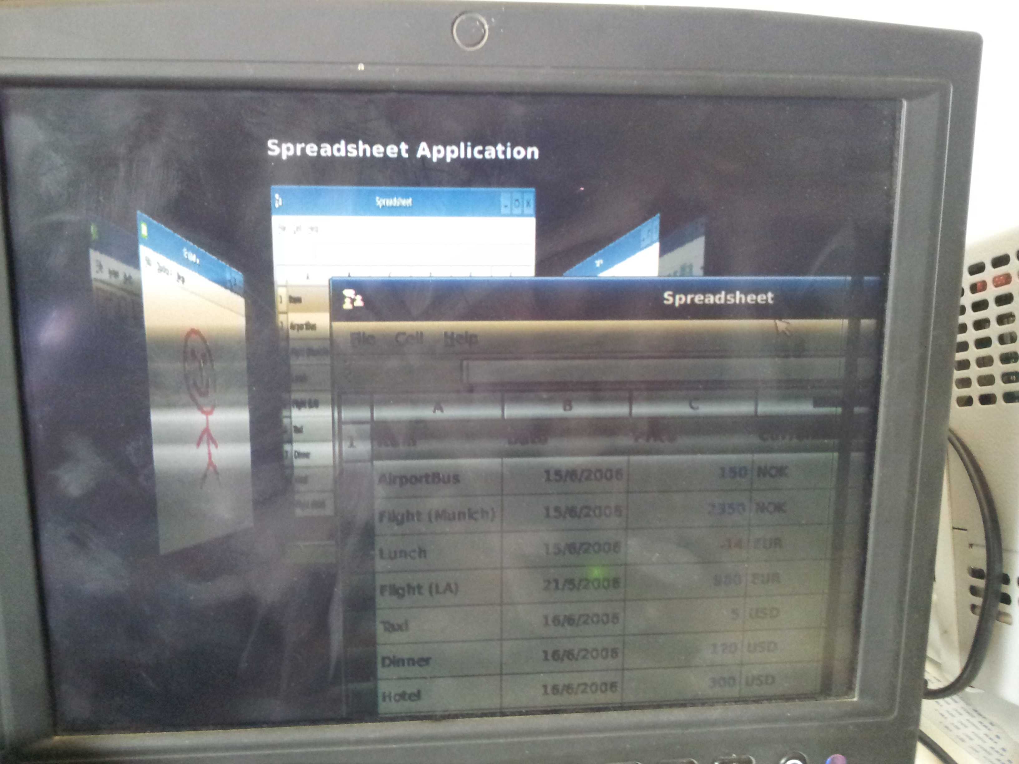

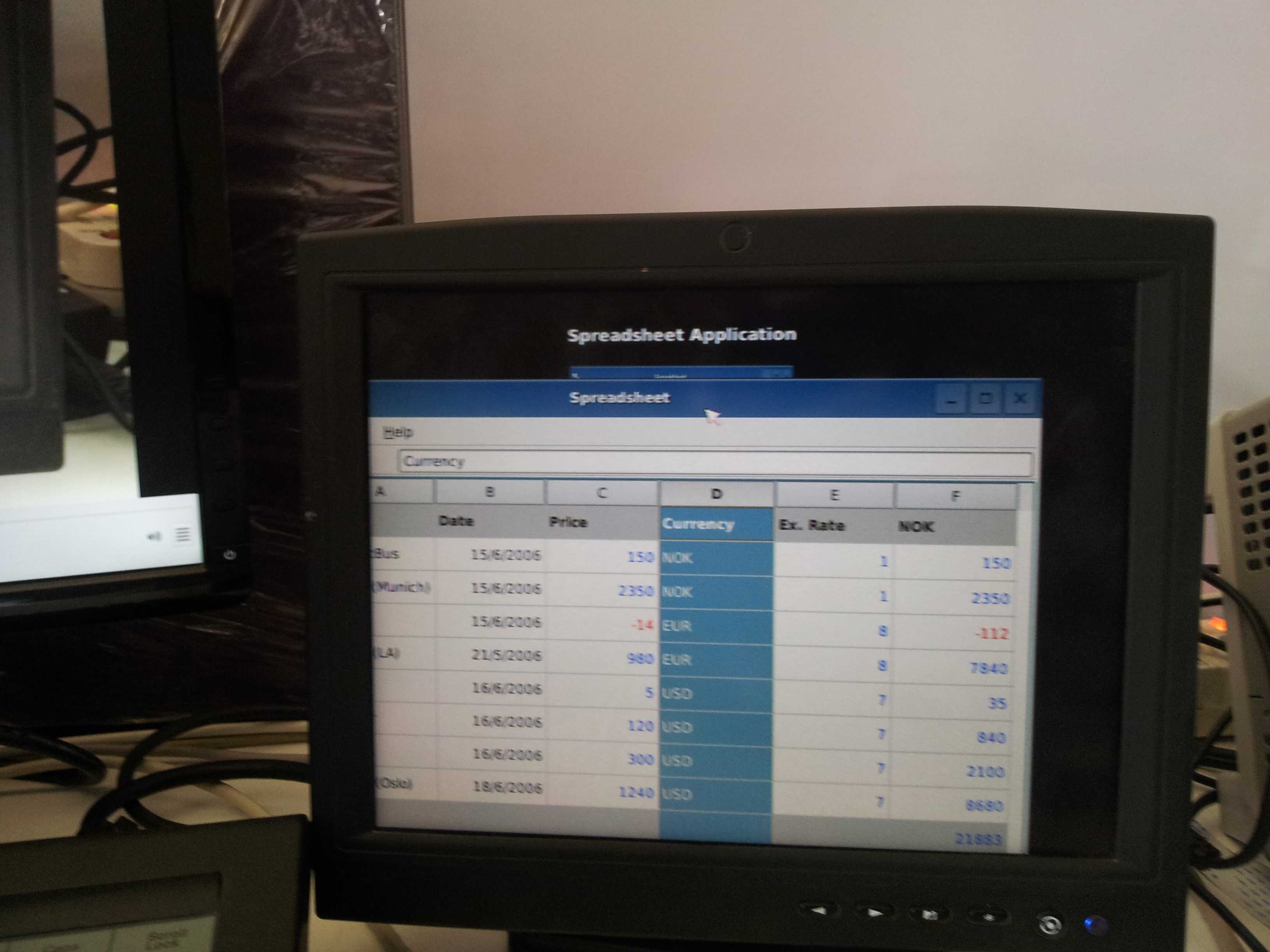

We are using THS8200 IC for converting LCD parallel signal to VGA on phyBOARD-WEGA-AM335x(SOC AM3359).
On VGA monitor we are getting on vertical stripe.
If i moves the QT application to that area, shadow is coming on the VGA monitor.
Please find attached jpg for problem.
I am using below XGA resolution.
XGA 1024 x 768 @ 60 Hz pixel clock 65.0 MHz
                                          Horizontal Timing (pixels)       Vertical Timing (lines)
Visible area                                     1024                                     768
Front porch                                      24                                         3
Sync pulse                                       136                                       6
Back porch                                      160                                       29
Whole line/frame                             1344                                    806
Bellow are the register values of THS8200 IC.
DATASET_NAME,"DMT ID: 10h, 1024x768 @ 60Hz, 48.363kHz, 65.000MHz, HS/VS -/-, RGB 444 DS>VGA, THS8200"
//THS8200
INCLUDE,THS8200_RGB_444_DS_to_VGA_common.inc
                                          register     value
WR_REG,THS8200,0x01,   0x34,        0x05 // dtg1_total_pixel_msb
WR_REG,THS8200,0x01,   0x35,        0x40 // dtg1_total_pixel_lsb
WR_REG,THS8200,0x01,   0x39,        0x33 // dtg1_frame_field_msb
WR_REG,THS8200,0x01,   0x3A,        0x26 // dtg1_frame_size_lsb
WR_REG,THS8200,0x01,   0x3B,        0x26 // dtg1_field_size_lsb
WR_REG,THS8200,0x01,   0x70,        0x88 // dtg2_hlength_lsb
WR_REG,THS8200,0x01,   0x73,        0x07 // dtg2_vlength_lsb
WR_REG,THS8200,0x01,   0x82,        0x40 // dtg2_cntl, RGB mode, discrete syncs
