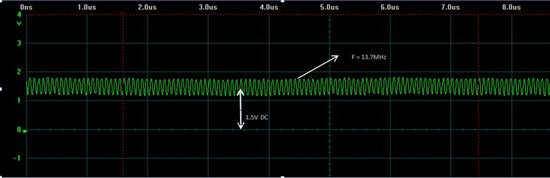

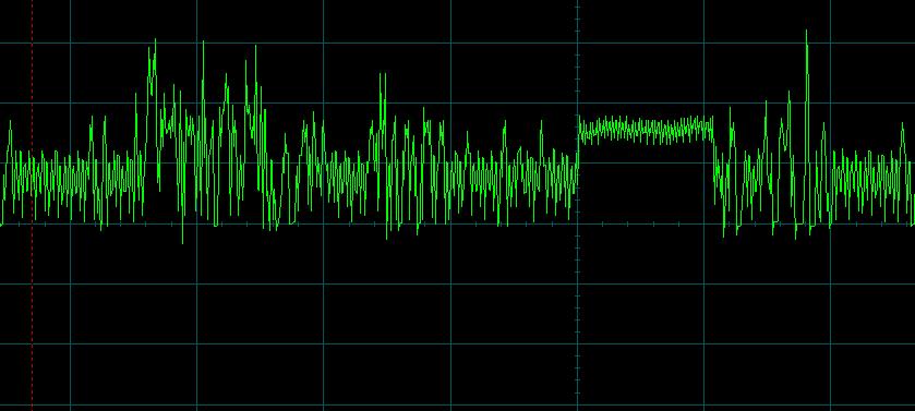

Hi it is strange there is 13.5MHz added. How does the waveform look like ?
You can also set 3.21.1 Video Input Source Selection #1 Register [3] Black output
TVP5150AM1 will be forced to output black only. Check if the 13.5MHz go away...
BR,
Eason
Does your video compressor chip captured the blackscreen when black out is enabled?
If so, then I doubt there is something wrong w/ the video source...
