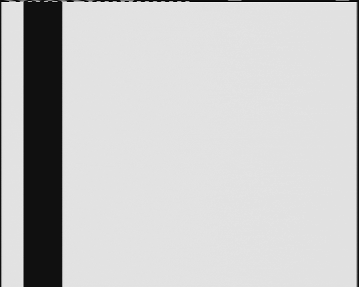

In one of our designs we are using the TVP5147M1 devices to convert PAL video to 20-bit 4:2:2 YCrCb video. We are displaying the video but we see two black vertical bars, one in the right size and the other in the left size, as shown in the following picture. The image size is 720x576
We have set the following configuration in TVP5147M1 device:

Could you please help to us to solve the problem about the black bars?

  • Hi ,
    Could you check the width of video input?  I think it is a cropped D1 formant, which is 704 perline.
    If so, you can change  the AVID start/stop pixel and the capture side at back end.

    I`m going to update the situation. Yesterday I injected other source of analog video to TVP5147M1 device. My collages said to me that the resolution of this video is 720x576. With the same configuration that I sent to you yesterday I obtained the following image.
    As you can see, the two black vertical bars have been reduced respect with the other pattern but we still have four black pixels per line (two in the right size and other two in the left size).
    We have a requirement that the image size shall be 720x576 so I cannot to change de AVID stop/start configuration in order to change the size of the image.
    Do you know if I have any mistake in the configuration of the device?
    Alberto
  • Hi, as you can see , it depends on the video source.
    TVP5150 simply capture what it get from inputs.
    I suggest using the video trigger feature of occiliscope and compare the length of line between the 2 cameras.
