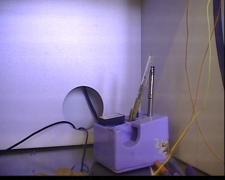

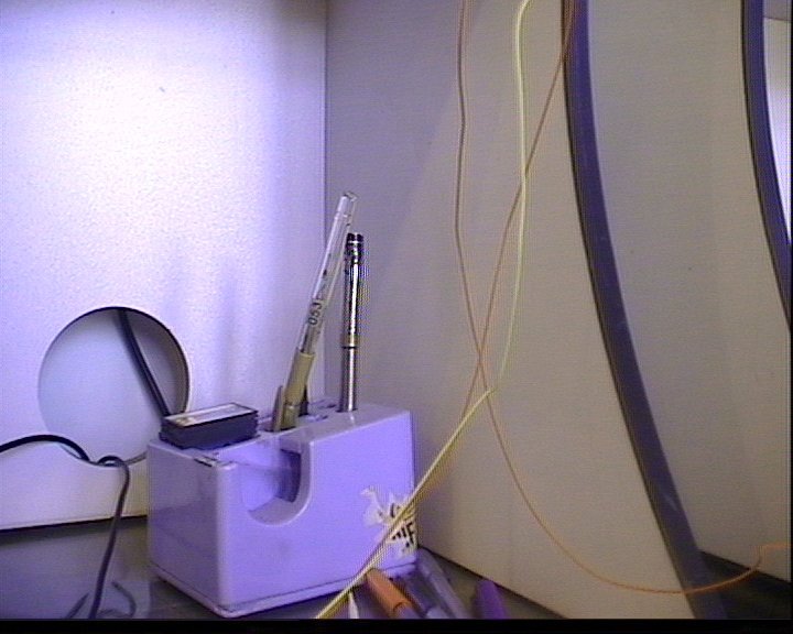

We have designed a custom board using TVP5151.
Video input is fed to TVP5151 and then to an FPGA.
There is a moving horizontal noise present on the video.

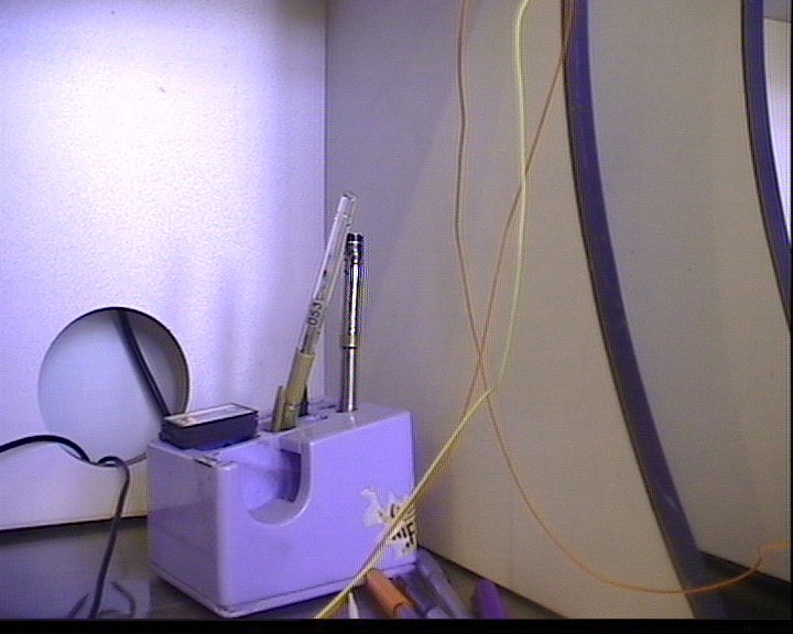

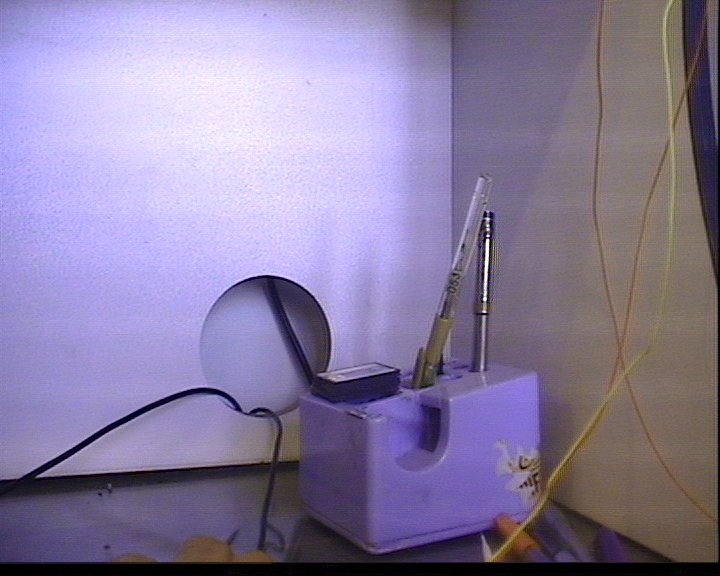

But the strange point is that as soon as I touch and release one of the pins of the 27MHz crystal with a pair of tweezers, the noise disappears and does not return!
What can be the reason? Any suggestions?
The noise can be seen below: (2 consecutive Frames)
It looks like the famous ground loop noise.
2 consecutive frames after touching the pin of the crystal:

    It is the so called barrel noise if I am not wrong.
    Any idea where the noise comes from?
    I have inspected the crystal and chosen the capacitors based on the CL of the crystal.
    I have also changed the crystal with a 1.8v Oscillator, but still this noise is there.
    It is getting a little on the nerves. I have already used TVP5146 and the quality was really good.
    Any idea will be appreciated!
