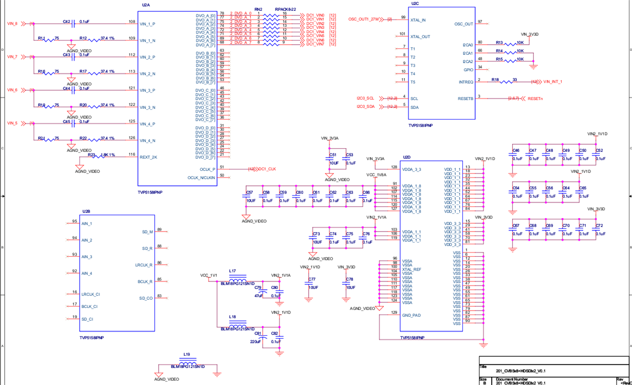

              Below is the schematic about tvp5158
  • Could you provide the frames captured?

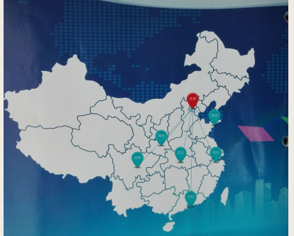

    below is the original image

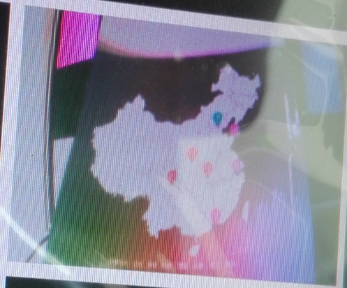

  • Below is the capture's image
    the link is capture->swMs->display
    I' m sorry that the image is not particularly clear, But we can found that the red color become blue
    and the blue color become red

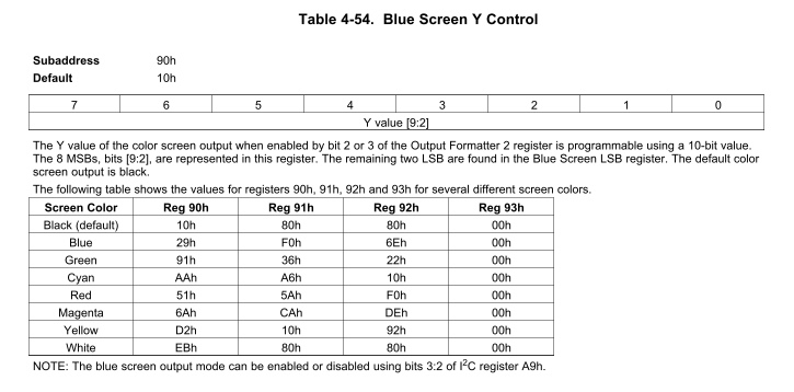

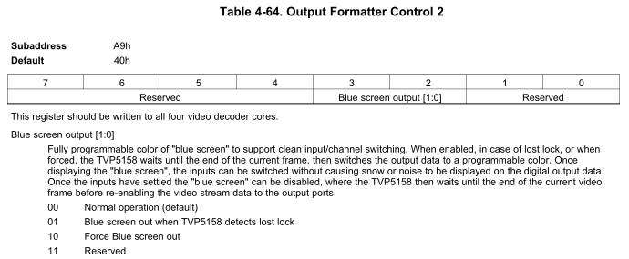

    Set the bluescreen register to let TVP output a pure color test pattern.
    The bluescreen color can be set as you wish.

             We have used the blue screen function to debug this problem.
             We using tvp5158 output the blue image,the red image,  the Magenta image.
             The TI8168 can capture the image successfully.
             So I think the tvp5158's output is OK. But We don't know what causes color cast.
              We set the 0xA9 = (0x02 << 2);and output a pure color test pattern including red, blue, green.
              The ti8168 can capture the pure image successfully and the ti8168 display color normal

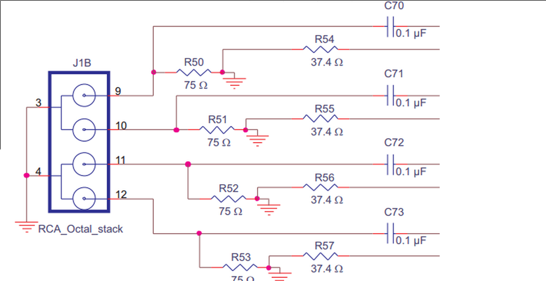

  • Dear Eason
                 We have some query  about the hardware
                 1 What is the requirements for power supply ?  for example the 3.3V and 1.1V ripple voltage requirements whether it  effect on the image quality.
                 2 As shown below, We should place R50, R51, R52 and R53 close to J1
                    And place R54, R55, R56 and R57 close to J1, While in my schematic this Resistances is close to the tvp5158 chip whether it effect on the image quality

  • Dear Eason:
                        We found a phenomenon that the captured image superimposed a color bar.
                        Sometimes it will disappear but sometimes it is very clear.
  • What do you mean about superimposed a color bar?
    TVP5158 doesnt have built-in colorbar generation mechanism so the colorbar should come from video input.
    Could you provide a picture that can show me the issue?
    And, as I mentioned before, please use other video input and standard TV signal generator to make sure this issue is related to video source or not.
    Eason
