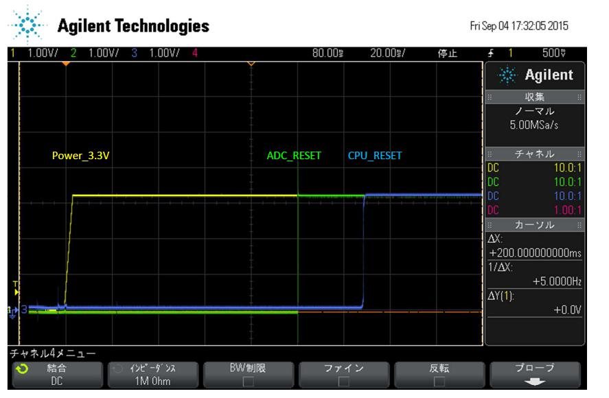

My customer is evaluating the TVP7002.
It is happened that the missing color when power supply starts up on TVP7002 circuit.
The occurrence frequency is 40-50%.
The monitor is following.
They have confirmed that ADC_SETUP_DATA is same with ADC_Read_DATA and the reset sequence has no problem.
And when input signal is only Y the missing color is not happened.
So they guess that the reason is the timing error of Y/Pb/Pr.
Could you please tell me how to solve this problem?
