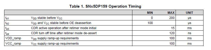

my customer has question regarding to SN75DP159 operation timing at data sheet page 25, figure 22 power up timing, they want to know whether the VCC rising time can be first, then VDD is second that follow by VCC? If the answer is yes, then the page 26, table 1 shown the td1 timing is VDD stable before VCC at min: 0us ~ 200us. These two conditions are confused. Please help to clarify. Thanks.
