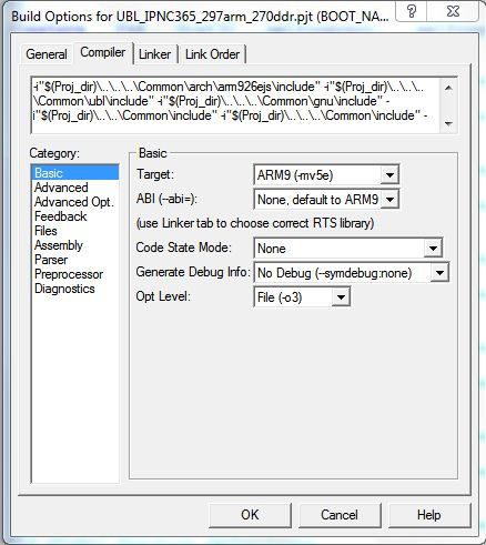

Here are the build options which I have used:-

    The option --retain only works for EABI builds.  But you use the option --abi=ti_arm9_abi.  And you use the RTS library rtsv4_T_le_eabi.lib.  At least one of these is wrong, but I don't know which one.

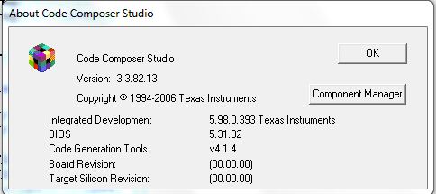

  • The inconsistency is due to obsolete version of code generation tools linked to my system. I have installed TMS470 code generation tools 4.5.0. Yet the CCS v3.3 continues to use v4.1.4. (See image)
    I want to upgrade to 4.5.0.But i am unable to do so. The installation of Code gen tools seems to go fine..But the linking with the CCS v3.3 is not happening. What to do?

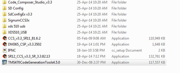

    I anyways have setup of code gen tools:- \
    which I install.Though the installation goes fine...there's some linking with the CCS v3.3 that I am missing.
