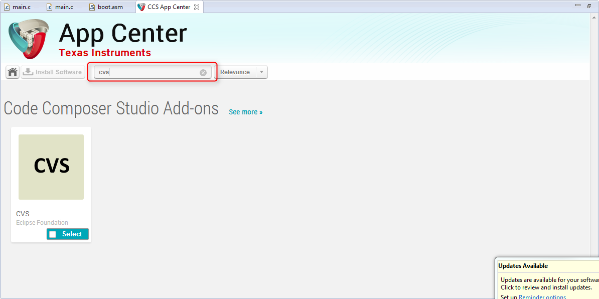

  • Randy,
    I am an idiot. CVS support is available in the CCS App center (I lost count of how many times I saw that icon but just did not compute).
    Just go to CCS App Center (menu View --> CCS App center) and then search for CVS at the top bar.
    Sorry and hope this helps,
    Rafael
  • Rafael,
    That works!  I am connected & using the repository.  I would not have thought of the App Center.
    Again, I appreciate your help,
    Randy
