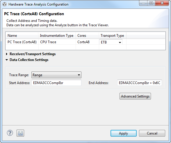

    Sorry, but Ki is out in vacation and I am unsure if he already has fully characterized this issue. I was only able to take a look at it today and, just like him, I can't seem to make any sense out of the problem. In my case, though, I randomly stop at breakpoints at that specific function irrespective of the line where it is set and the breakpoint type (hardware or software).
    Just to confirm if the function call was being executed more than once, I set a small ETB trace job starting and stopping at the function addresses, and I can verify it is accessed multiple times, which confirms the expected behavior.
    Just FYI, I set the PC Trace job (menu Tools --> Hardware Trace Analyzer --> PC Trace) as below:
    Ki is back next week and I will be able to sync up with him.
    I apologize for the inconvenience,
    Rafael
