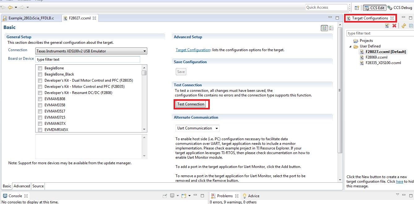

Just recently started using code composer studio v6.01 and I've noticed that there is no DSK diagnostics software,I've been using v3.1 for a TMS320C6416 and before typing any code I had to test if the kit is properly connect by doing a USB diagnostic check,which is absent in CCS v6,is this normal or do I need to download it separately..

    In CCSv6 you've something called as "Test Connection" in the Target Configuration Window. This will perform a JTAG integrity test.
