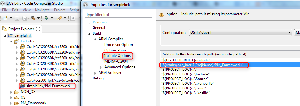

I would like to ask what is the purple icon means in the "Project Explorer" of CCS:
I checked that this may refer to a folder, is it a folder contain the header files?

Anything that shows up under the "Includes" node is a folder that will be searched when looking for header files. As to why that one is purple (and shows a name instead of the path) I don't know. I suspect that it is setup as a variable (i.e. relative to the project or workspace location). Where did the project come from? I can likely figure out what is special about it by looking at now the path is specified.
The include search path is specified in the project properties. If you take a look at that I suspect that the way that path is specified is different. For example in CCSv6 when I specify a path as relative to a project in my workspace the icon looks different.
