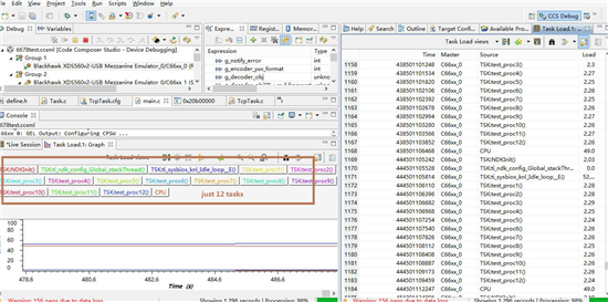

CCS5.5 can't display more than 12 tasks cpuload
hello:
I am using ccs5.5, in my project I have more than 20 tasks, when I profile these task cpuload, some can't display,so
I create a test project which just creates 20 simple tasks with different names, and then it also can't display all the
tasks cpuload,but in the live sesson, it logs all task's log. How can I make the ccs to display all the 20 tasks cpuload.
Here is the picture:
